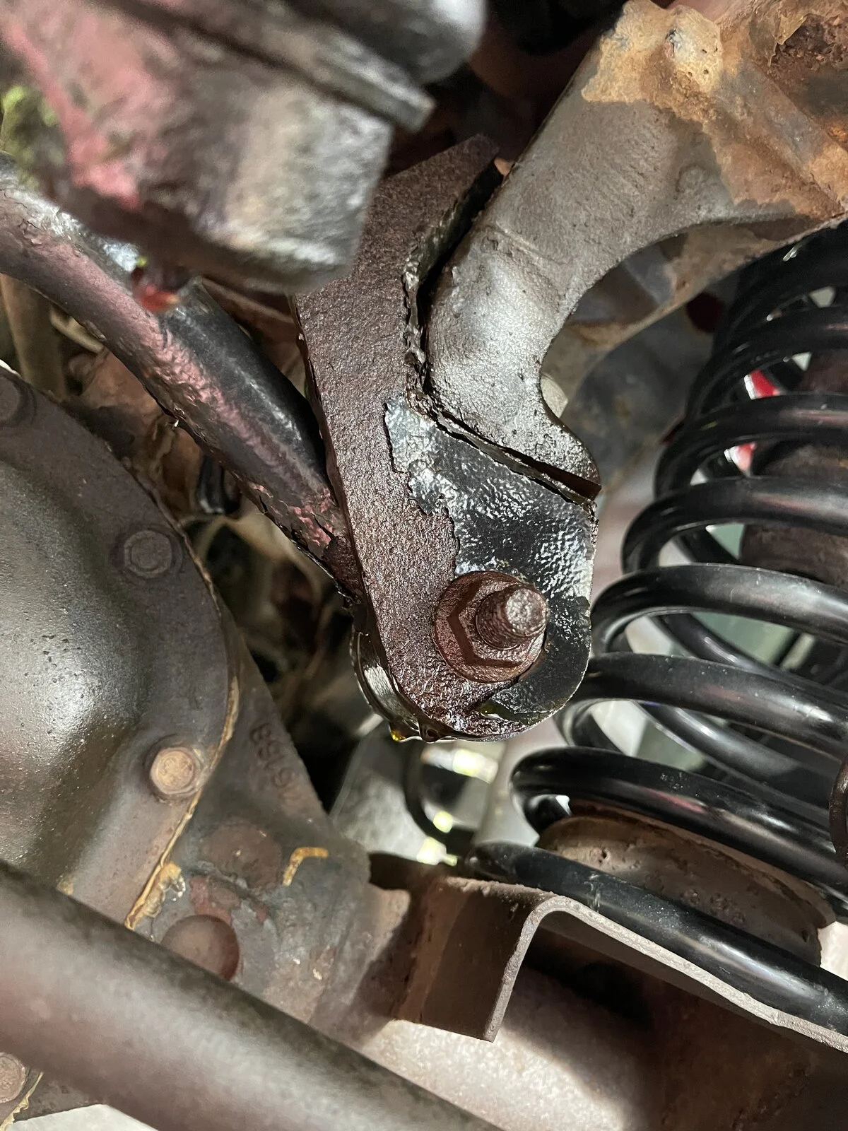

I talked to the former owner and he said it’s a rough country adjustable CA. I’m not a fan of their products but apparently some people here say the track bars are decent, but with crappy bushings which can be replaced with Moog or similar. Something else I noticed, is this thing installed backwards? :ROFLMAO: The frame side wouldn’t have bolted up without that weird bracket otherwise
Frame side:
Axle side:
On the frame side the PO added a drop mount. He may also have added a dropped pitman arm. None of that is necessary. Get rid of it all. On the axle side it looks like he drilled another hole to center the axle with the stock TB, then later got the adjustable RC TB.
How can I remove the bracket and install the track bar back to the frame side? The bracket is a horizontal orientation and the oem mount is vertical. That’s why I’m wondering if it’s installed backwards
You'll need a different track bar

Yep you’re right. Just found this. It’s a different style apparently that requires the bracket to install. Weird. I’ll just go back to stock and utilize that drilled hole.

If the PO drilled out the frame side mount to add the aftermarket bracket, you will not be able to use the stock track bar. The stock frame side mount had a tapered hole for the tie rod end on the stock track bar to fit. You could weld a new tapered sleeve into the hole, but most likely you’ll be better off with an aftermarket adjustable track bar that uses a different joint for the driver side.
The install instructions don’t require drilling the original frame side hole so that should be fine. It requires drilling only for the top portion of the bracket.
If it steered and drove with no quirks before the bushing went bad, I would just replace the $20 bushing.
That’s the problem I’m having, finding the correct bushing. Also, I’m wary about keeping that drop bracket as I went from a 3” lift to a 2” lift
Is the company that built the track bar still in business? If so they should be able to sell you a replacement or give you a part number for the bushing. They probably use a common bushing and not a special bushing.
Yeah it’s rough country. I emailed them. Hopefully I’ll hear back
