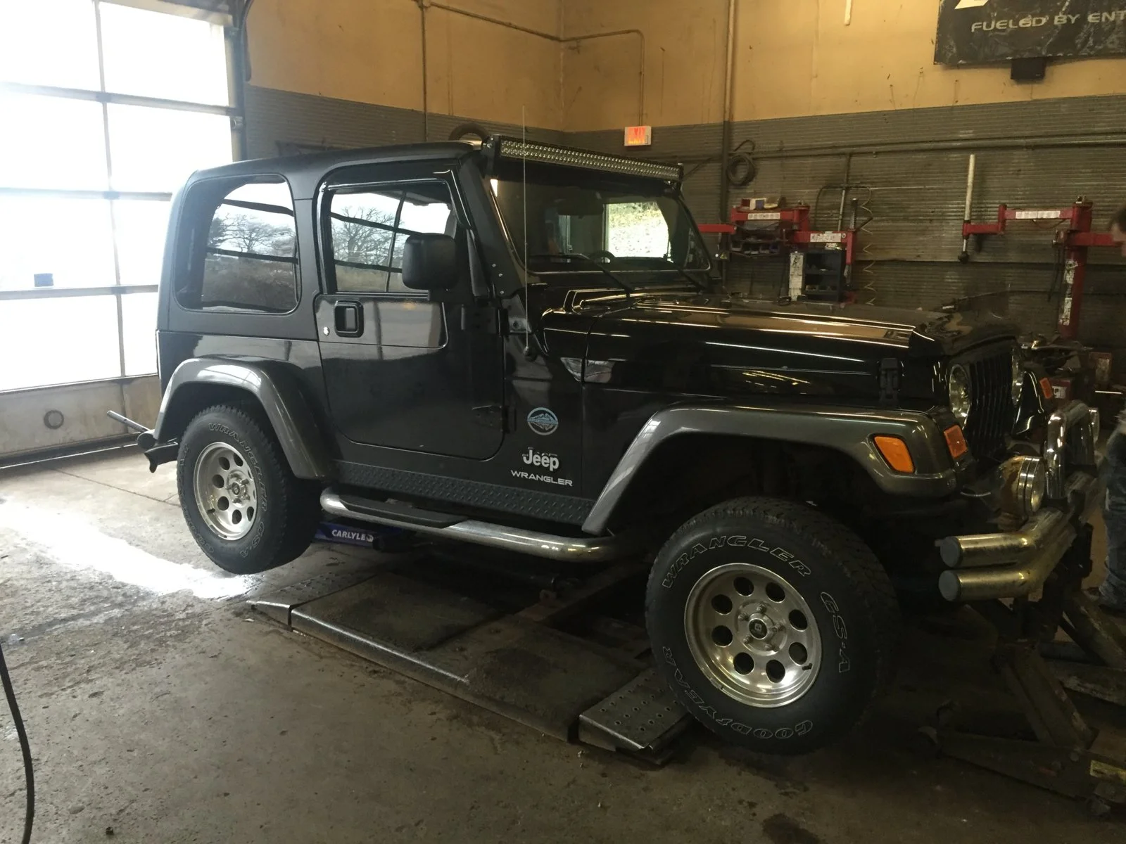

This is it in stock form (with the tubular bumpers).

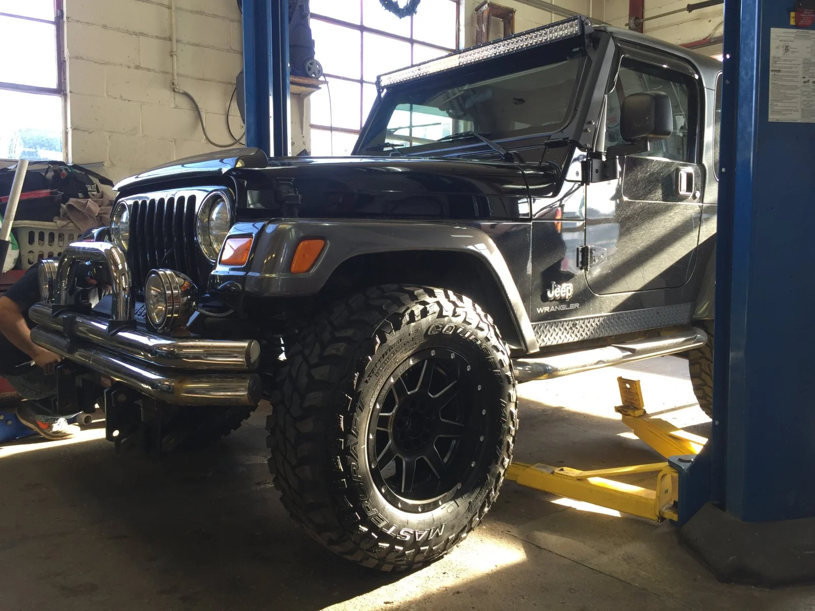

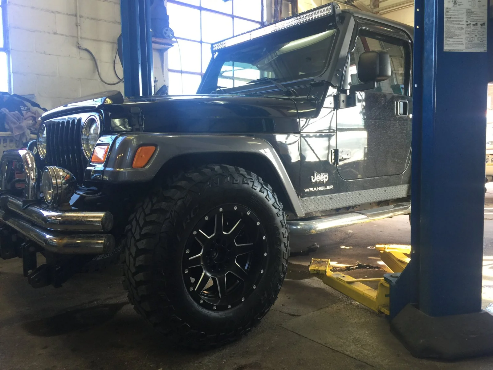

Outside the tire shop with the 33's :)

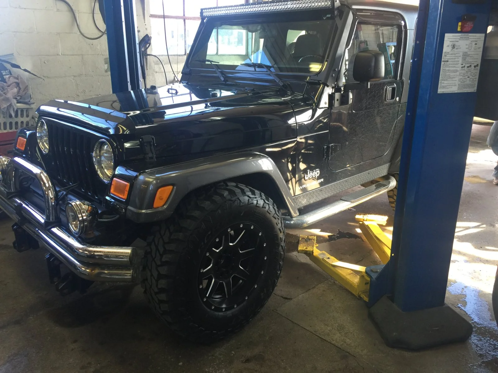

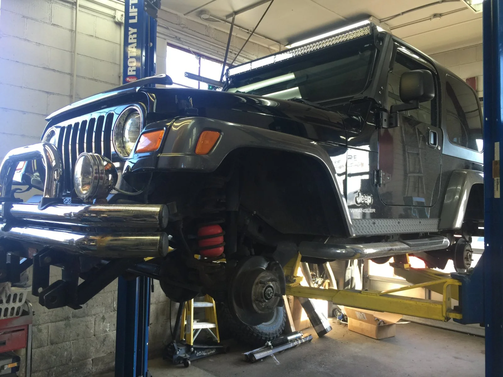

Getting ready for the lift

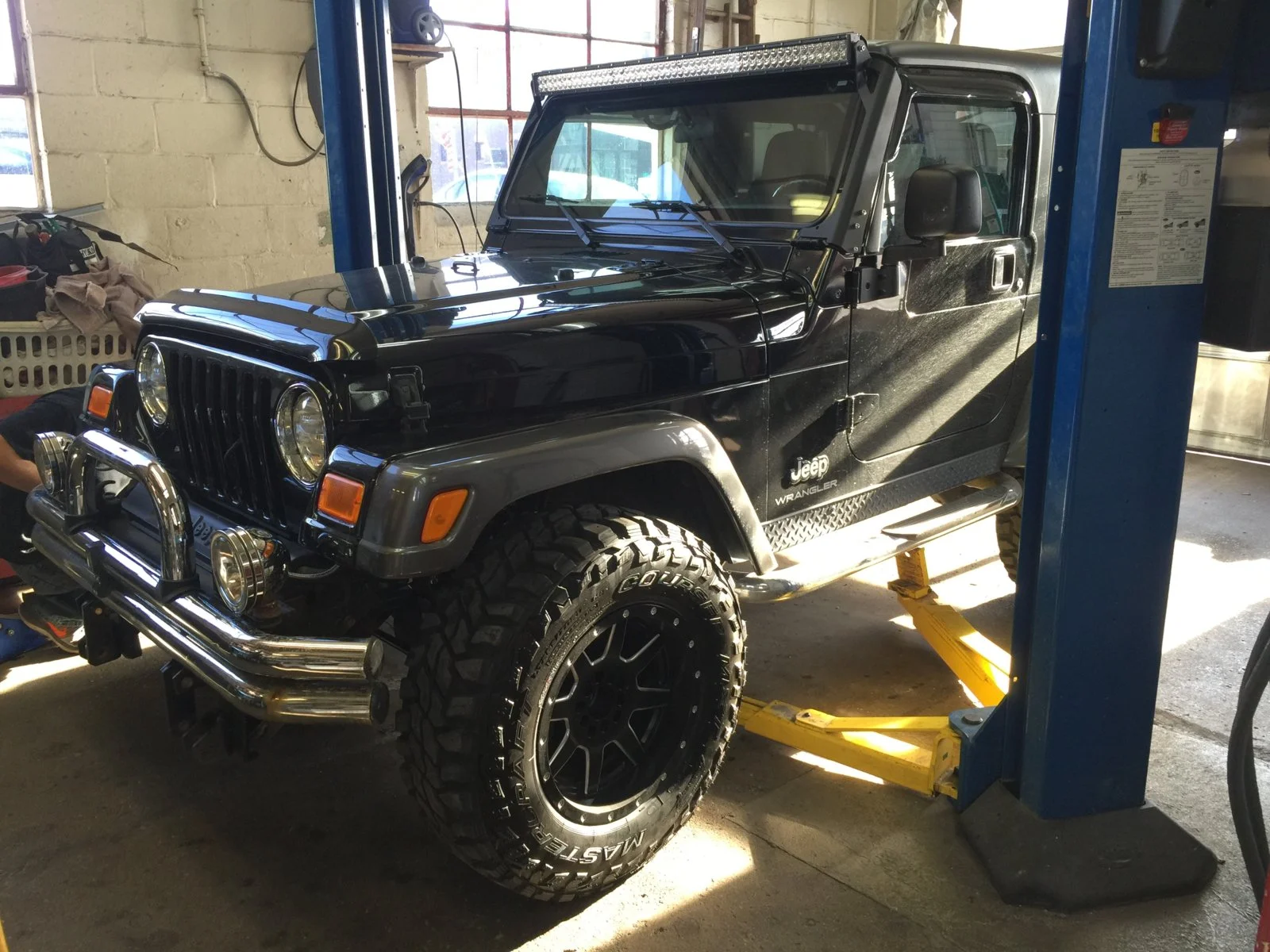

Stock shocks with Mopar air bags

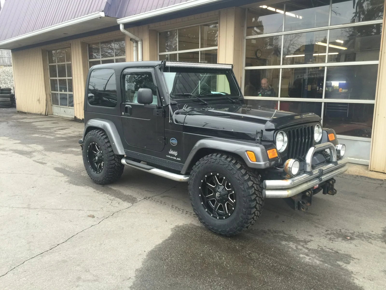

OME 2.5" Lift & Black Magic Brake/Centric Rotors on all 4 corners

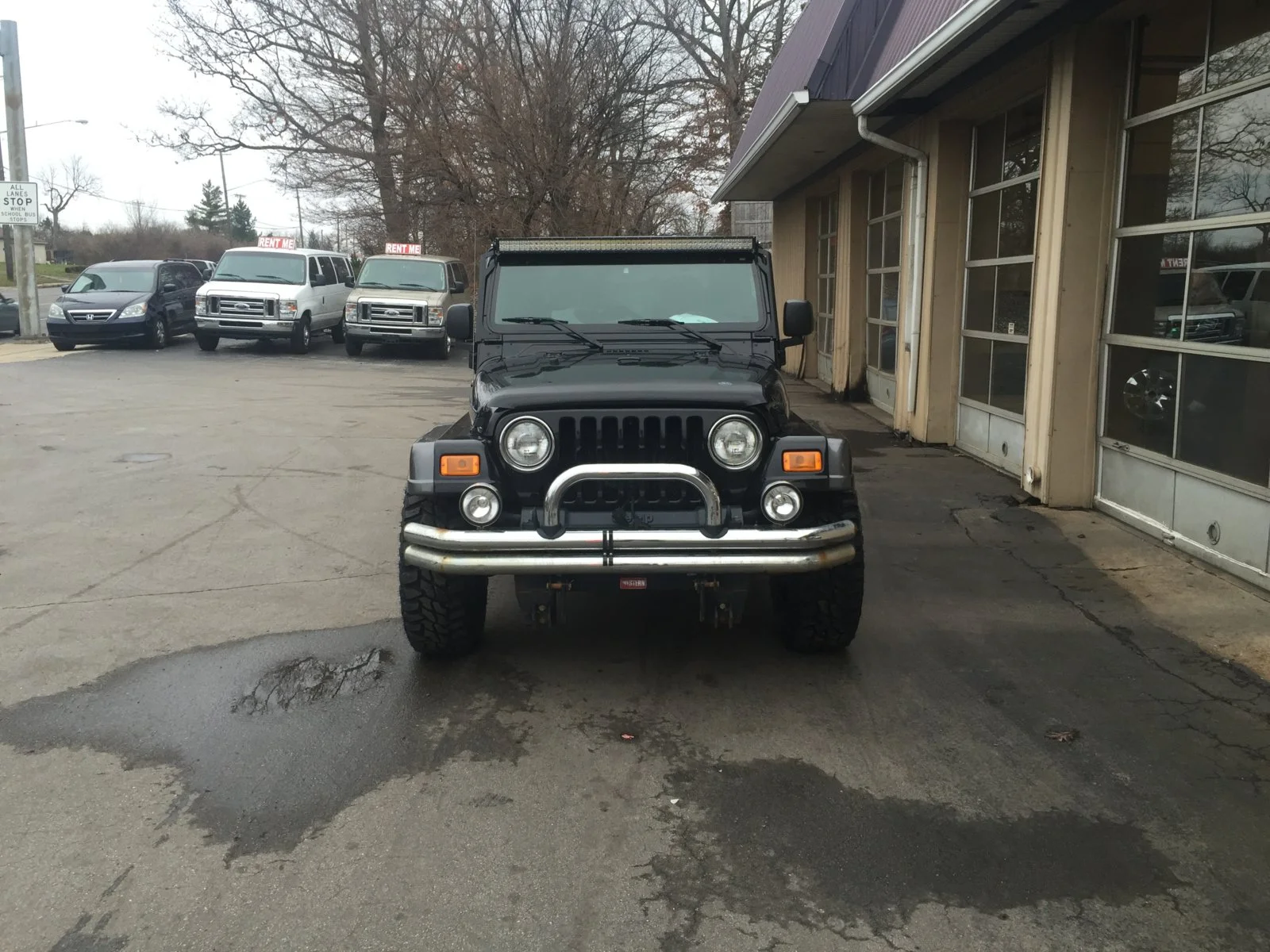

Now just need to get better pics in the wild :)
If I can have it my way, I'll probably buy a Rugged Ridge XHD bumper for the JK (I know, different mounting points) and I'll modify it to fit on the TJ. Reason for this is I LOVE the XHD with stubby ends, but they only produce this for the JK's.

Throw a 1" body lift on there (cheap and easy) and you'll be good to go lift wise.
Man... Without the lift those tires just barely fit!
Black Magic Brakes were a night/day difference. AMAZING!
A couple times into my drive I heard the "thud, thud, thud, thud" of the tires hitting fenders, lol.
I'll bet, those tires are quite large for the stock height!

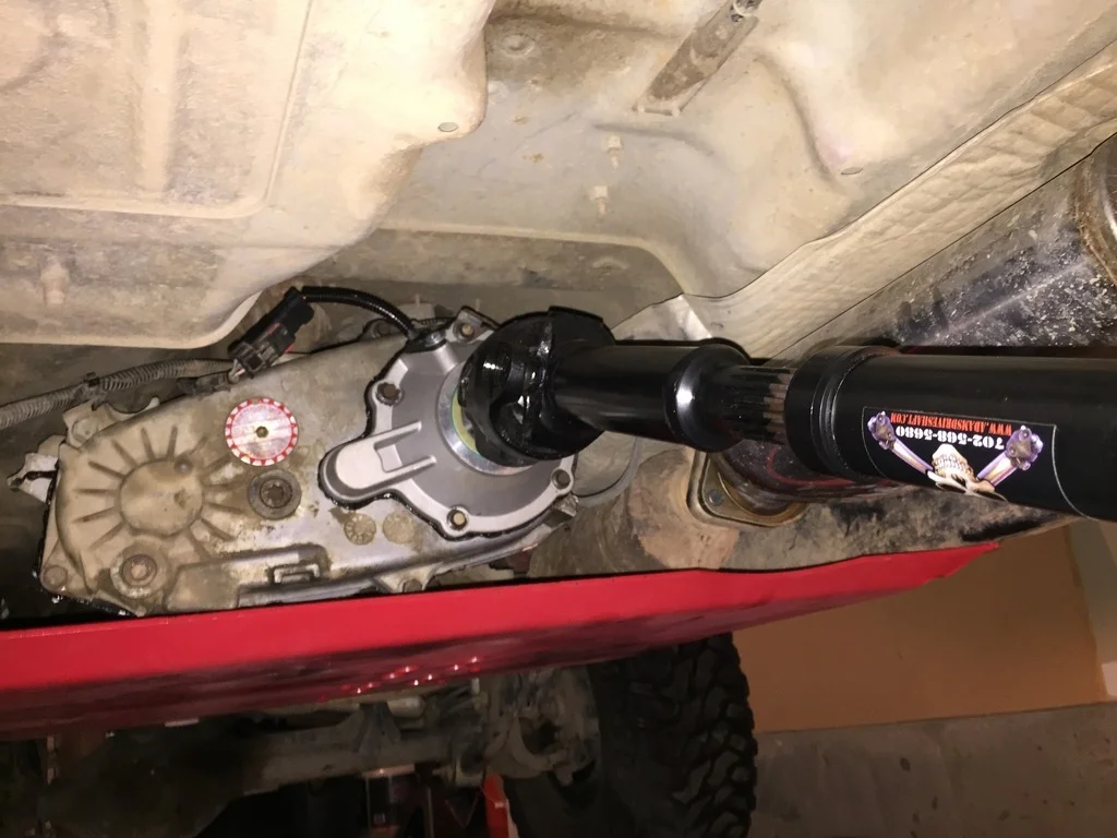

Be prepared to spend money for the tummy tuck... Ask me how I know.
What brand do you have? I run the UCF TT
I'm running the UCF UHC tummy tuck, along with 1" BL, 1" Brown Dog Motor Mounts, Novak cable shifter, and TeraFlex Extra Short Shaft SYE with Adams Driveshaft.
I thought about getting the UHC did you have to pound out the trans tunnel?
No adjustments to the tunnel, exhaust, or anything. But as I mentioned above, I already had the 1" body lift and Novak cable, so that allowed everything to stuff nicely. I have an 01 TJ, 4-cylinder with auto trans. The later model TJs stock belly hangs down lower than my stock configuration, so results may vary...

Wow, that looks nice and tucked!
