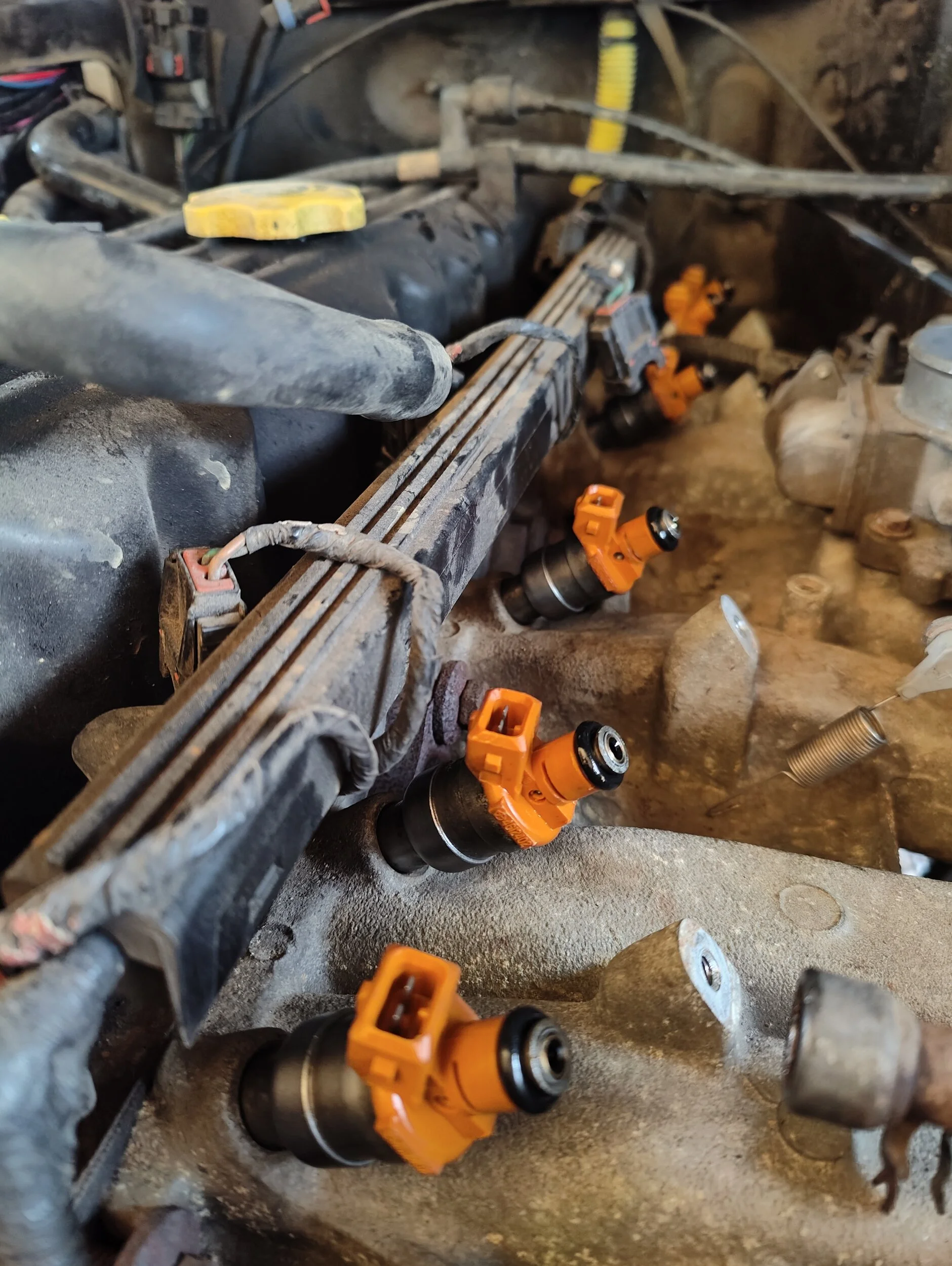

I have a ton of questions, but the one immediately in front of me is I am going to replace my fuel injectors and fuel rail. My Jeep has 153K miles on it, and four of the five injectors are original. The fuel rail is crusty. The #1 injector was replaced by the PO and it looks like they went really cheap with the replacement. Having said that, I have heard of challenges related to extracting old injectors from the intake manifold and them being stuck. Any advice on how to make this go smoother? Pre-spraying with solvent etc? I'm not too concerned about the old ones as they are getting tossed.

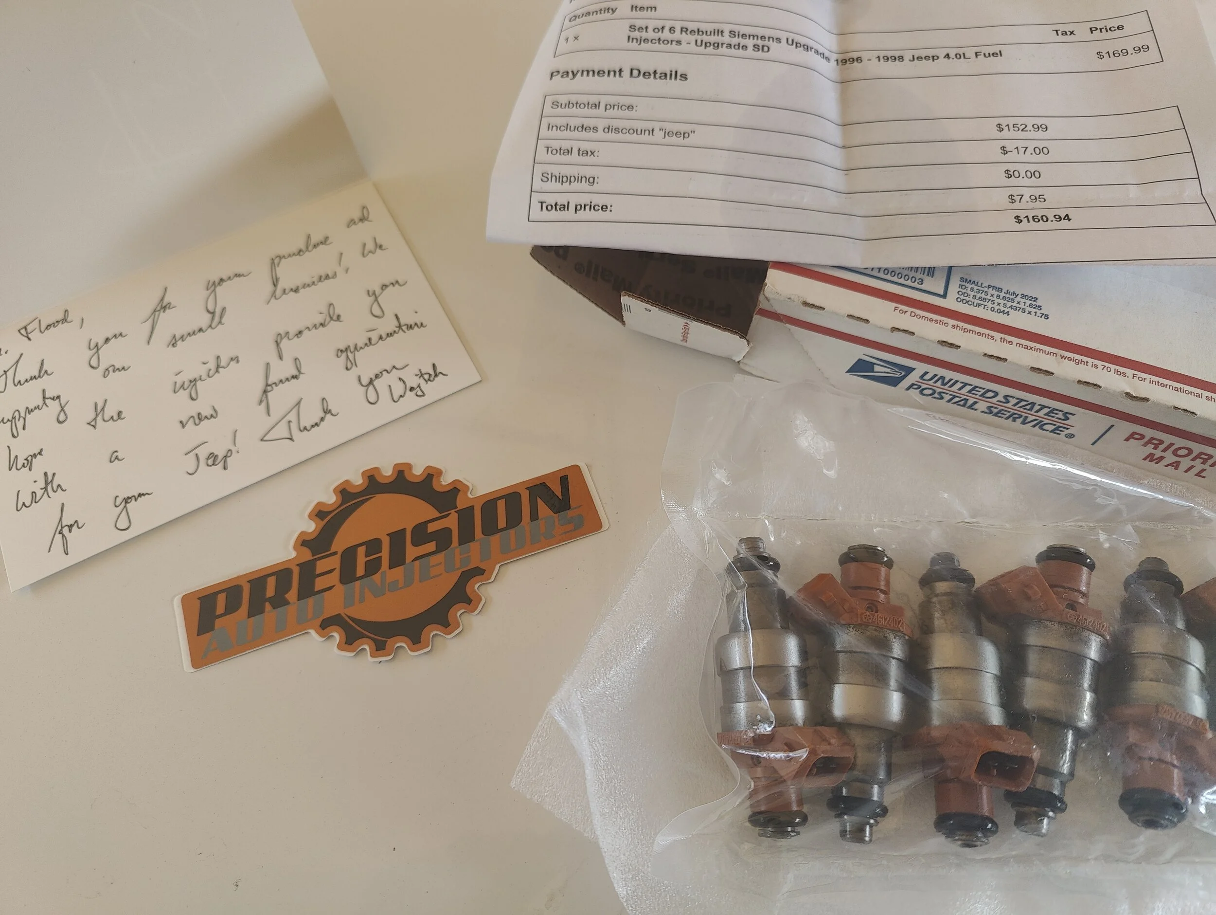

I went with Precision Auto Injector and got a rebuilt factory Siemens set for my 97 balanced and everything.
Prompt good service.
-Mac
-Mac
Thank you for confirming! Based on what I read here, that was where I purchased my injectors. Did you have any challenges trying to pull your old ones?

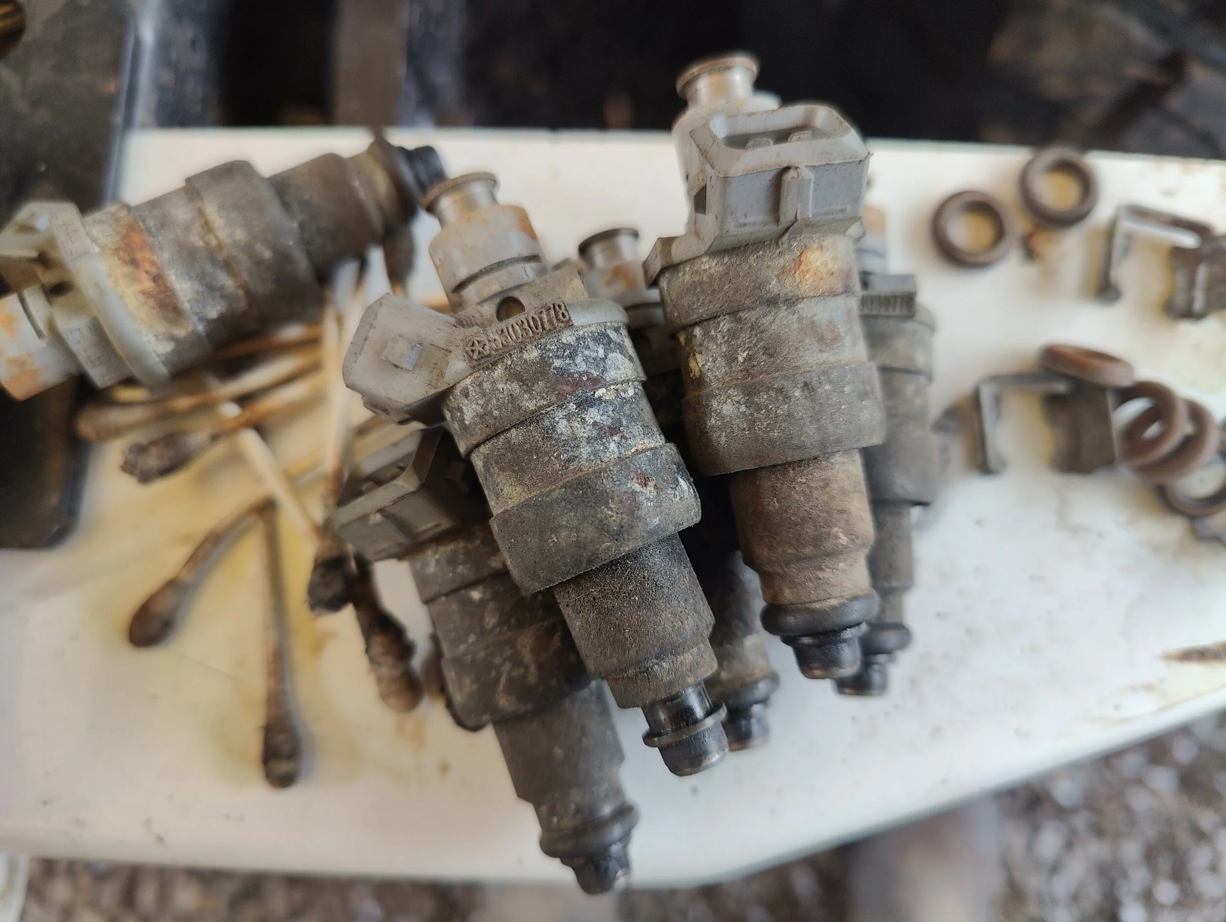

Nope...they came right out. Always check and make sure you don't leave an o-ring in the rail.
Consider a DEI heat shield for the rail.
I scuffed my rail up and painted it black.
Dab of dielectric grease and they slid right back in.
-Mac
