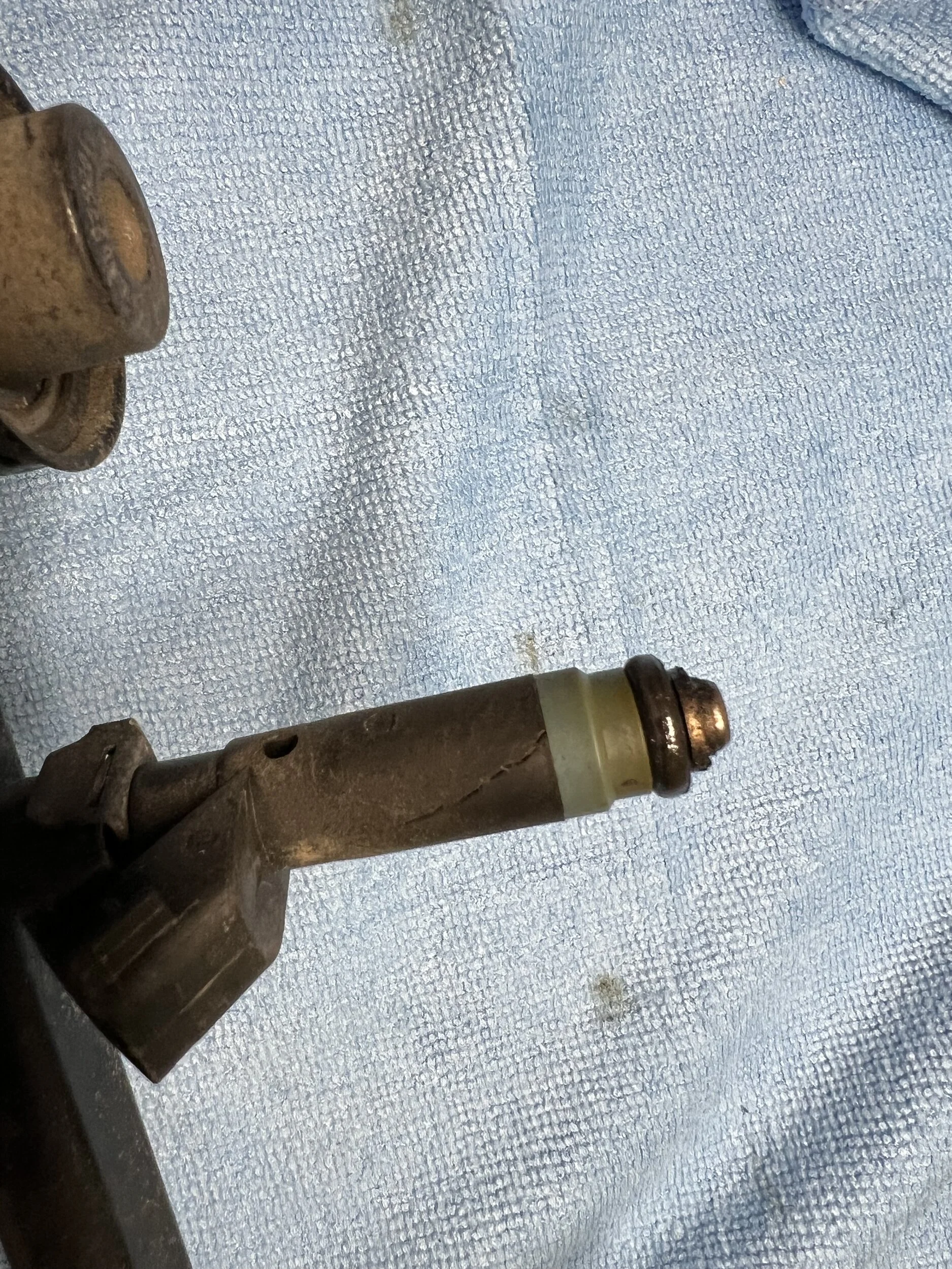

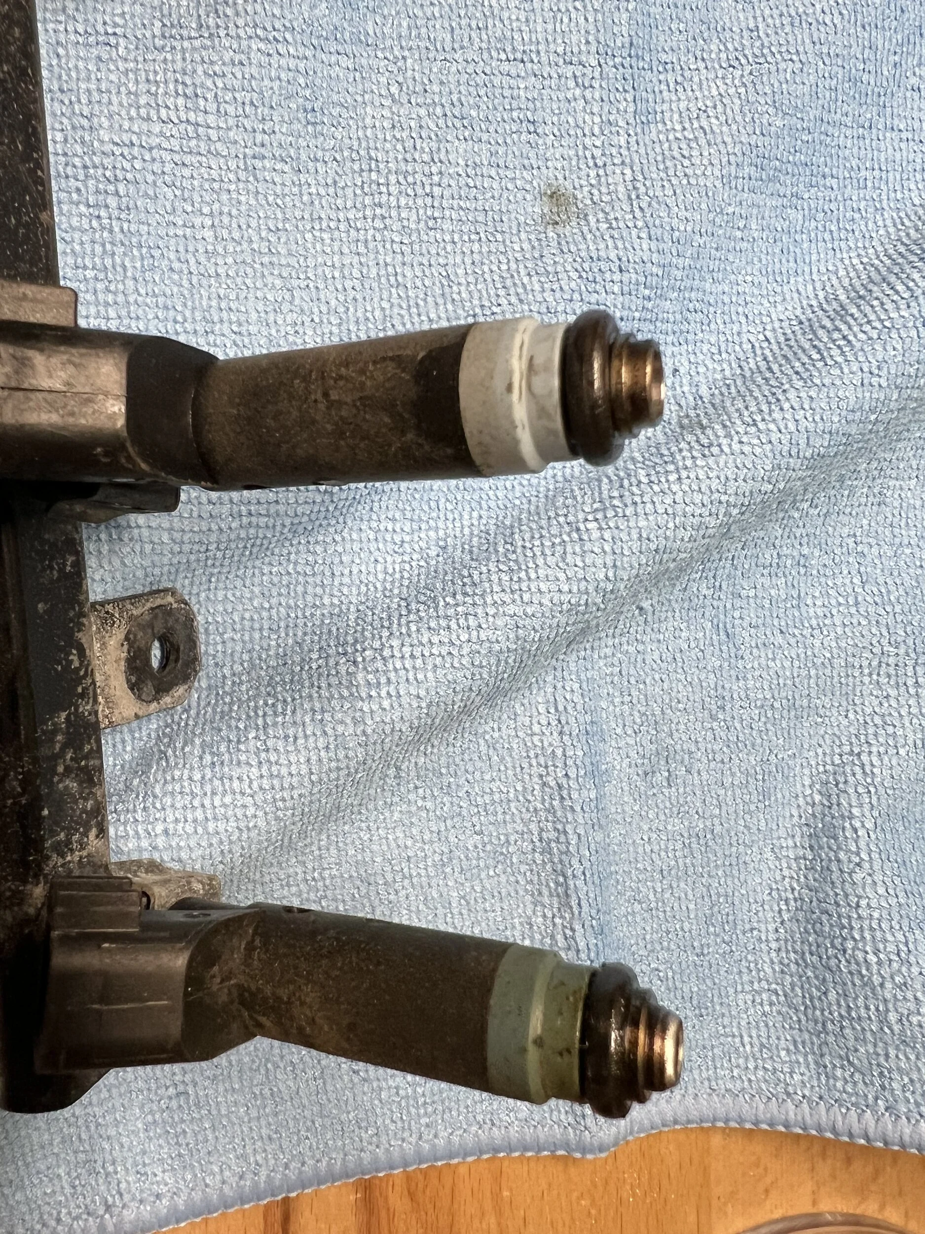

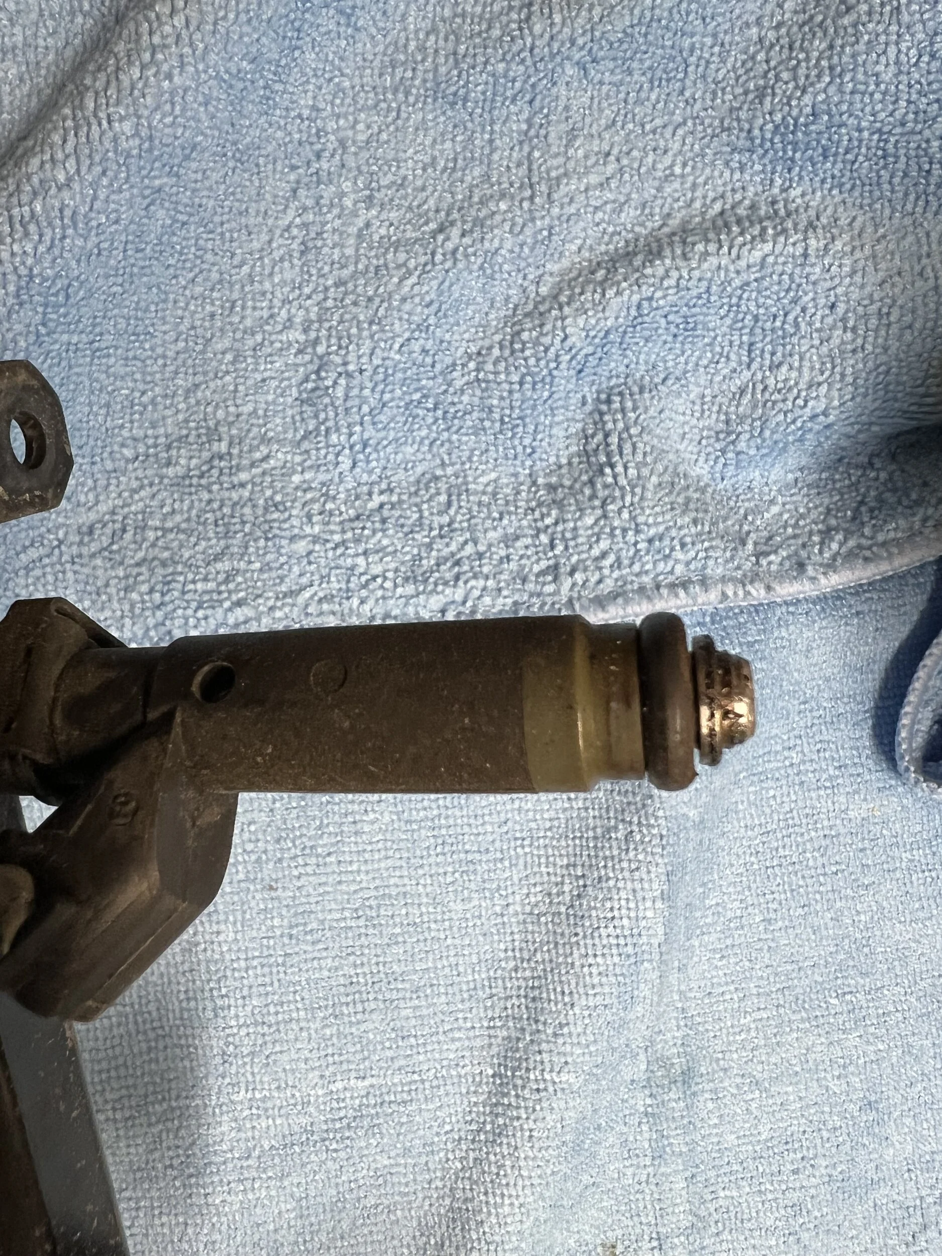

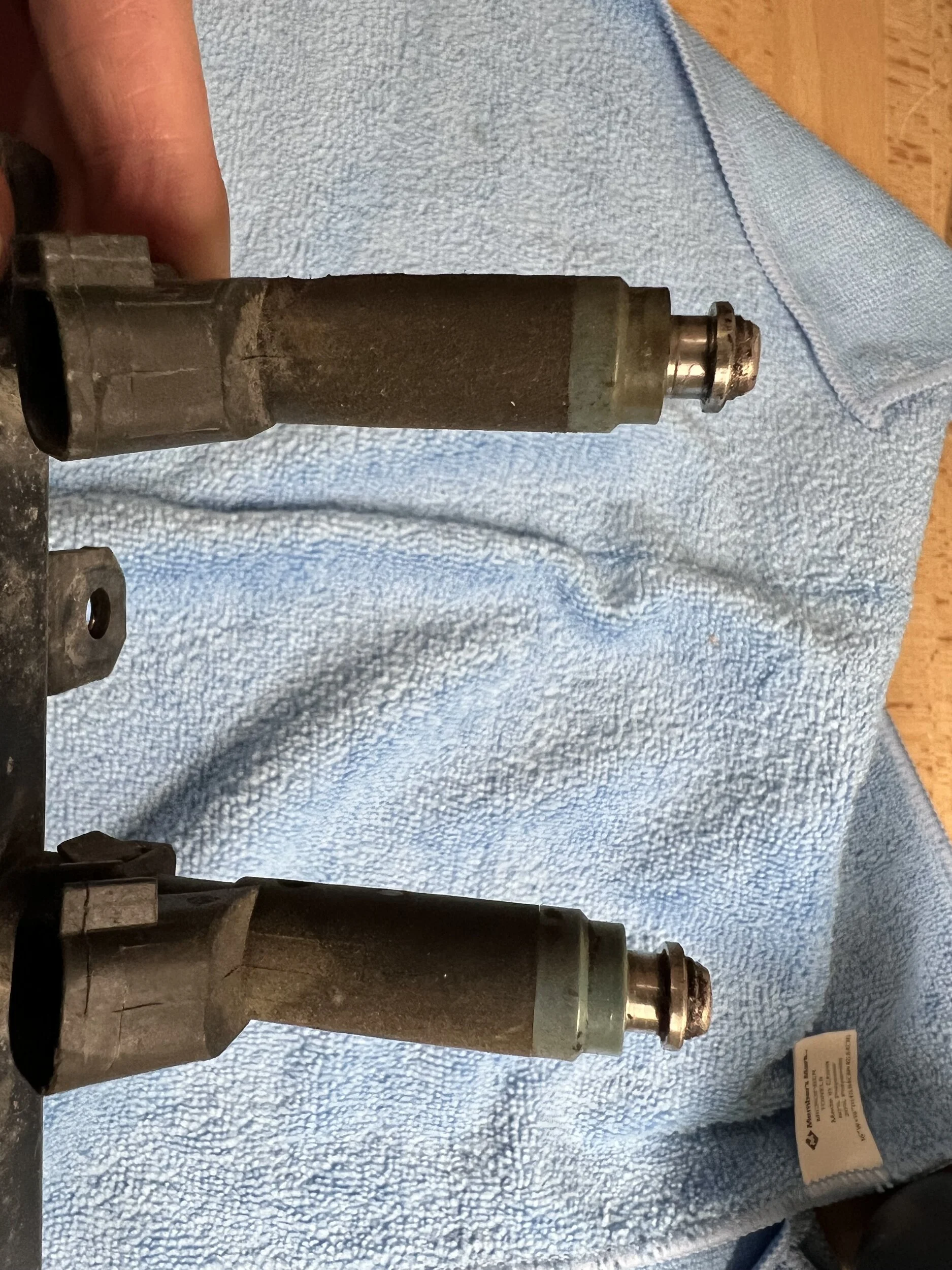

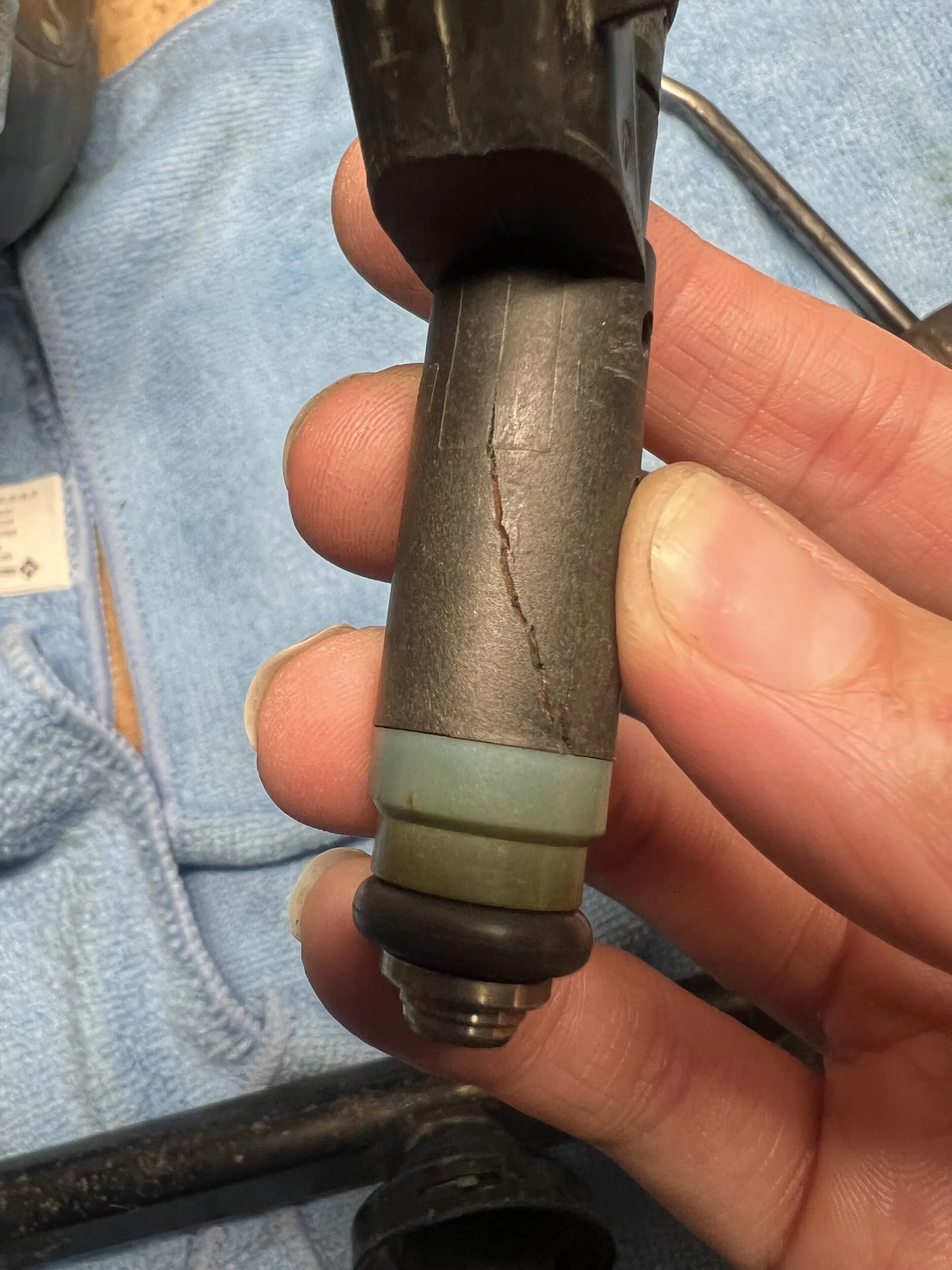

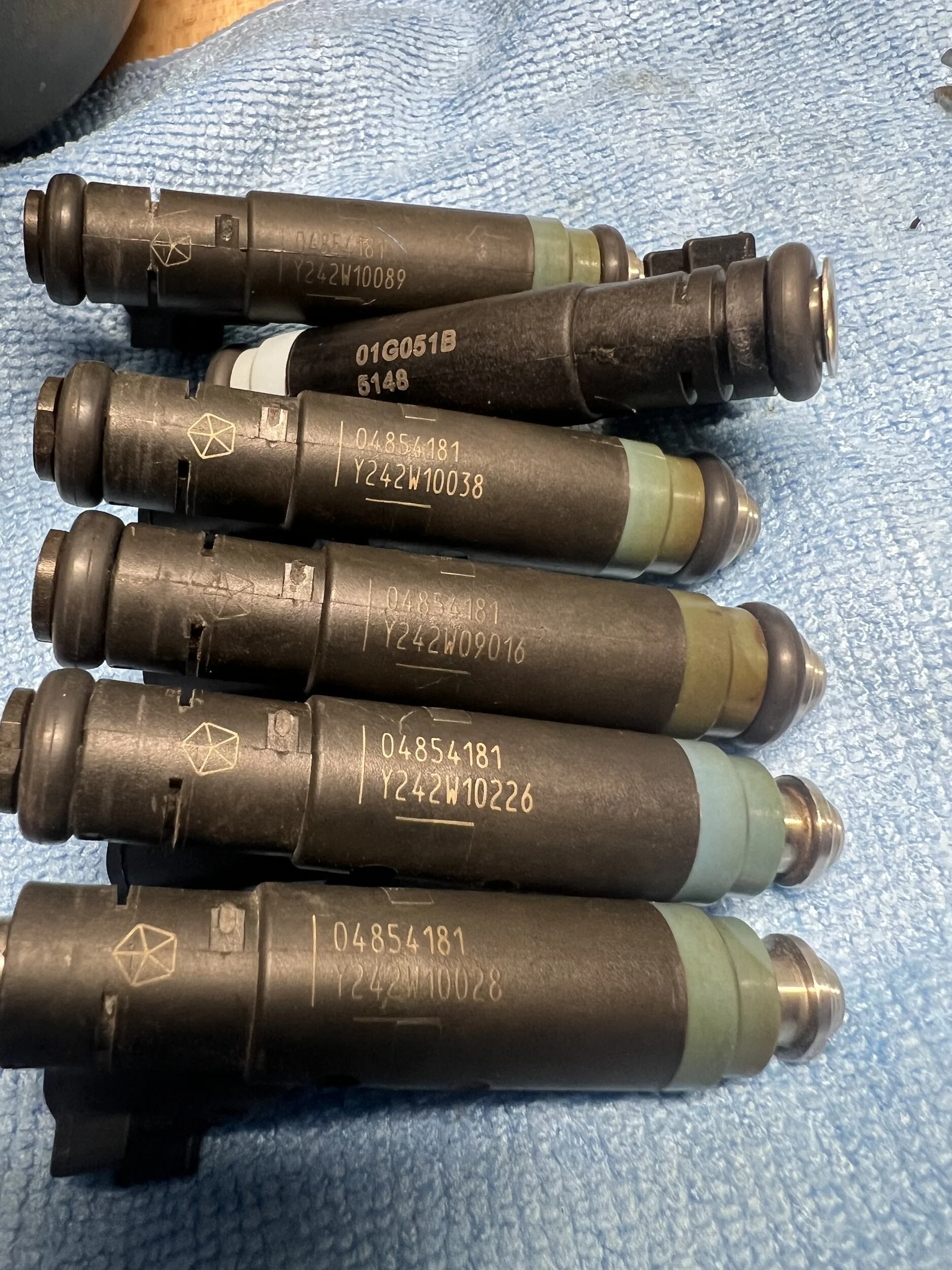

Ok so I am chasing a possible misfire/long crank situation. And I haven’t seen the condition of the fuel injectors. So took them out and need your wise minds to tell me what’s going on here.
Obviously they’re dirty. Not OEM. Some cracks. Some looks burnt/discolored. What causes that? Is that indicative of a problem?
If I need to replace them, since they don’t make OEM anymore, what should I be using?
I already changed the spark plugs. They were due. I tested the injectors with noise and they passed. I tested with a voltmeter and they had the same ohms.
They have definitely seen better days.
Have you observed any names or numbers on them ?
The factory PN is 53030778, but I am sure that part number has been superseded.

I just swapped an injector placement because I had a misfire code come up and I feel like it’s running rougher while idling and driving.
So I want the rebuilt injectors? I thought I had read that there was no point in the 4 hole injectors.
Now my codes are
P0201, p0204, p0158, p0456
I moved the badly cracked injector to 1 so that makes sense to me. Checking my connectors. And I still haven’t changed my O2 sensor it’s on the way.
