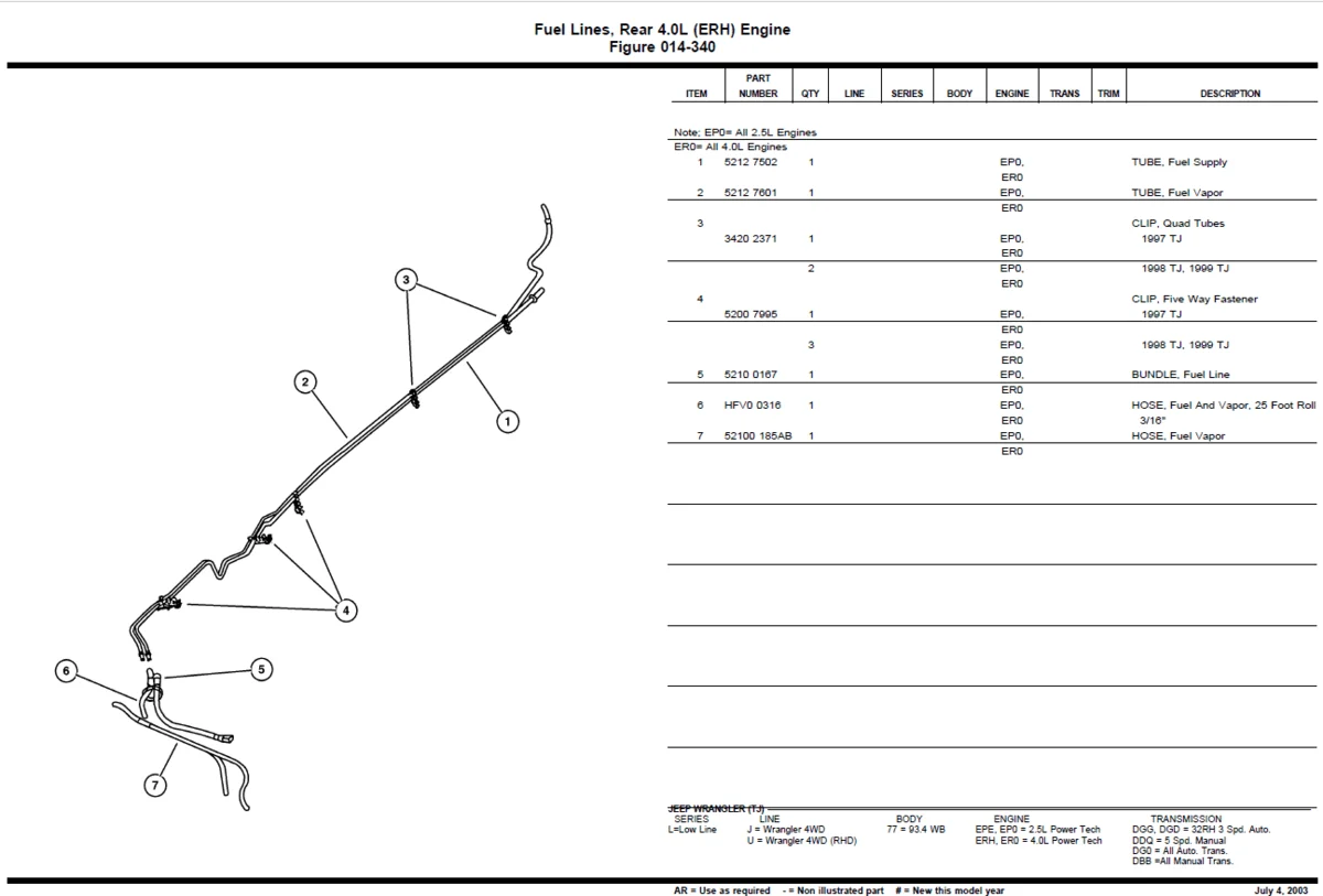

both of those part number are still available 52127502 and 52127601
Nice..both for under $100.. but i dont see the connector piece that connects to the fuel rail. is that a separate part?

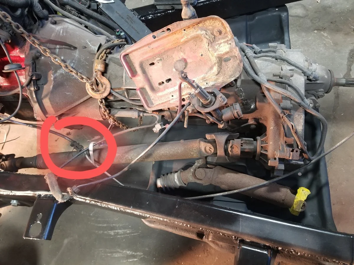

On the attached image i can see that small fitting between the line from rail and the line from the pump.. what i need is the piece from rail down to the fitting circled in red on this pic..

Sorry it's taken so long to reply. Yes there are three fuel line sections in total from the tank to the rail. The fuel line from the rail to the frame shown in your pic is the one I cannot find for the 6 cyl (the 4 cyl line is still available but it's too short to reach the 6cyl fuel injector rail). I have not found any aftermarket premade lines for the engine bay so you may have to go to a race shop and have them fabricate a high pressure line with the appropriate quick disconnects.
