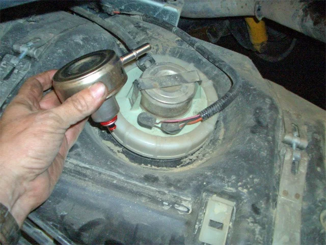

2004 four cyl having the same problem. Been to dealer three times they do not believe me because they cannot duplicate the problem. They insist there should be a code, I told them only time you get a code thrown is when the engine is running, you can read the code engine off but they argued that point as well.
They have not charged $ but annoying to drop it off and rent a car. I have a new back flow check valve.
2002 four cyl having the same problem. Been to dealer three times they do not believe me because they cannot duplicate the problem. They insist there should be a code, I told them only time you get a code is when the engine is running, they argued that point as well.
You installed a new back flow check valve? How did you do that and where did you install it?
have not installed it yet. It sits on top of the fuel pump in the tank looking at the pictures.
drive up on blocks, drop the tank and replace the check valve.
That is not the check valve, it's the fuel pressure regulator which only limits the upper-end of fuel pressure... as in if the fuel pressure gets above 49 psi it will dump the excess pressure/fuel back down into the gas tank. Also contained inside is the primary fuel filter.
