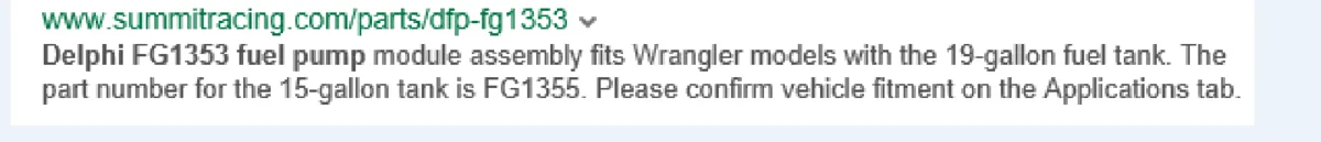

My 97 TJ Sport with 4.0 needs a fuel pump. Gathering parts and info to be ready for a warmer spell.
I do have a Bosch 69313 kit coming which I may or may not use. I am also considering the complete pump assembly with the Delphi product. First question.. I see both the FG1353 and FG1355 come up as a replacement. Are they different? Which one do I need. Which brings me to the second question.. No idea what size of tank I have. (I think 19 gal.) Went the decoded vin route no info. I read they are really the same size. If that is the case why all the noise about "this pump fits only xxx"?
