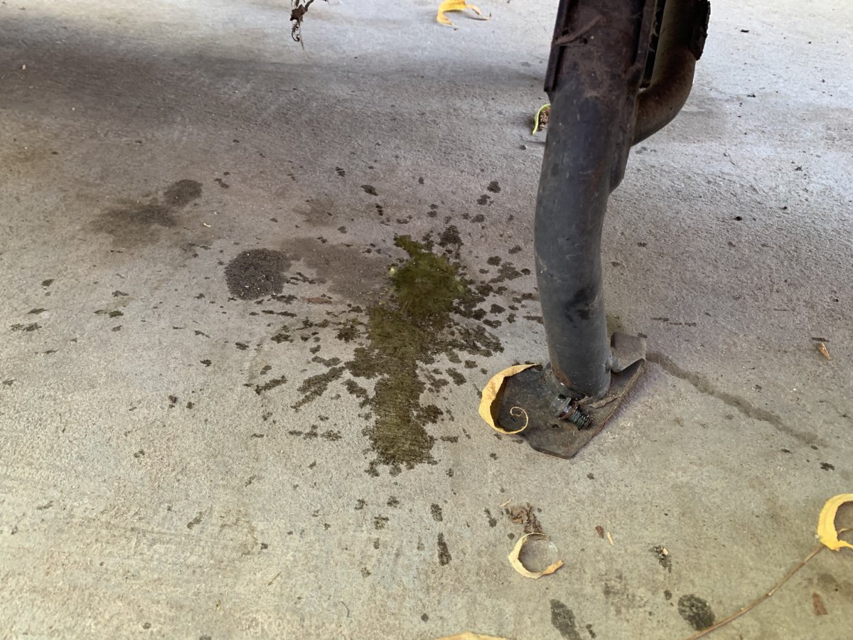

Since I am waiting on parts, today I decided to flush the coolant and put new stuff in. :D
I found the drain plug and took it out. A lot came out. LOL
Ok, really once I took the cap off more came out. so even though the filler resivoir was empty, there was still some coolant in the system. LOL
I used the air compressor to flush the rest out and then reversed the process. I just need to wait till I can start it and let it run a bit, then top it off.

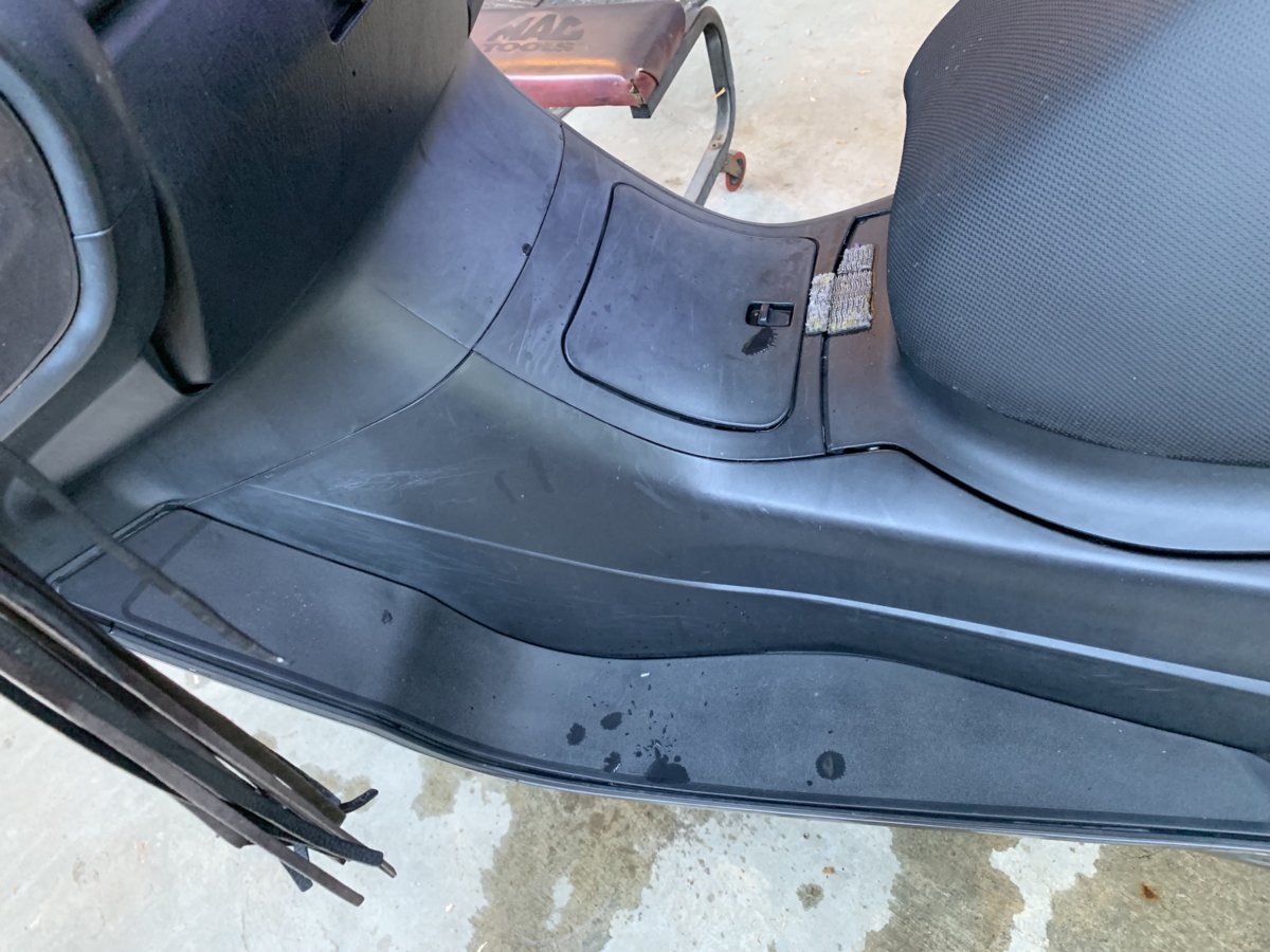

I decided since I have to wait for the tags, I might as well shine it up.

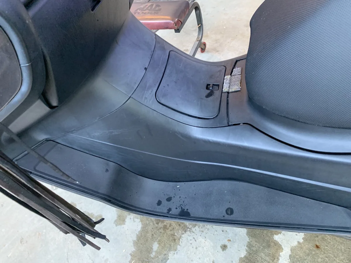

Here is a before on the plastic.
Half done,

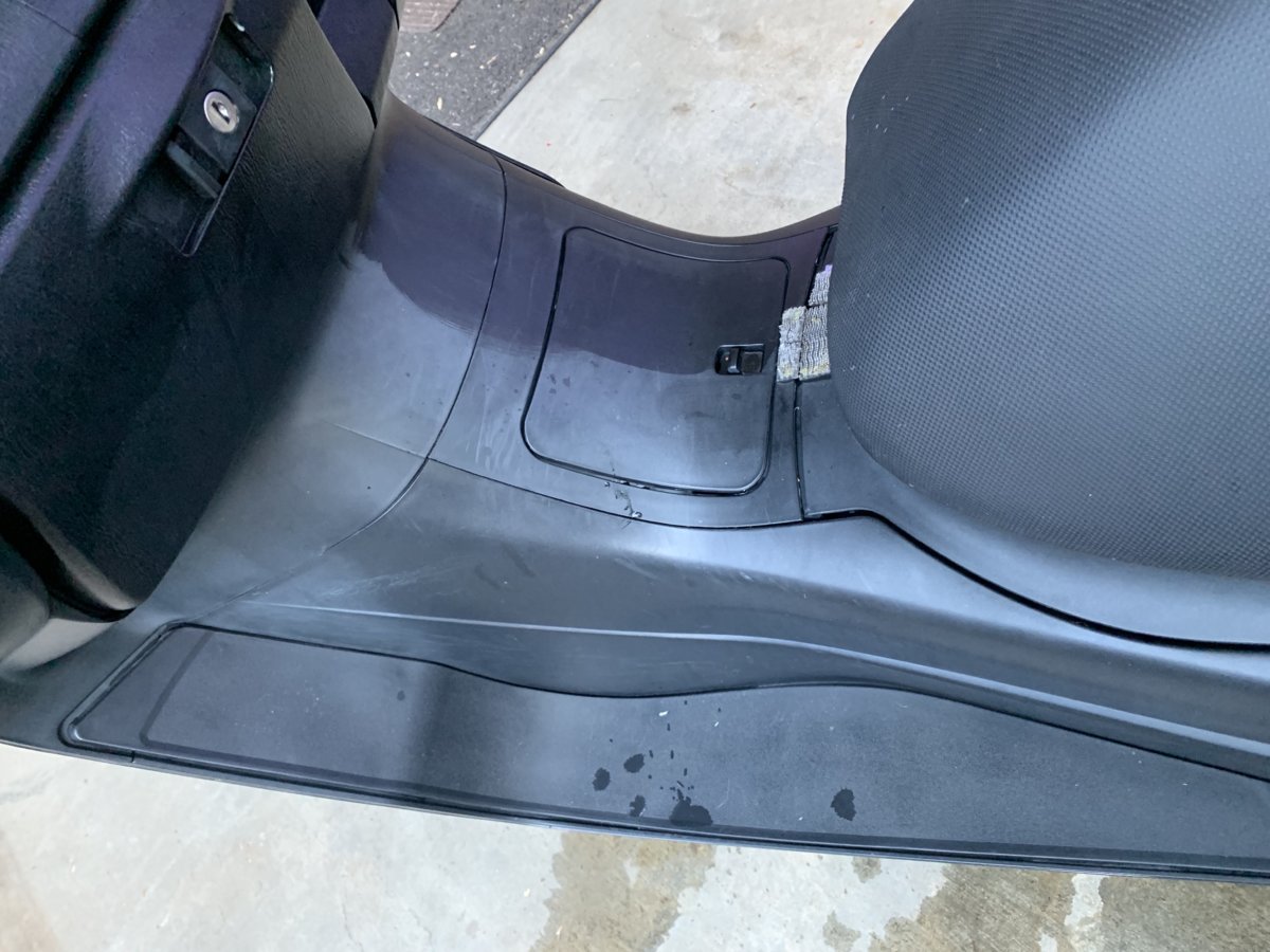

Final product. :D
