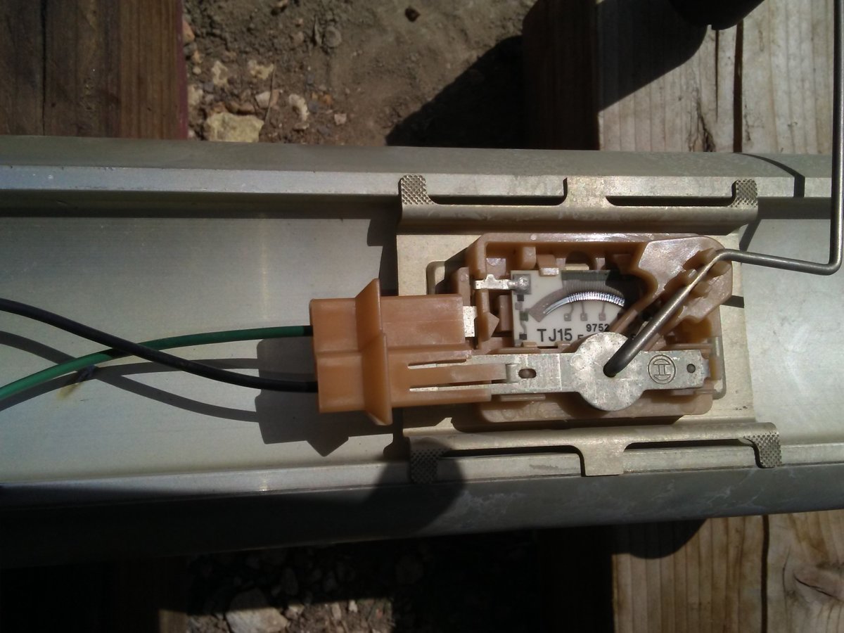

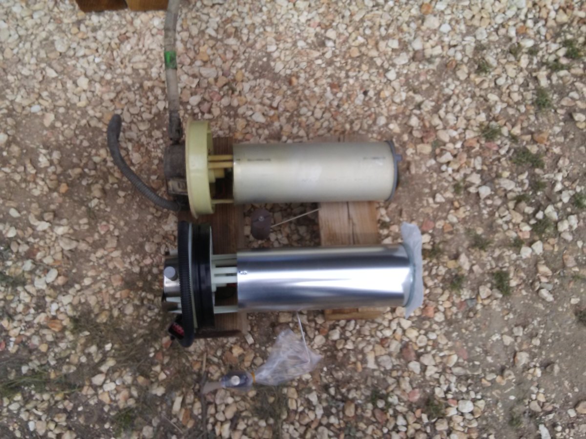

Questions about the fuel pumps in the two tanks have also arisen. As far as I know, they are identical except for the gas gauge float mechanism that tells the gas gauge that the tank is full at something under 15 gallons or something under 19 gallons. Those who have kept their 15-gallon fuel pump after making the modification to 19-gallon tank capacity report that it just shows full a lot longer.
The fuel pumps themselves are identical in size. I measured the height of my old 15-gallon fuel pump and the new Delphi FG1353 19-gallon one that I bought. The photo below is a bit misleading, because of the filter on the bottom of the new one and the electrical cord wrapped around the top of the new one, and the new one being a little closer to the camera, but they are the same height.
The close-up photo of the old one shows TJ15 on the gas gauge float mechanism.
A new Delphi 15-gallon fuel pump costs $60 more than a Delphi 19-gallon one from RockAuto. There is no need to buy the 15-gallon one.
The RockAuto website says that the Delphi fuel pumps are made in the U.S.A., but when you get it, the box says made in China. Yes, even Delphi now.
By the way, my old 15-gallon original equipment fuel pump was still working fine. I only replaced it because I had the tank off the Jeep and the Jeep has 157,000 miles on it.
