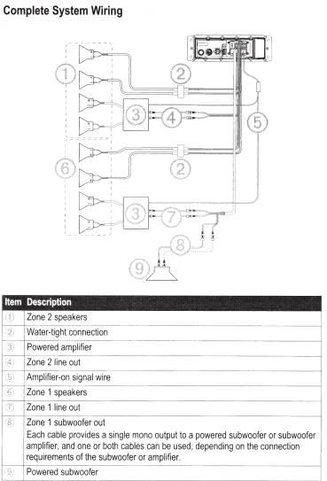

One note, the preouts it references are not like a normal car stereo (because a boat doesn't need fading) also, you only need one zone. So you will only have one stereo non-fading pair of full range preouts and two mono sub preouts. The other pair are set for a second zone, like a boat cabin. It looks like same issue goes for if you want to use the onboard amp.
Thanks for that. I already have a 5-channel amp, so I'm pretty sure I don't want to try to figure out the two non-fading zones and only one stereo pre-out. Just seems a little wonky.

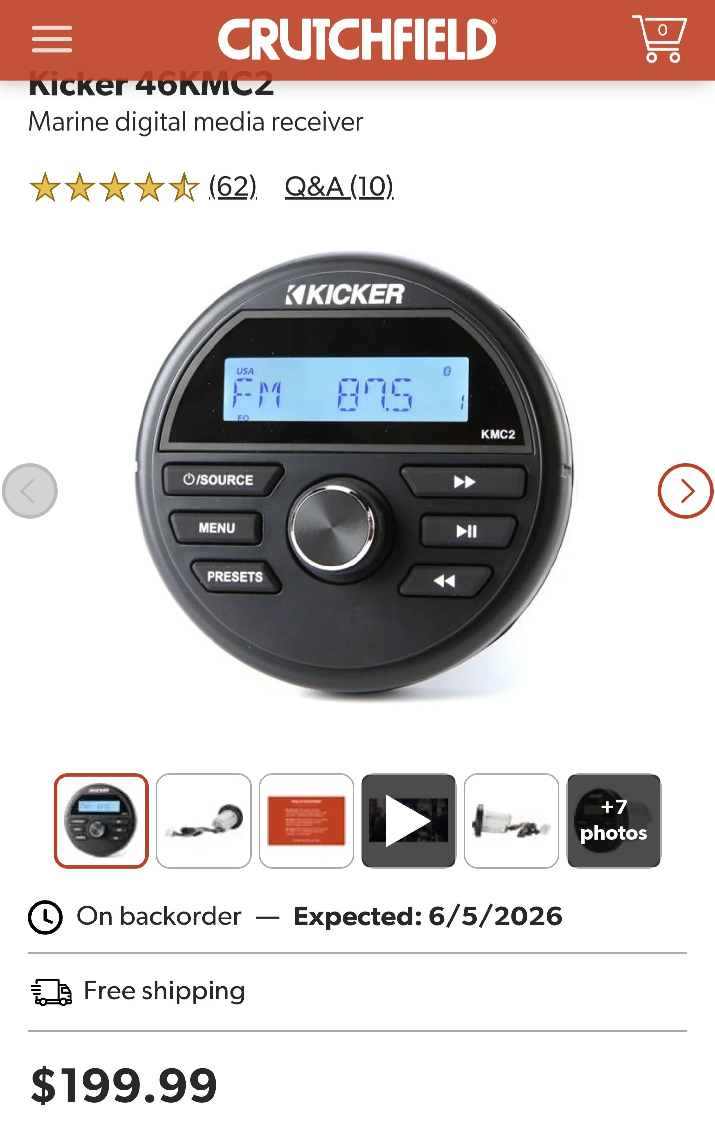

The other types I've been looking at are these round ones. This one is pretty spendy and I think it would work, but only 2V pre-out. For this I'd need a Double Din and a custom mounting plate. Not that difficult to do. I think Crutchfield sells some ready to go. Would leave options to mount other electronics in the remaining space, but not sure that's a real advantage for a KISS person like myself. They sure want a lot of money for it.

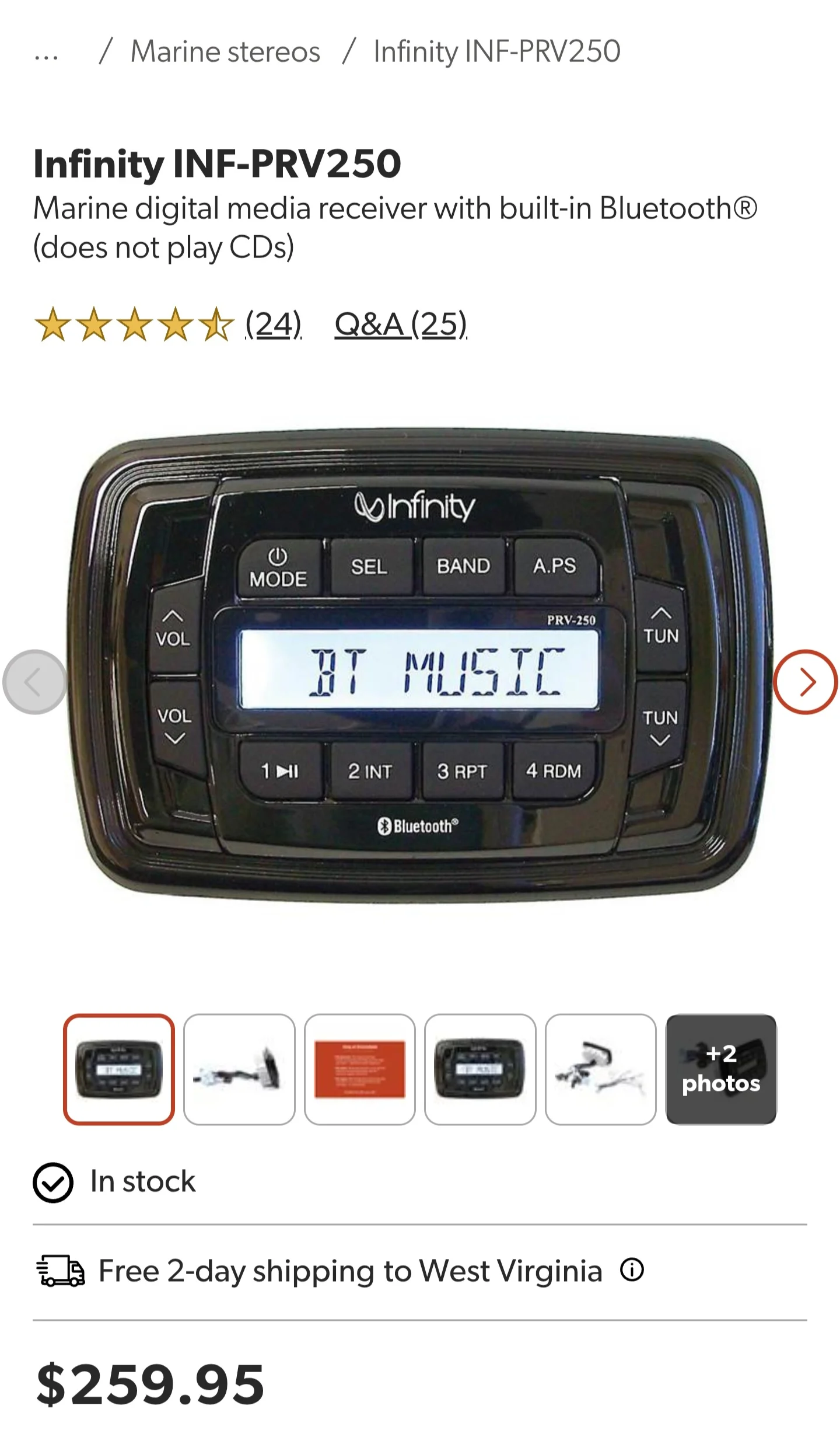

Have you considered one of these? I actually just gave the infinity one to a buddy a couple of weeks ago to get it out of my way. I'm 99% sure he's not going to use it. If he isn't, and you want it, it's yours for the cost of shipping. You'll just need to order the harness which if i remember correctly is around $40 (or maybe it's not even necessary in this application).
View attachment 691030View attachment 691031
I did look at these and found them pretty attractive. The Infinity has 2 preamp outs. If I can confirm that I can run those 2 via RCA (F & R) as well as 1 set of high-level line inputs to the amp for the Sub and it all work then I'd do that for sure!
I looked at the round Kicker too. It didn't have the pre-outs I was looking for so I moved on, but their 46KMC4 and 46KMC5 are up to the task.

Well shit, I lead you astray.
I just bought a boat with a Fusion head unit and now know how they work after putting together plans for the aftermarket setup.
The zones aren't media zones, they are independent volume zones. It's a little finicky, but when you use the volume knob, you have multiple options pop up on the screen. In the case of two zones, you should be able to run 1 0-100, 2 0-100, or lock in where they are and adjust them together. Pushing the volume knob cycles between the three methods.
The sub output is tied to a single zone and it's volume is controlled by what you choose for that zone.
