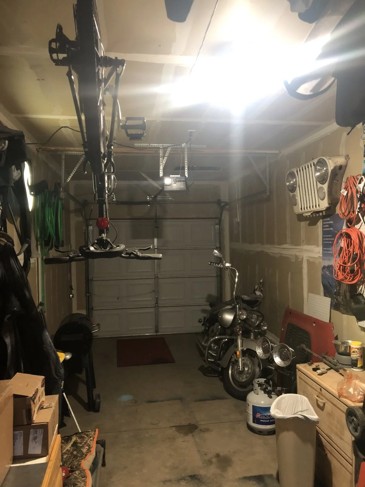

I have a single, 75 watt LED bulb in my garage (10'x27'). I need better lighting. I've made the decision to go full LED strips. I'd like 5000 lumens or greater with daylight color. My garage is set at 15 amps, 120V with only two electrical outlets (one on the ceiling for the garage door opener). Can I use my one single bulb wiring and wire 4-8' LED strips "Daisy chained" to each other? Home Depot has a 45W 8' LED strip. 8k lumens and 4000k color. Which would be exactly what I am looking for. I wouldn't even be close to over loading the circuit with these either. Thoughts? These would be two side x side in the front and rear of the garage on a single light switch.

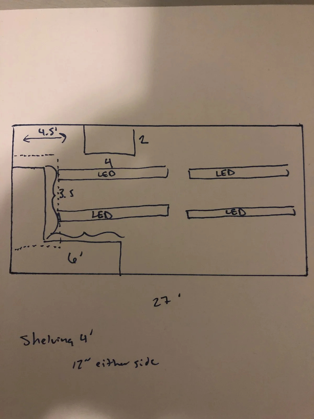

This is what I was thinking for placement (bear in my mind I don't draft plans). 2 lights 2' away from the wall over my bench, two more over the parking area

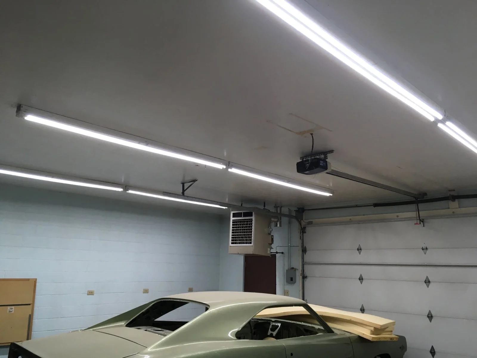

I put 12 of the 4' LED strip fixtures in my shop and I love the LED vs the old fluorescents. I was spending more on the bulbs then the cost of a new LED unit.
Most of the LED's come prewired with a plug but it's easy to convert them to hard wired.

I'd try to spread them out a little farther side to side getting them at least as far apart as the TJ, or any car is wide. The farther apart, a thinner the shadow on the floor beside the vehicle.
Space is limited as the garage is only 10'. Should they be 1' away from either wall vs 2'?

The ultimate goal is to reduce shadows. You can hook up the lights temporarily, and play around with the placement. If you move them closer to the wall the light will wash down the walls, but you may get shadows along your workbench. Another option would be the 4 lights along the walls. Add a 5th down the middle and than a smaller light 4' maybe above your workbench. If you want some with layout and install I would be more than happy to give you a hand.

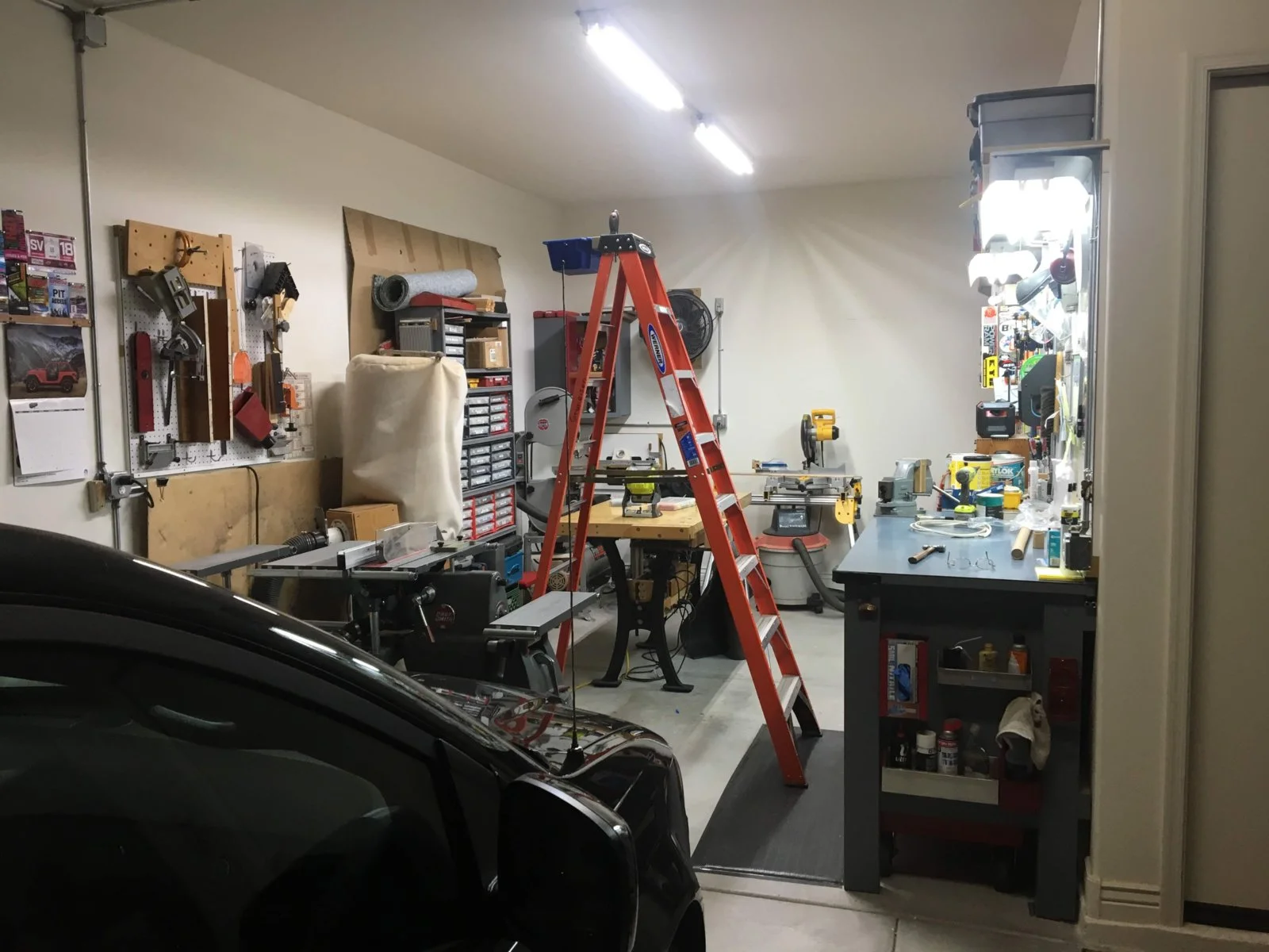

This picture is of my 11x19 work space in my garage.
76001
I replaced the original twin 40w fluorescent ceiling fixture with these two hardwired LED fixtures.
https://www.primelights.com/shop/items/the-bolt-2-lamp-led-shop-light-5700lumens-pl-blt44wcl
I couldn’t be happier with the results.
I tried replacement led bulbs. Not satisfied with the improvement.
A fixture from Home Depot that worked for a week! It was replaced with a fixture that never did work!
And a pair of lights I bought from Rockler that said they weren’t designed to be flush mounted ?!!
I paid $52 apiece with a cyber Monday deal, no tax, free shipping.
Did I mention I LOVE the improvement?

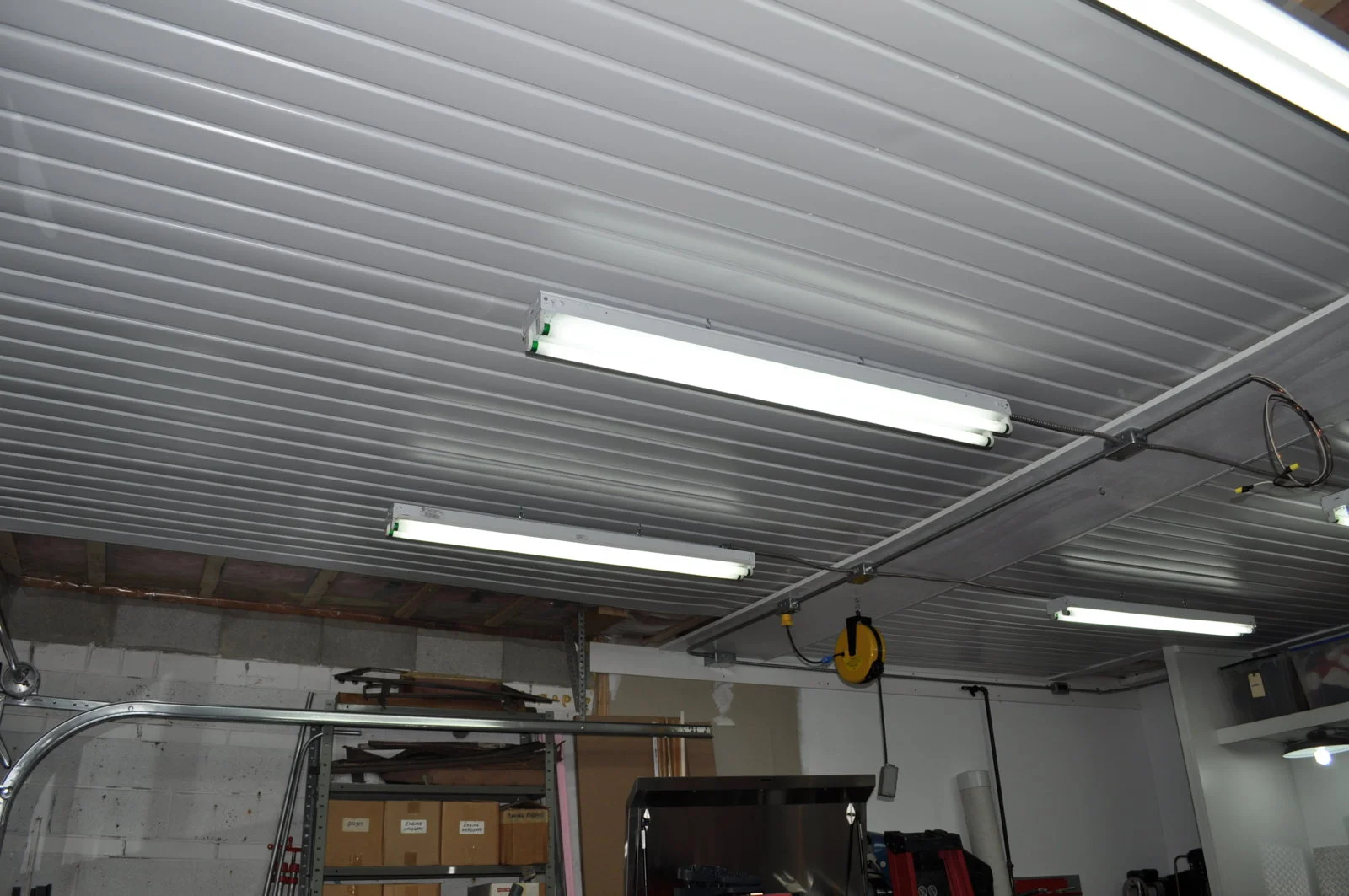

I used T8 32 Watt Daylight bulbs when I redid my garage lights. I don't know if LED's were available then. I sure would have considered them. I definitely agree with the comments above about having a white ceiling. I did NOT want to drywall mine. I drywalled the walls (not complete in the pic below) and painted them white but because I couldn't empty the garage when I did the work, lifting drywall to the ceiling would have been tough.
I used aluminum soffit panels (16"x10' each). They are light, white and easy for one person to install. There was no taping, seam filling/sanding or painting. It makes for a nice industrial/commercial look and the cost was about the same as it would have been for drywall.
This is a great Idea...I was going to use polebarn steel, but I like the look of your soffit better.
I like the price of those a lot. I hadn't come across these in my search, thanks for the link! We're not to far off from the same footprint, your photo looks like it provides plenty of light. 6 of these (2 on either end, 4 in the middle should provide what I am after).
