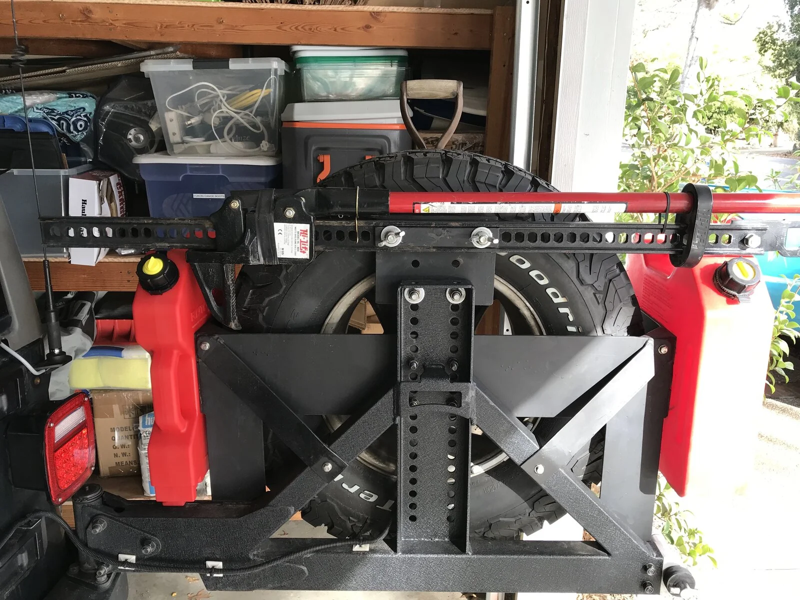

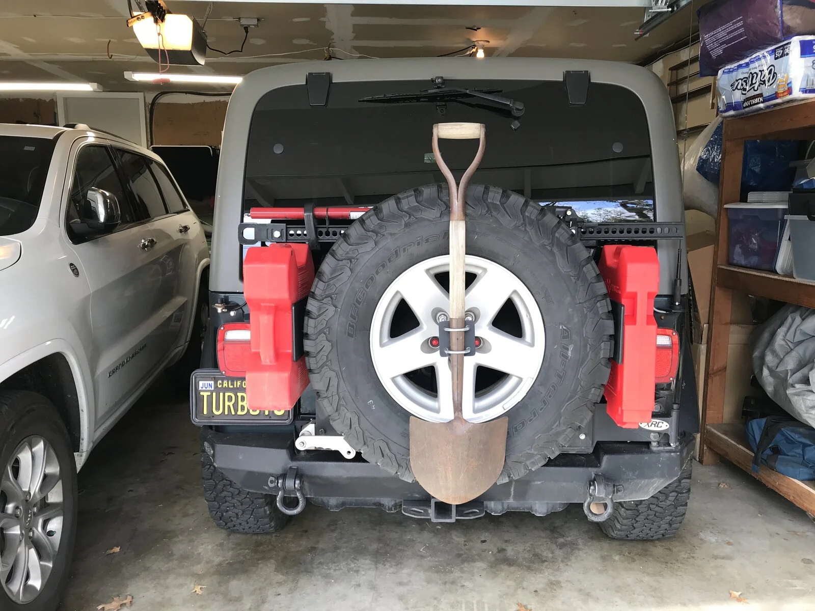

I’d recommend that you keep it outside and not in the cabin. The rubicon rack style works well for me.
I d like to see the brackets?

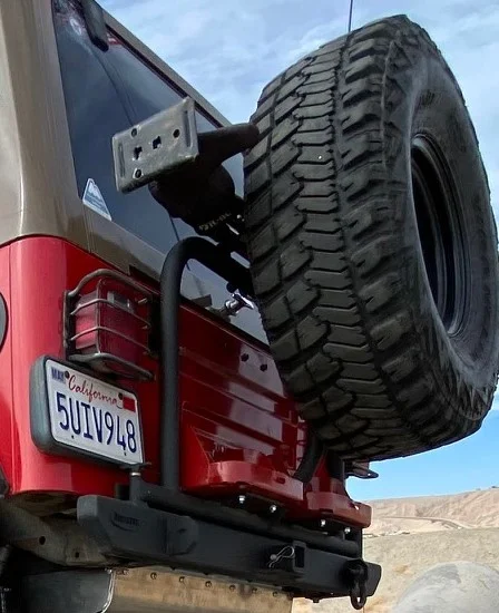

You can better see if from the back. I welded it up from 3/16 inch steel and bolted it to the tire swing. The 45 degree braces make it very rigid and the Rotopax don’t bounce around at all. They Rotopax tuck it very tight and low. Of course they are only 2 and 3 gallon size. Sometimes I carry a Rotopax 2 gallon water container in lieu of the 2 gallon gas container.

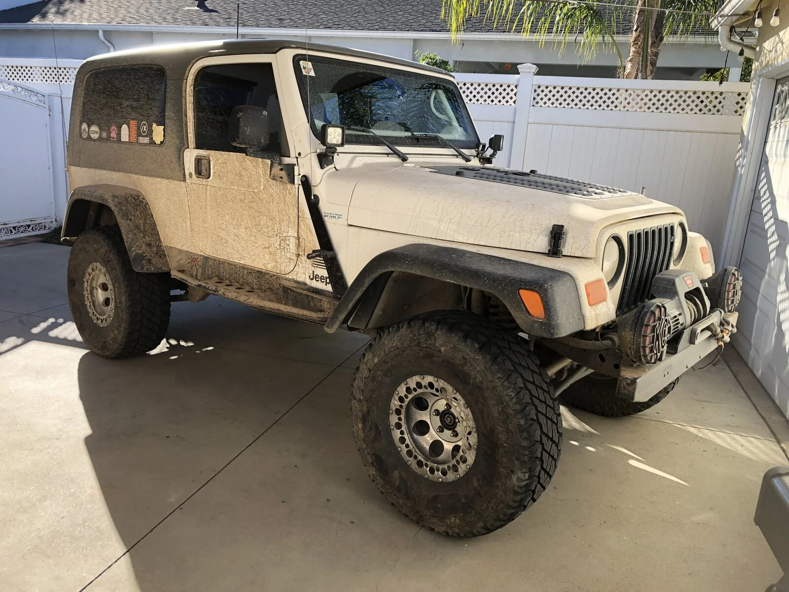

My path won't work for all of y'all, but my Jeep is 22 years old and I will drive it until they take my keys, so that justifies modding it as I like, hang the cost. I installed a GenRight long range fuel tank, of welded aluminum and with a steel skid plate. 24.5 gallons, for an increase over the OEM tank of 5.5 gallons and all of it down between the frame rails. Lost no ground clearance. Leaving about 4 gallons as a minimum, highway range is about 350 miles.
For a bit more, I can carry a 2 gallon RotoPak on the MorRyde tailgate hinges. For a real trek, I installed the receiver mounts to the frame rails, just behind the front wheel wells, for the MorRyde side jerry can carriers. Not in view unless the can carriers are in place. Then, I have another 10.5 gallons. Or the side bins can carry recovery equipment and such.
So, base fuel capacity is 24.5, with another 2 quickly available. Then the side carriers bring me to a total of 37 gallons, of which I consider 33 to be useable, for a range of 550 miles.

You can better see if from the back. I welded it up from 3/16 inch steel and bolted it to the tire swing. The 45 degree braces make it very rigid and the Rotopax don’t bounce around at all. They Rotopax tuck it very tight and low. Of course they are only 2 and 3 gallon size. Sometimes I carry a Rotopax 2 gallon water container in lieu of the 2 gallon gas container.View attachment 304254
Wow,very strong

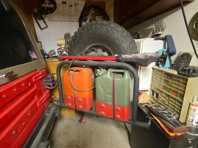

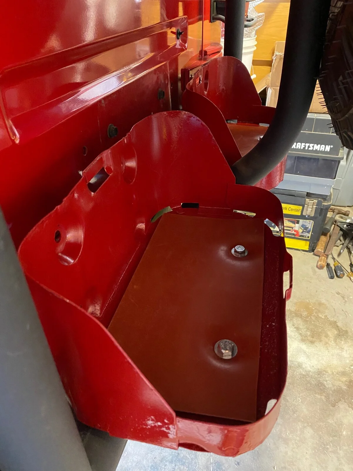

This is my set up. I have an extra Jerry Can holder you can have for $25 (you pay shipping). If your interested in buying the one I have I'll post up a pic but its identical to what you see.
