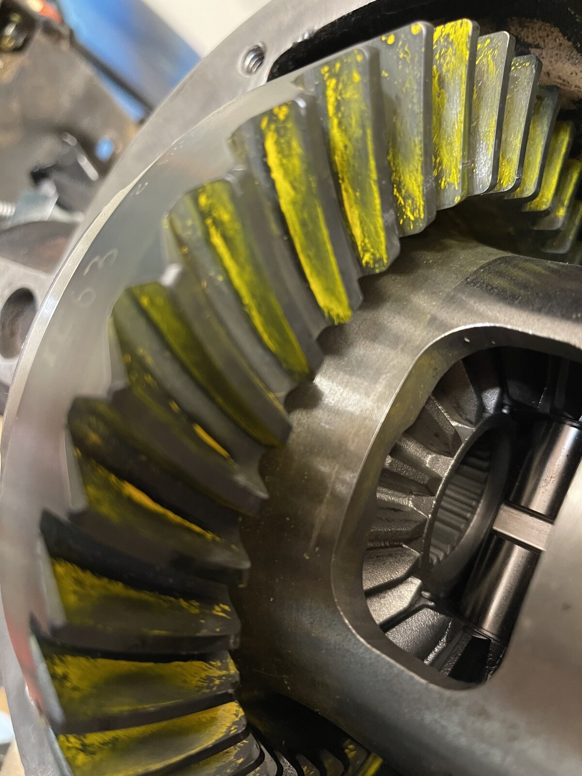

Finally got back after it this morning. These pictures are after the crush sleeve eliminator install. Pinion preload at 12 inch pounds. Gear lash after torque on the bearing caps is at 7.5. I’m thinking I need to open up the gear lash some.
