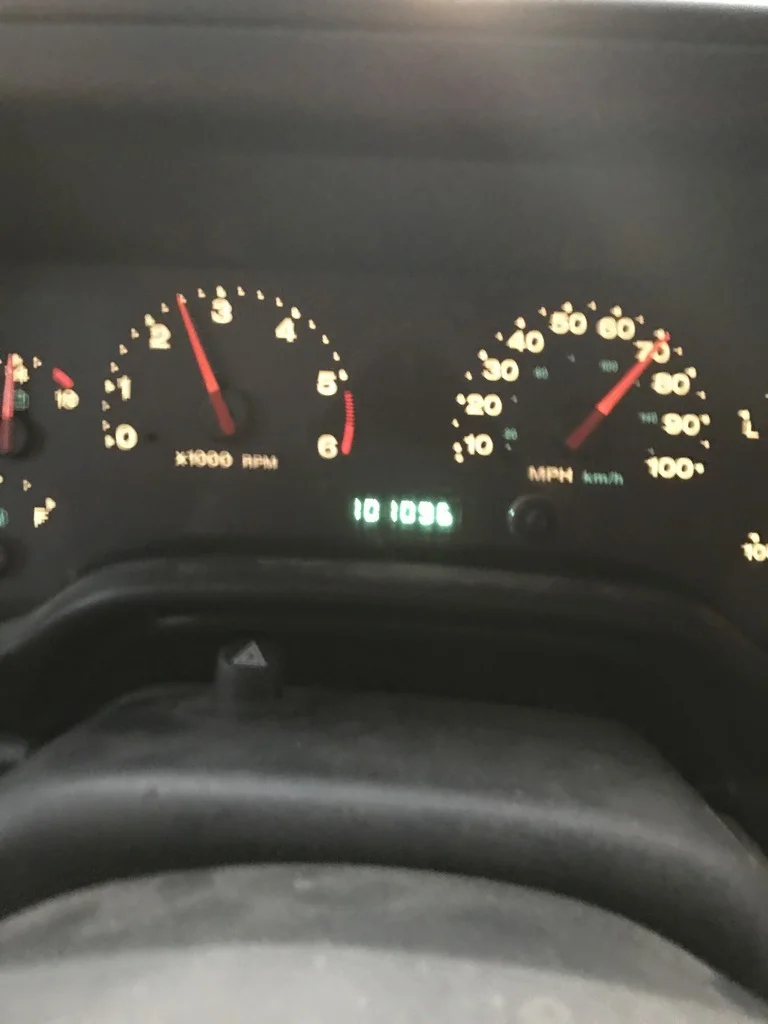

Well, it would be tough to snap a pic with one hand on the wheel and a beer in the other :D
Nah. With the Currie currectlync, I can be driving 85mph and take my hands off the wheel, and my rig doesn't wander whatsoever.
It can be done, not smart, but I could do it :)
That's the beauty of having quality parts!
