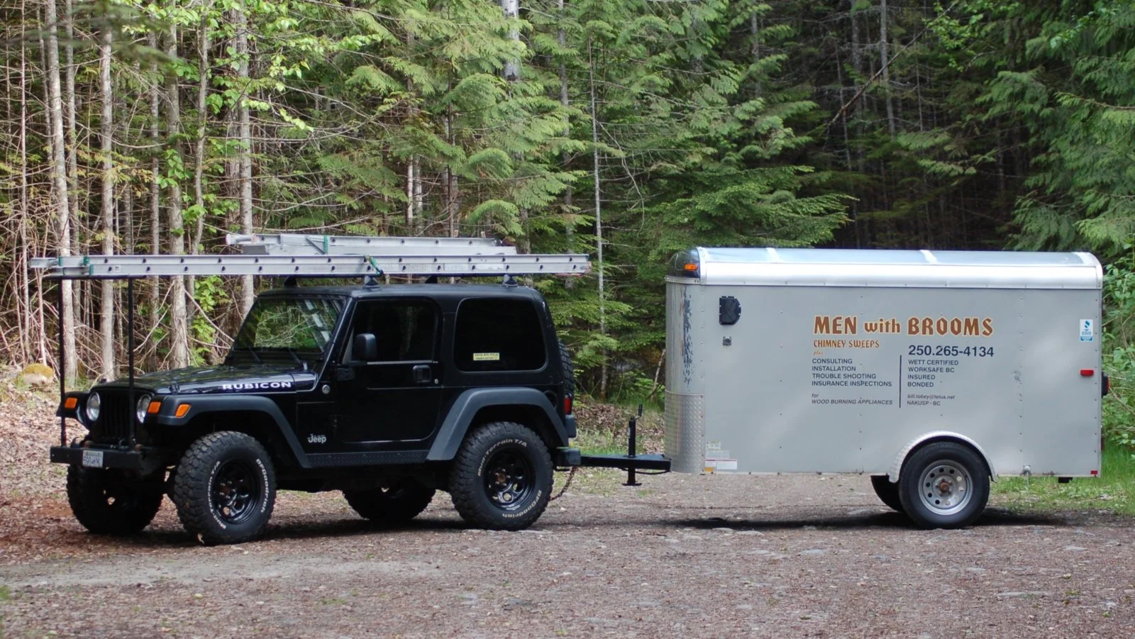

billiebob
Oct 31, 2015
4,299
Kootenays, BC, Canada
6-speed manual NSG370
33's - 4.10 more street, 4.56 more trail or mountainous/hilly highway
I drive 24K miles every year, mostly pulling a trailer in the mountains. With 33s and 4.10s. I wish I had 3.73. All too often I will be on a long steady downhill wishing I had one more gear.... or 3.73s That is real world experience, anyone else here put 24K miles on every year, towing a 2000 pound trailer for most of those miles? ... in the mountains?

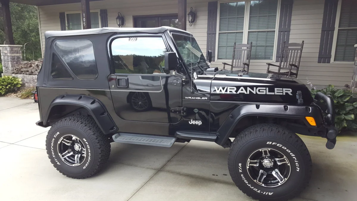

Looking for some help. I have a 2002 TJ, 4.0 that I purchased from and individual. They did not do the modifications so no clue what was done and what wasn’t. I’m just trying to fix things as I can. It has 33” tires but the speedometer gear was not changed out so it’s about 5 MPH off on the highway. I found the tag on the rear axle but it’s not clear. I can see 07 where the gear ratio should be so I am assuming it’s 3.07. On most of the charts, 3.07 gear ratio doesn’t coincide with 33” tires to give me an answer as to which speedometer gear to get. What should I do? Thanks in advance.
JMT
The Jeep Guy
Feb 27, 2017
8,725
Washington
Forgot to add this is an automatic transmission
I can’t imagine how much of a dog 3.07 gears and 33’s are. They may not make a speedo for that combination because it shouldn’t be run. Not that it’s not safe, but that it’s so dog gone horrible it’s unthinkable. That thing should be regeared to 5.13. Then get a new speedo. Or drop to stock tire size.
How much lift is on it? 12” stock up front, including the coil spring isolator, 8” in rear. Anything above that is the amount of true lift you have.
374gatorgirl
May 29, 2019
44
South Carolina, USA
Yes I went into this without the knowledge I should have had had. The tires were already on and fairly new. It’s a daily driver so has mileage is less than ideal. I’m not sure of what inch lift. Total girl here but trying to learn. I am ashamed to say I don’t do off road but I love my Jeep! How can I measure the lift properly? Here is a pic to give an idea.
