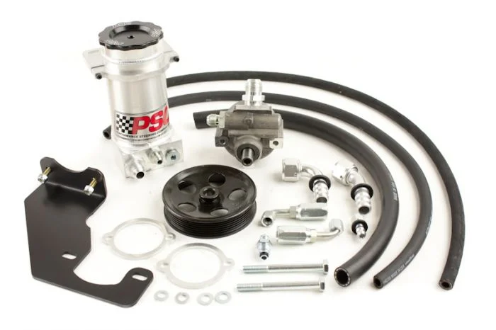

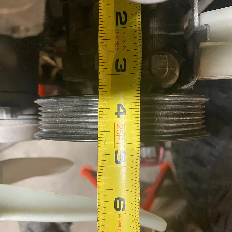

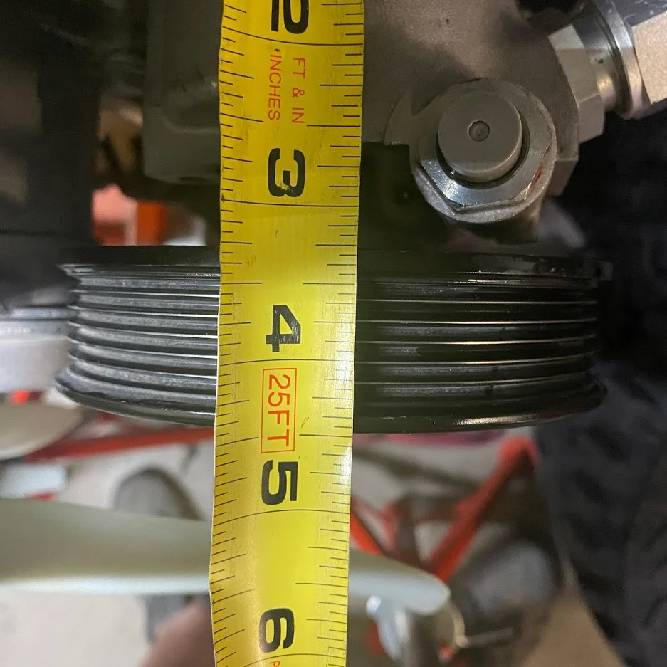

I did some exploratory work - this time focusing on the P/S setup. I see a lot of conflicting info on the P/S options, compatibilities, etc., so I won't be confident with a solution without some experimenting.
The factory Hemi PS pump has the same mounting hole spacing at the PSC CBR pump, which is the same as the older Jeep 4.0L pumps. Like the factory pump, all three holes are through-holes. The PSC pump also has 3 holes, but the one on the left (when looking at it from the front) is a blind-hole.
Spacing wise, the pulleys are in very similar locations - only ~1/8" off:
[Factory 2012 5.7L Hemi pulley - showing distance to the flat cover behind the pump]
[CBR pump as provided in PSC's #1852 kit]
It appears as though PSC offers a few pump options for the JK, including what appears to be a CBR pump with a few spacers. The PSC rep I spoke with confirmed that the JK pump kit uses the same pump but with a different size pulley. He also confirmed that the JK-Hemi kits only utilize the top and bottom bolts. I placed an order for some spacers, a new 3/4" return line, and a 180º fitting.
Fingers crossed that this is an easy solution :)

When I did the Hemi, at first I tried using the stock pump to run the hydro assist and hydro boost. No dice. Too slow, and overheated. Went to the PSC remote reservoir pump, and it works like a charm. No spacers needed as I recall.
Reactions: pc1p and Wildman
It's weird - the early year pumps were too weak and the later year pumps are too much. A lot of people have tried the later-year truck pumps and they have too much juice and end up blowing the seals out of steering gears!
What pump did you end up going with, the CBR? I know there are some differences between the Eagle and non-Eagle accessories. The guys at PSC said "you will need 2-3 spacers" and he even went in the back to grab and measure the thickness (they are confirmed 3/16" thick). Mine shows to be ~1/8" offset. I figured I can use a flat sander and get my spacer down to the 1/8" needed rather easily.
Here's the PK1860/62 kit that PSC sells. You can see the two spacers they include with their setup. It possible that they sell a different pulley with a different offset (it wasn't mentioned to me)???

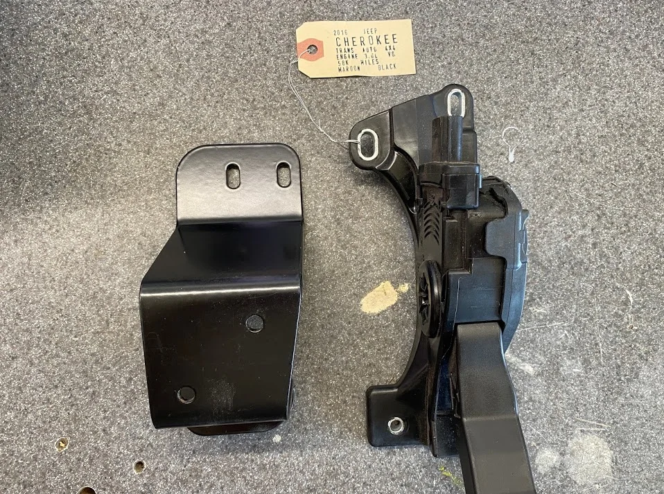

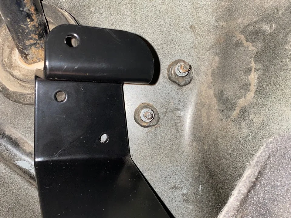

Unfortunately the TeraFlex 4877480 TJ gas pedal bracket kit isn't going to work...
First, the spacing on the later-model pedals is indeed not the same as the earlier pedals.
Second, the holes weren't drilled on the proper side! Based on where the angled-side of the bracket is, plus the holes being in the wrong orientation, I'm beginning to suspect that the bracket was pre-drilled and then put into the forming brake on the wrong side...
On a happy note, the Hemi NGC mounts in the same spot with the same hardware as the 4.0L JTEC :)
