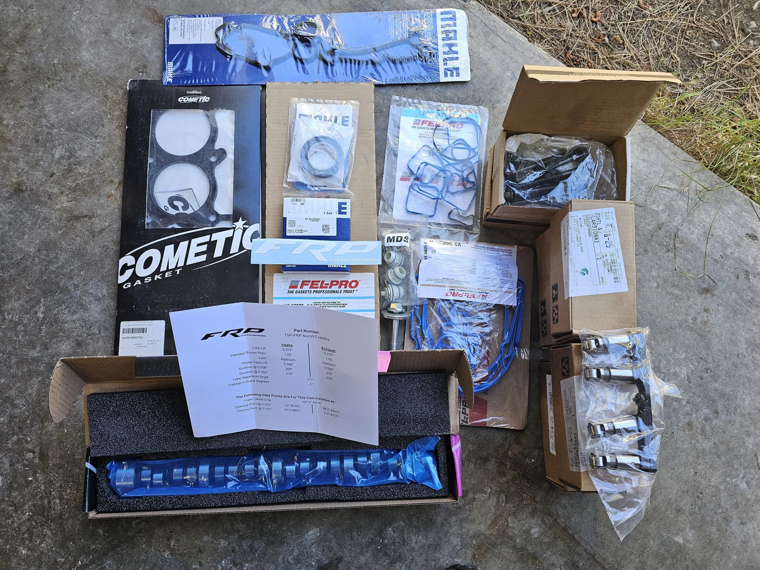

Here's what comes in the Eagle head kit from FRP.
And the 2.0 Hellfire non-VVT cam specs.
So parts are:
Intake manifold gasket set. (I'd forgot to tell Ryan I was using the old style intake)
Exhaust manifold gaskets
Head bolts
Harmonic balancer bolt
Cosmetic head gaskets
Timing cover gasket
Water pump gasket
MDS delete plugs
Cam bolt
Edit: Push rods will be ordered after the length is checked.
So parts are:
Head bolts
Timing cover gasket
Water pump gasket
MDS delete plugs
Cam bolt

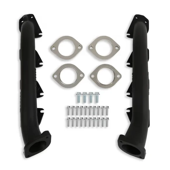

I bought a pair of Hooker Blackheart headers to try out. I'm hoping they will work.

I bought a pair of Hooker Blackjack headers to try out. I'm hoping they will work.

Blackheart headers

Did you get the specific Hemi Swap headers or just some generic headers? I know for the LS stuff, Holley/Black heart discontinued all the exhaust bits because of “EPA” is what I heard.
  • Wow
Reactions: Apparition
I just got some generic ones. They are the ones mentioned here in this thread.

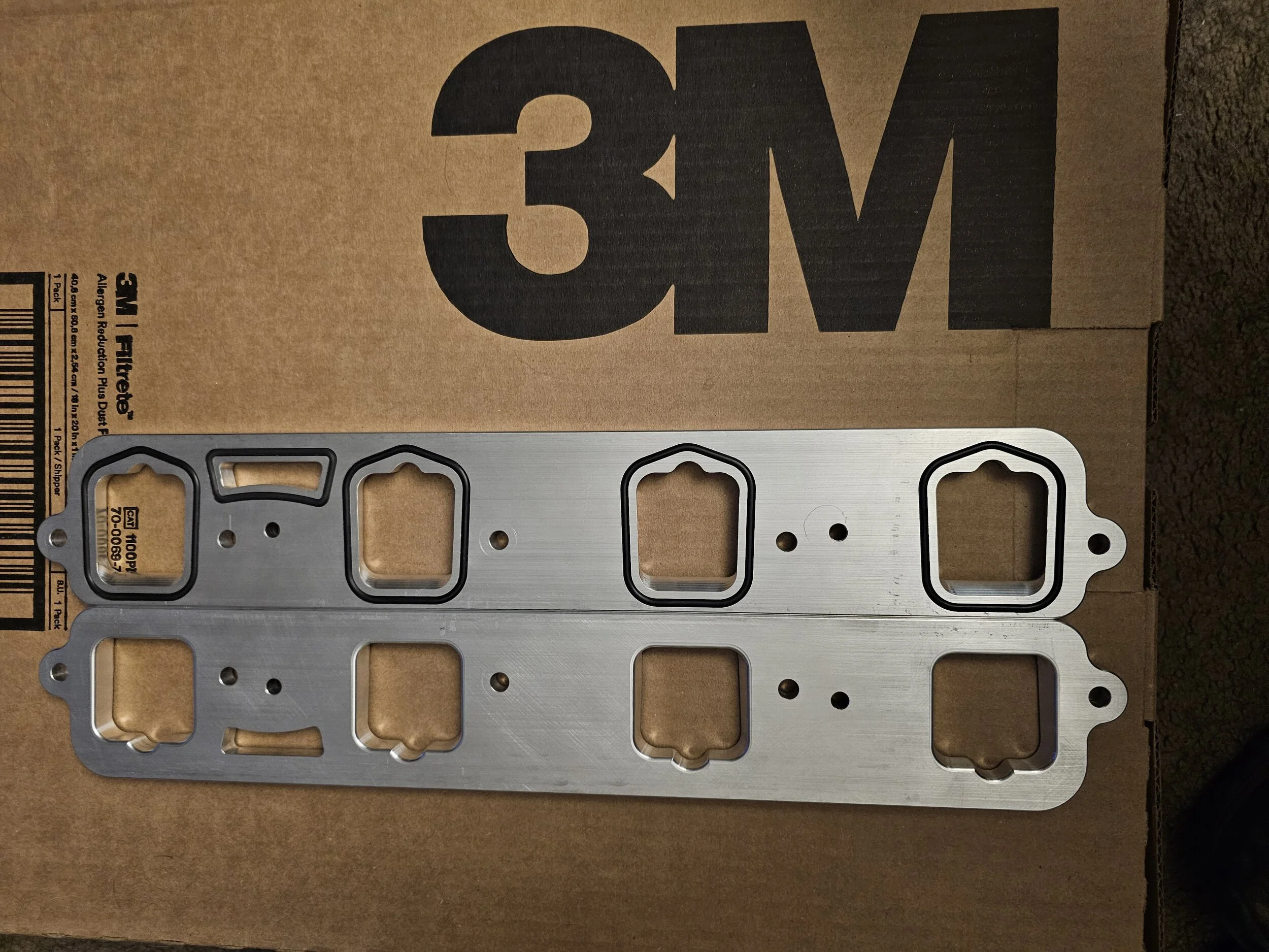

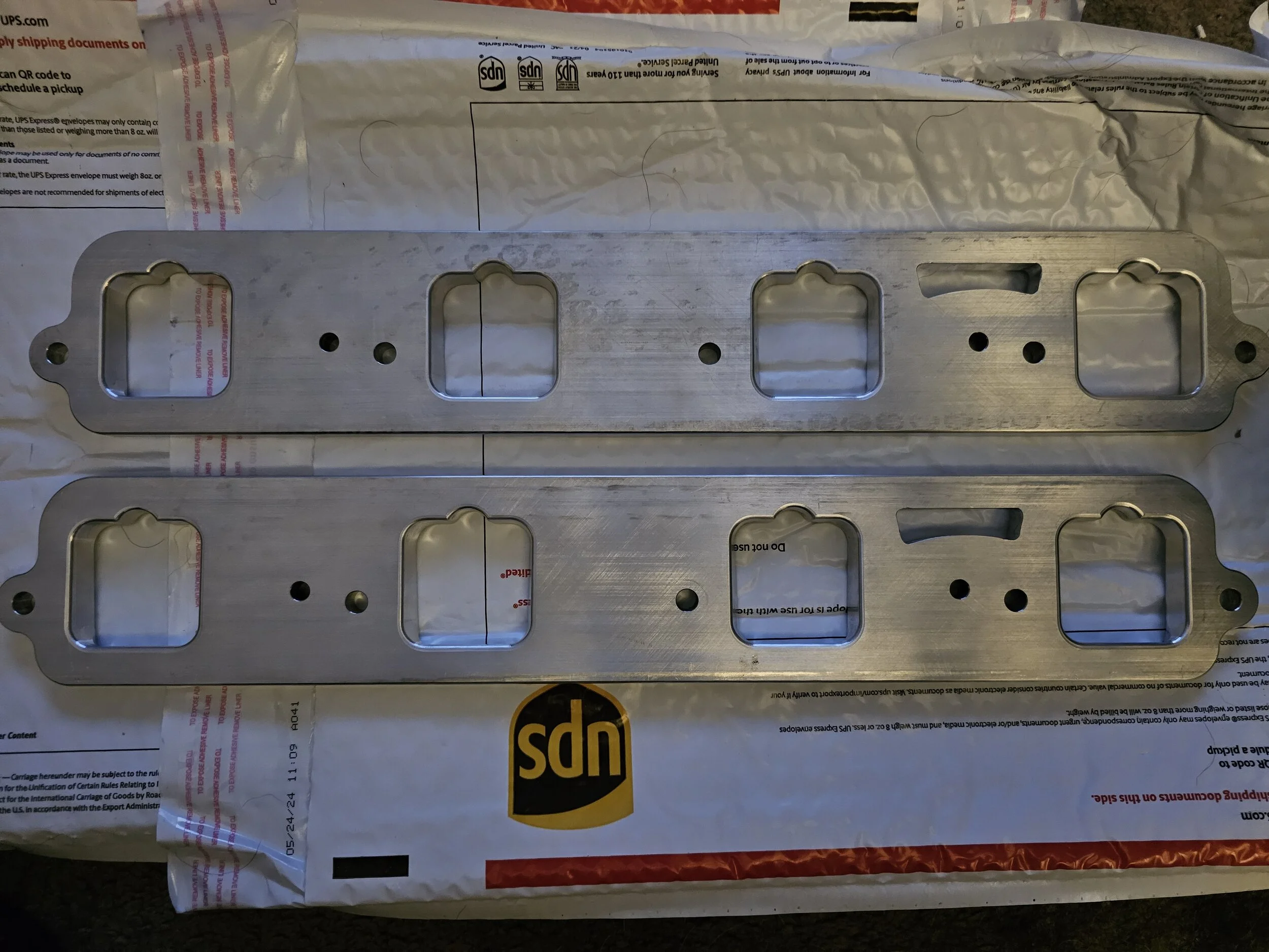

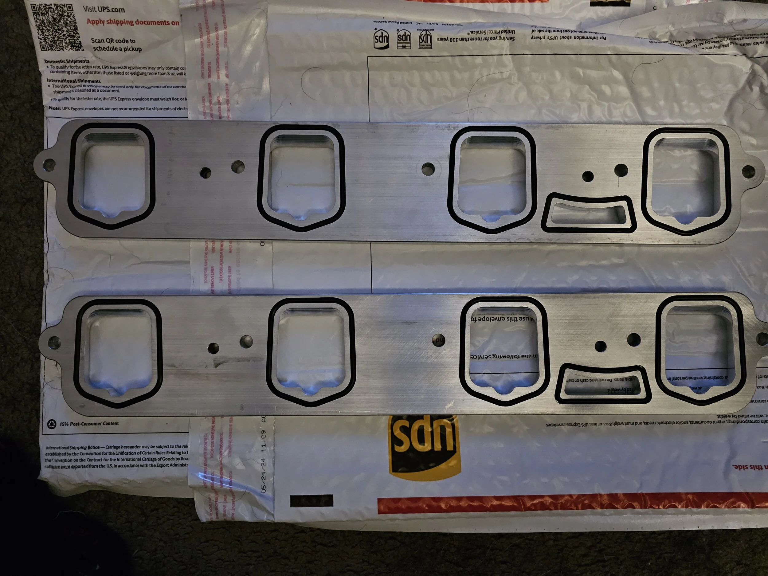

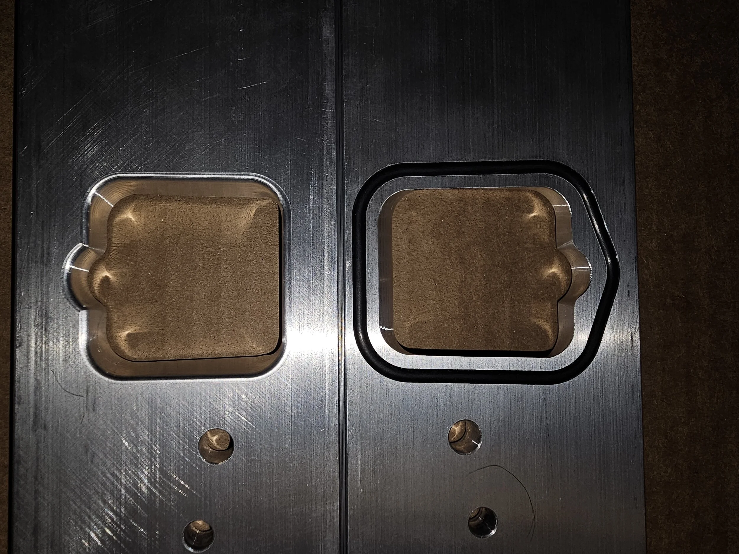

Here's the intake manifold adapters from MMX.
They are beveled to go from the smaller intake to the larger Eagle heads.

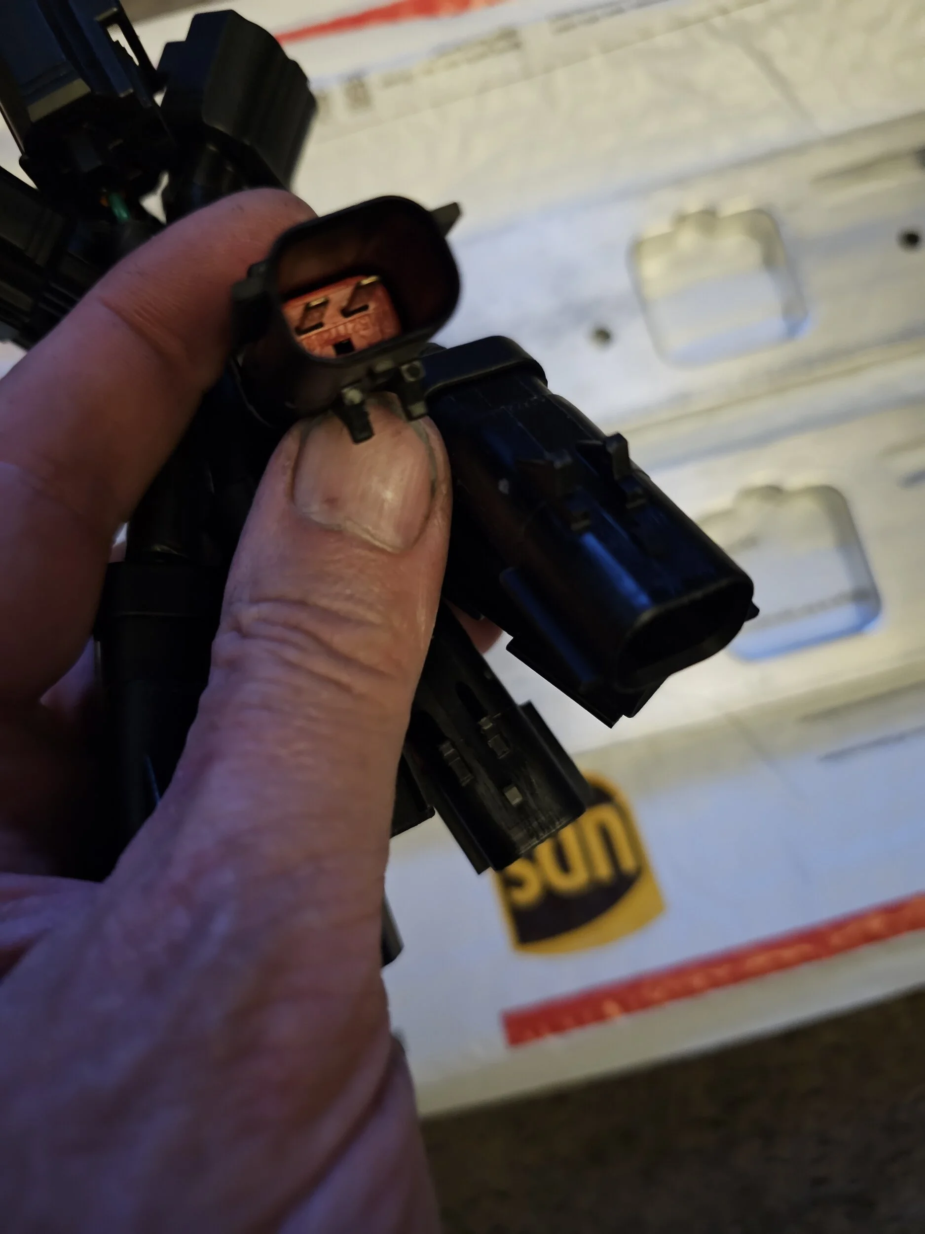

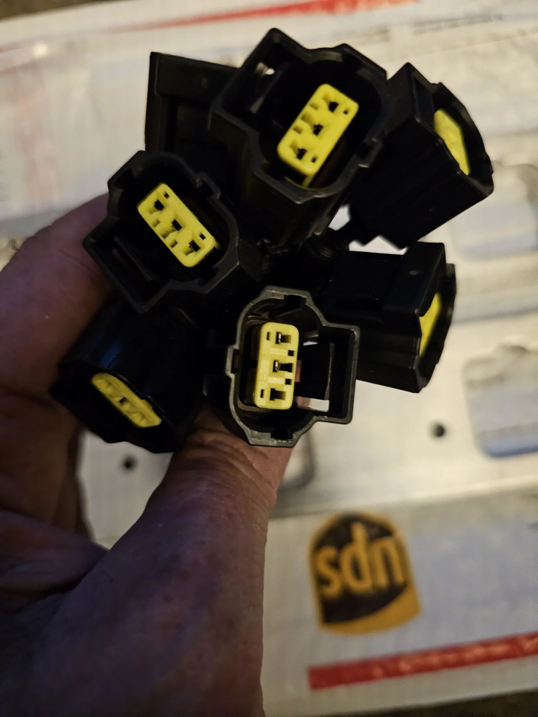

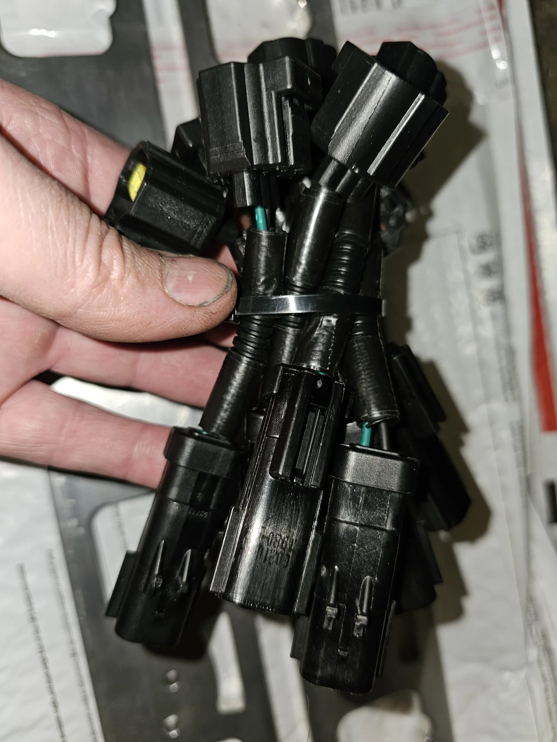

And the adapters for the newer coil on plugs.
Wildman,

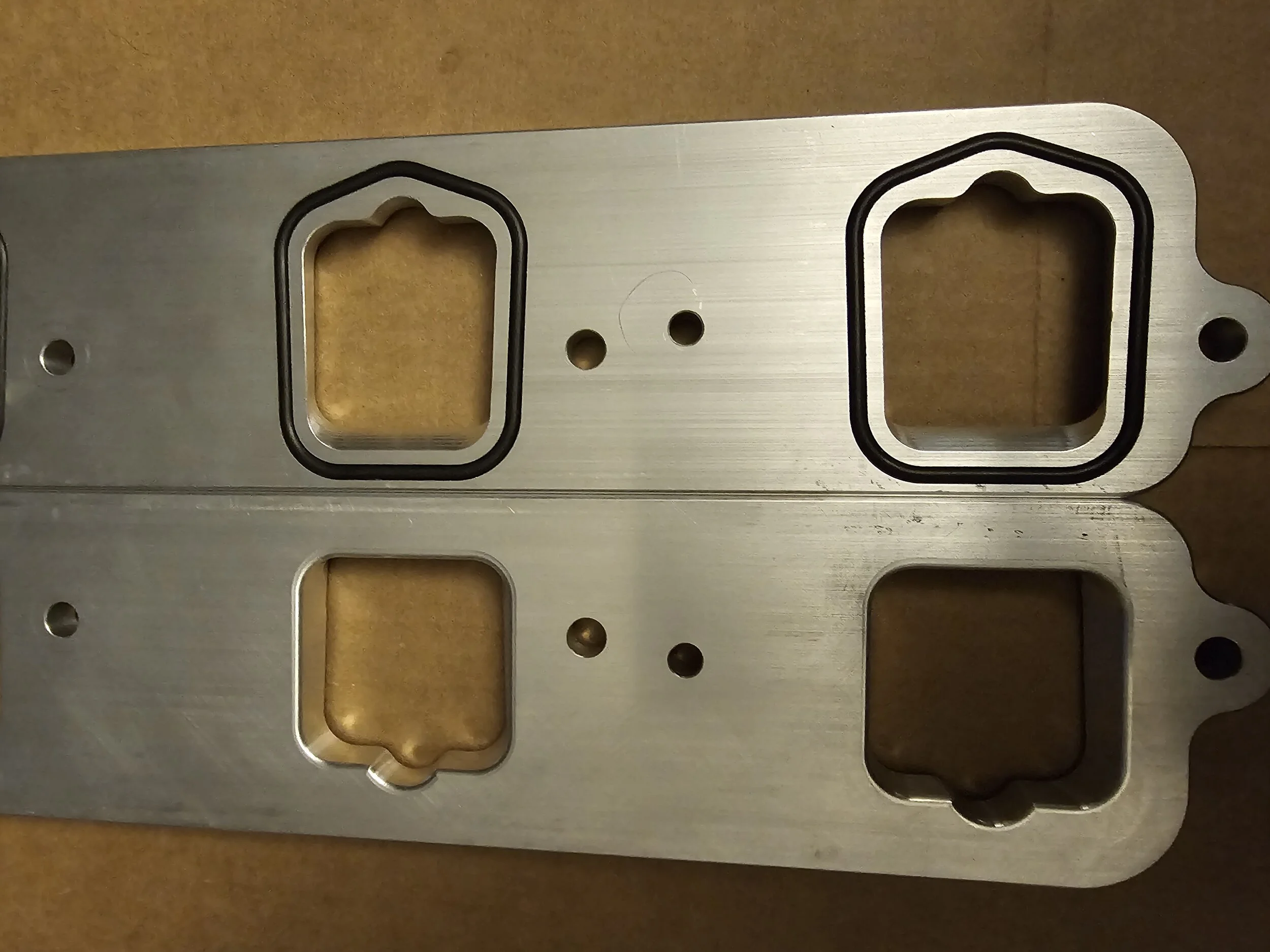

Do you have a picture of the intake adapters laying side by side showing each of them turned to a different side/surface for us to visually compare the difference in the ports on each side. It would be easier for me to see the difference if they are side by side as opposed to two different pictures. Thanks in advance.
Reactions: Wildman
Wildman,
I'll take one for ya.

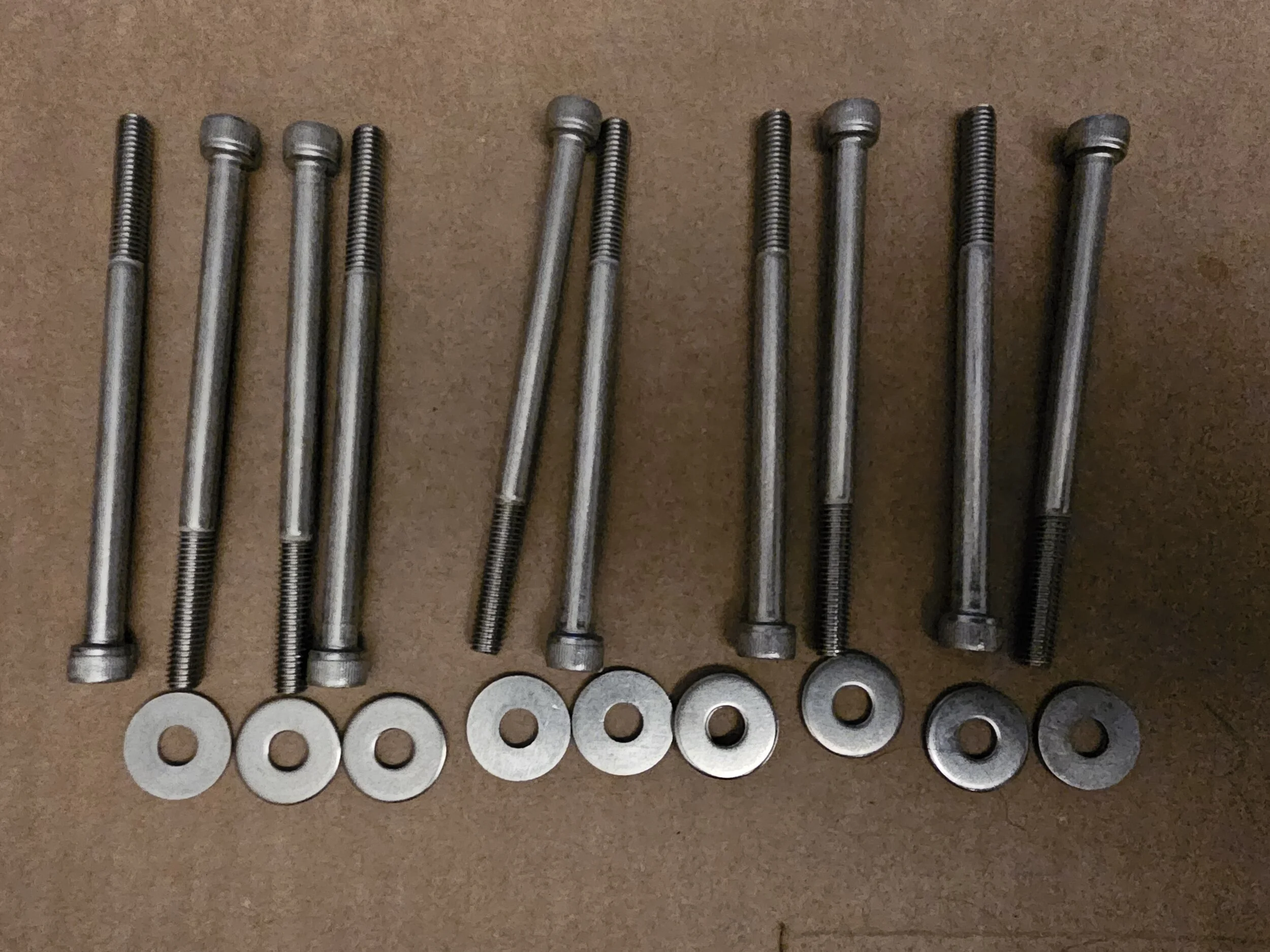

It comes with longer cap head bolts and washers also. Their packaging leaves something to be desired. The bag the bolts were in had busted open and they were loose in the box. Luckily none were missing.
