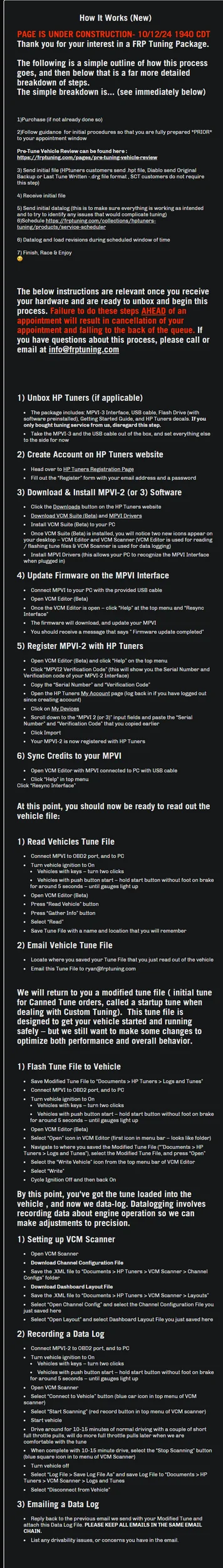

For those of you who need tuning....
https://frptuning.com/pages/how-it-...mKbC69hlv69s1lJcVQ_aem_T8WJ0nCJC3BmZnkHdIipmA

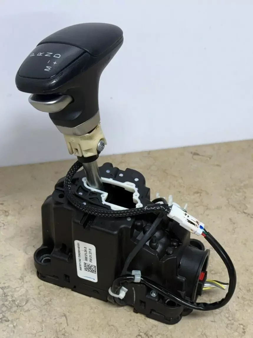

1) Use a JSS (Jeep Speed Shop) kit. Just their wiring harness is $1900 but that includes programing the TCM. You still need a Challenger or Charger shifter

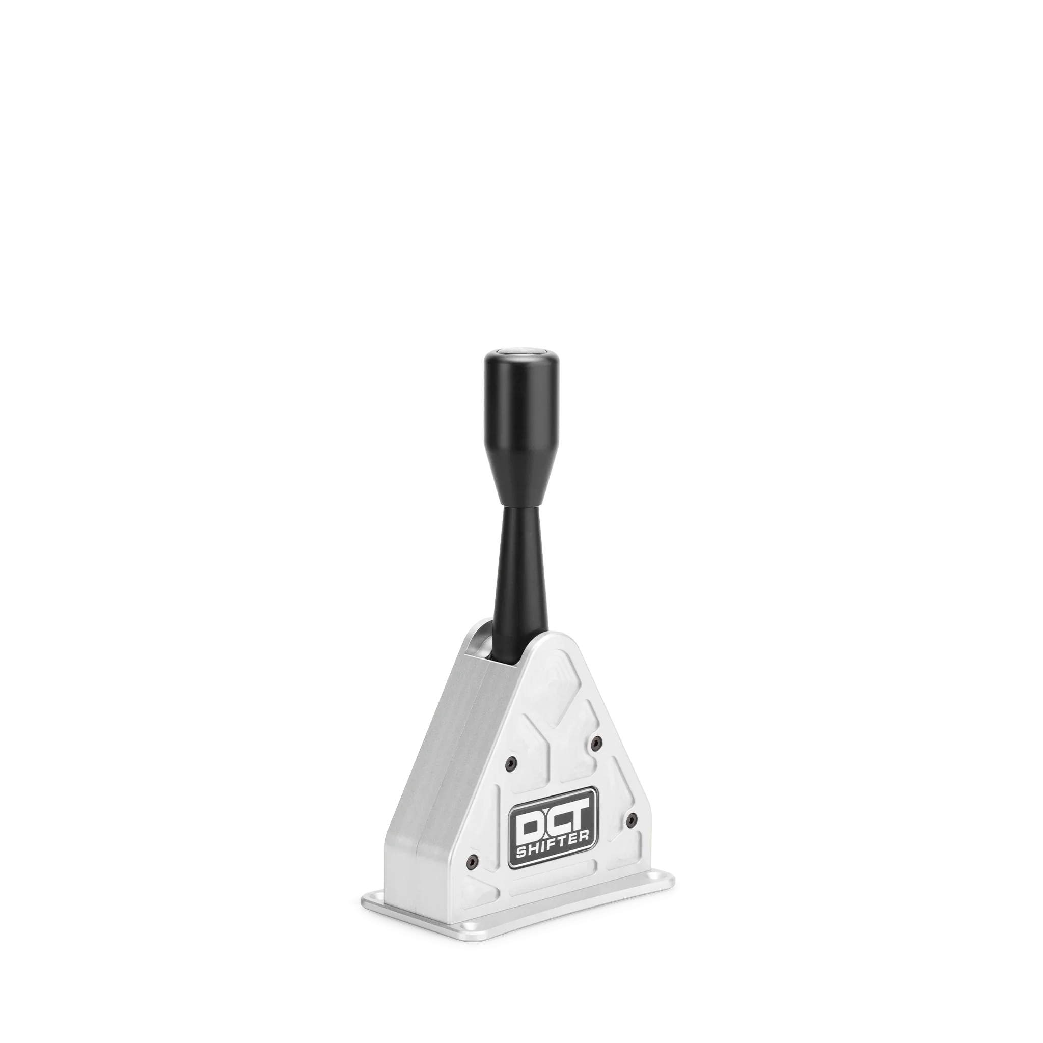

Here's a DCT Sequential Shifter
https://dctshifter.com/products/sequential-shifter-270gt-aluminum
Stock shifter off Ebay is $250

Well I know I won't be the first but I might be the first active member to try it out... The hardest part for me is the shifter but I'm sure with a little time and measuring I could figure out a mount for it. Or I can do the aftermarket shifter... But I'll deal with that if I pick up this used transmission and really start into it.
