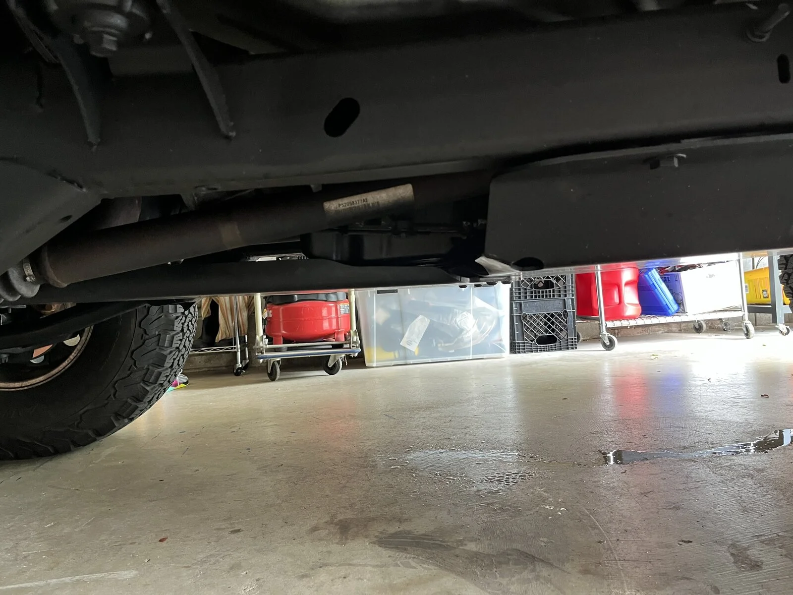

I removed the stock skid plate and drop spacer and installed the UFC Deep Cover Skid Plate System (UCF077) (engine/transfer case). I went with the one that did not require the body lift. I improved the ground clearance about 1-1/2" with this UFC system.
