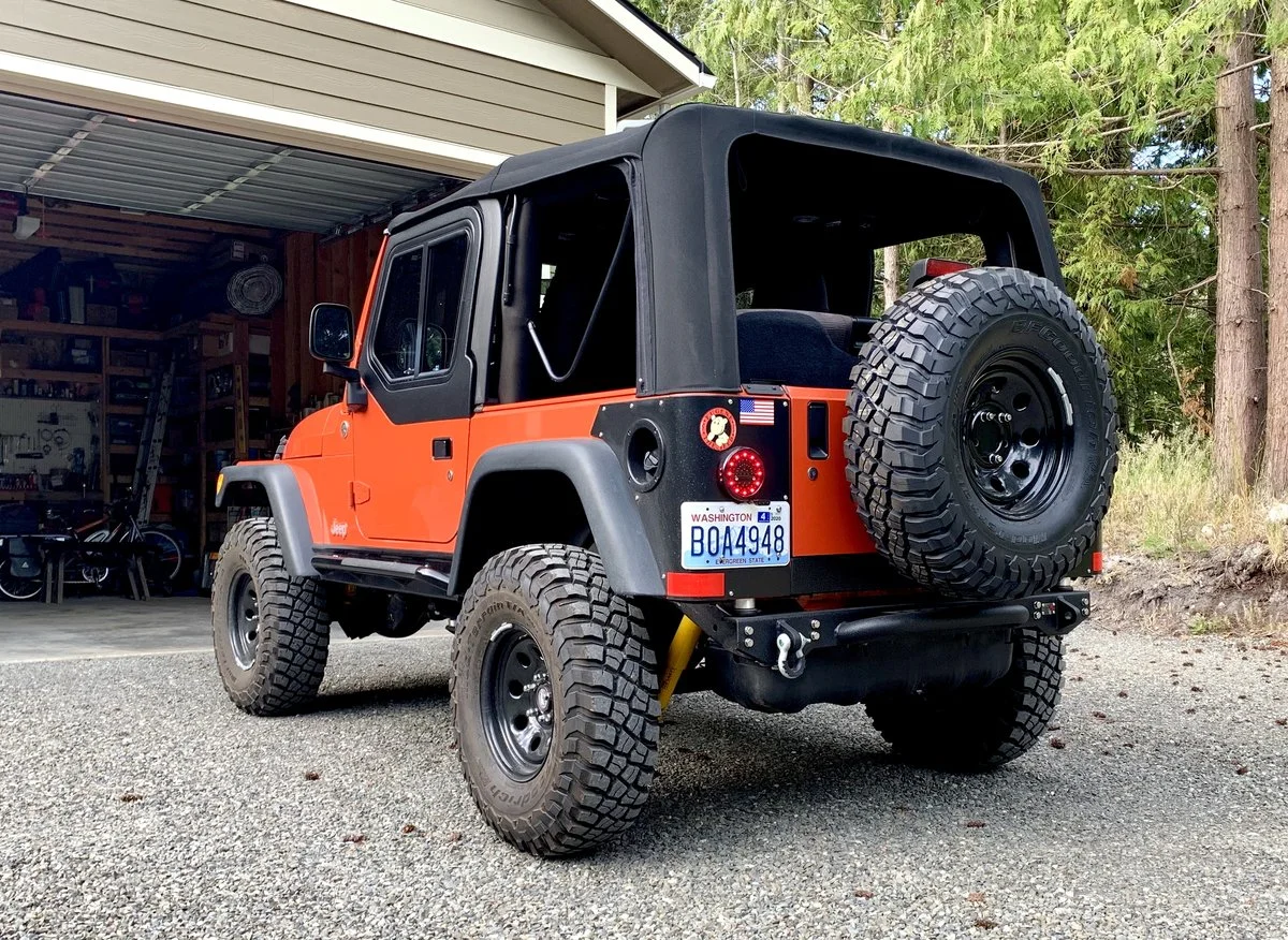

Not sure what size tires you plan to run but the basic 2” OME is good up to 31’s without a body lift. You want to run 32’s then you’ll want to add the optional OME 1/2” coil spring spacers to give you about 2.5-3” of suspension lift. 33’s a 1” body lift will be required in addition to the 1/2” coil spacers. The OME lift comes with a rear track bar relocation bracket which will center your rear axel for the most part. I would recommend you add an adjustable front track bar to get your front axel centered. I have the HD springs on my kit. As others have mentioned they can be a bit stiff if your Jeep is on the light side. Have a winch, HD bumpers and some trail armor then you’ll be okay. The newer OME shocks are valved differently than the older versions. It’s nothing too radical but it is slightly stiffer and not the plush ride of the old Nitro Chargers. They are still an excellent shocks both in build quality and ride performance. This is my 3rd OME kit so obviously I am a fan of ARB products. You may or may not need to add a T-case lowering kit after doing this lift to eliminate driveline vibration. 3” of lift is the point where this problem will start to rear its ugly head.
My TJ with 2.5” OME lift, 1” body lift and 33’s
