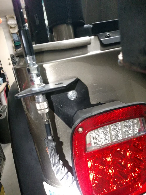

1) Mount a 6 db gain 32" whip antenna on my passenger side taillight using a Teraflex mount. It would mirror my drivers side mount that has the CB antenna.

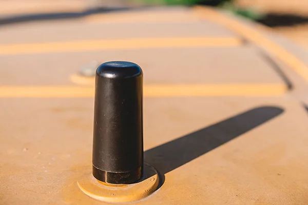

2) Remove one of the hood snubbers and use a 3/8" NMO mount cable with the existing hole and then use a 3 db gain 3.5" snubby antenna on the hood. The 3.5" could be removed and stored easily and a rain cap placed on the NMO mount where it would look just like a snubber.

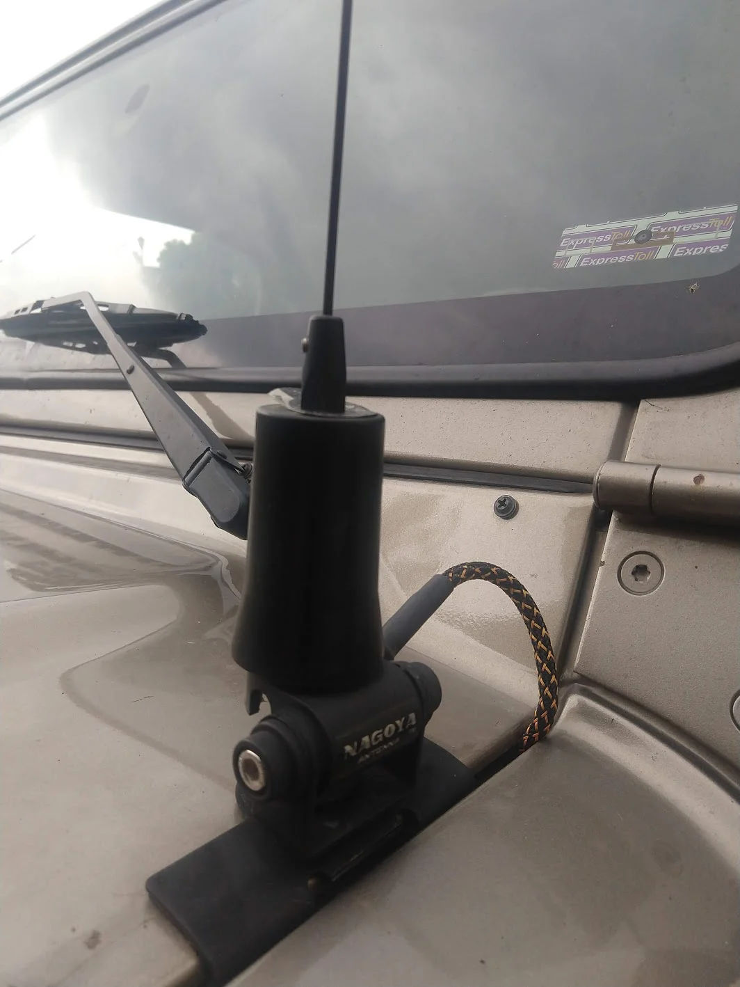

If you mount it on your hood doesn't it hit your windshield/frame when you are wheeling?
The base doesn't have a spring so no it doesn't move around even close enough to get near the windows. Unless, I suppose, a branch hit the upper part it might swing back to hit but that applies to any antenna mount. I have the same setup as @CodaMan and never had an issue. My CB radio on the other side has a spring and that one actually does swing back to hit my soft top sometimes

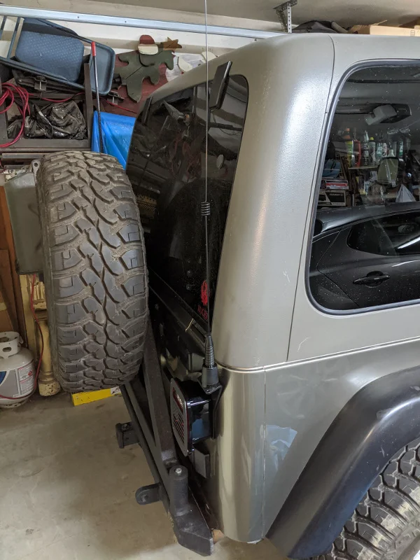

J-bar antenna under the rear roll bar pads. That's how I have my GMRS antenna set up. My radios are hidden so it's an incognito setup.

I used the Teraflex CB mount and drilled it out to fit the 3/8" NMO. Piece of cake.
