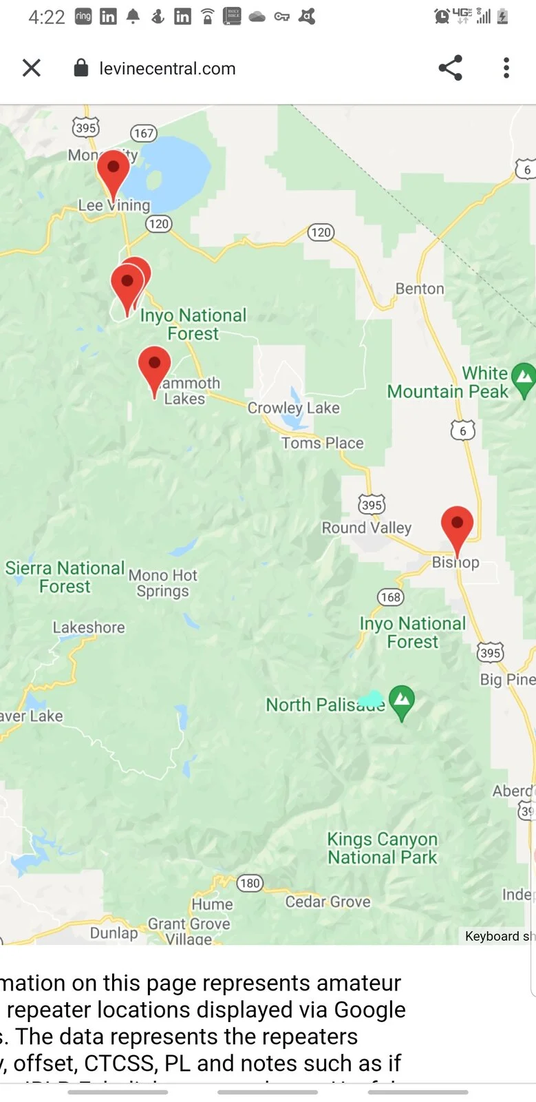

@Jerry Bransford
I still have a lot to learn bout ham radios.
Looking at this map.... how would a ham radio work on the repeater in bishop? Does my experience below sound about right?
There were a couple mtn ranges in between... and i was higher in elevation. Had spotty reception with the bishop receiver... but made it work... recieved weather reports.
Ham did work to another ham for 5 miles or so.
I was in the north palisade area... using a baofeng uvr 5 and a whip attenna.
