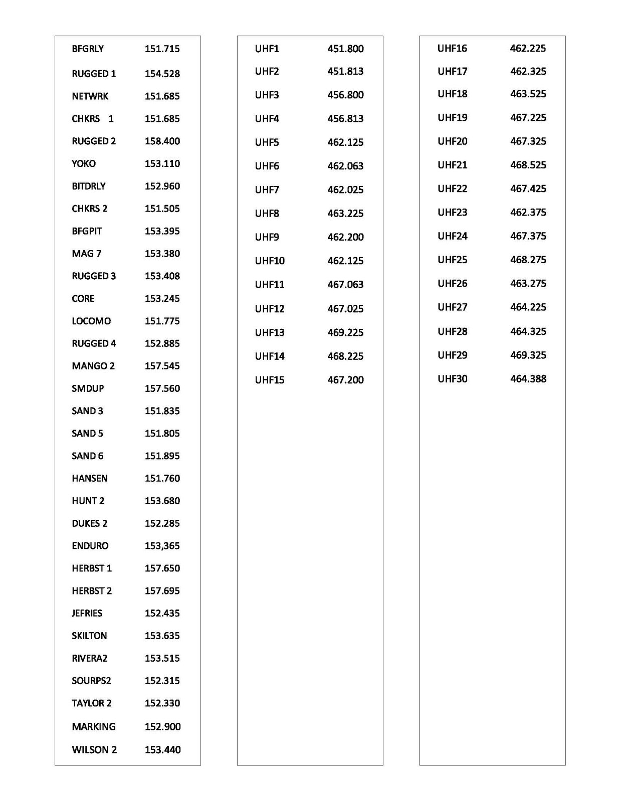

Here is a chart of the current Rugged Radio Frequencies as of 2019.
Minus the channels that don't transmit and weather channels.

I'm pretty new to this whole scene, but those frequencies are all scattered throughout the normal GMRS & MURS channel range, but it doesn't look like any of them match exactly with those frequencies. Like they exists between the GMRS channels. I would expect interference if somebody were using one of these and a GMRS user was nearby (both physically and frequency-wise). No transmission happens PURELY *on* the frequency; there is always "bleed" into surrounding frequencies (or put another way each transmission has a bandwidth), and the channel spacing is in part because that well-defined bandwidth. If you are operating in between 2 GMRS channels, there's a decent chance that you're inside the bandwidth of another channel.
Or so I would think. Maybe the spacing is wide enough and the bandwidth narrow enough that it's not a thing. Or maybe privacy codes resolve it.
Looks like a good reminder to never buy one of their radios. Also spread the word so others stop buying them.
lol, can't tell if you're being sarcastic or not! Honestly I had never heard of them prior to this thread, so I have no idea if they suck or what. But most every other radio in this space is either completely programmable or has channels that correspond to the standard GMRS channels. So that list that was posted seems weird.
