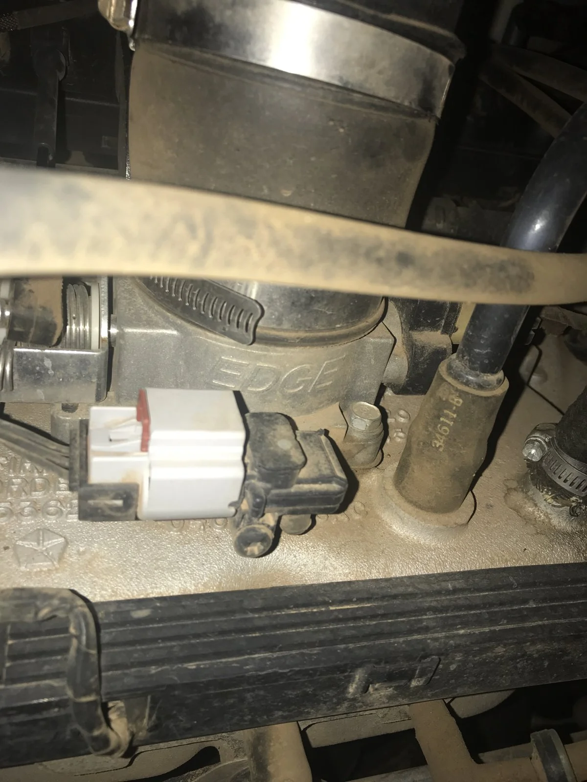

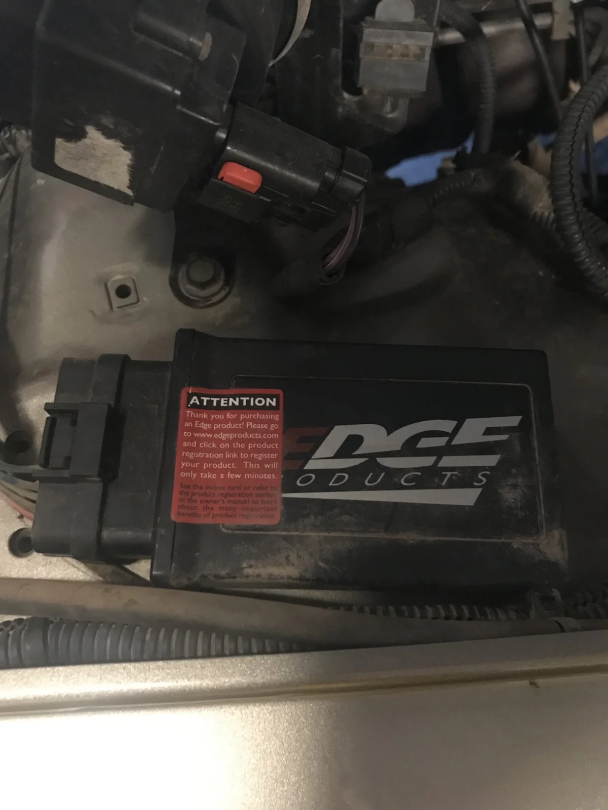

The PO had a Edge Preformance Trailjammer installed(I think), throttle body, electronic module, etc. Should I go back to the OEM air intake? Leave the throttle body and electronic module and OEM air intake, if possible? Scrap it all?
I’m aware of the problems that these aftermarket filters present. Trying to come up with the best course of action.

Put the stock air box back on and get rid of all that crap. No idea what in the world that module "claims" it does, but I guarantee you it does nothing at all other than take up space. First time I've seen something like that, but I'd remove all of it for sure.
It's been proven that air intakes on the 4.0s do absolutely nothing for engine performance. The factory air intake on the 4.0 is simply not a weak point to begin with, hence the reason no power can be gained from a different setup.
Remove it all I say! As much as I hate to say this, some sucker will probably pay decent money for it. Not that I want to see another TJ owner get ripped off, but some people just have it dead set in their mind that "cold air intakes" DO make a difference... and I guess if someone wants to pay for it, then whatever!
Is it as simple as removing all that crap and just bolting back on the OEM? Does anything have to be reprogrammed? The rig is going to the shop on Monday should I have them do it? Is it a simple fix?

Yes, it is that simple, and no reprograming as far as I know. Didn't need programing on my old 97 tj, and didn't need reprograming on my 06 tj. I like stock stuff. You can probably find what you need on your local CL site, unless you want to go new.

You can leave the Edge throttle body in place after removing its electronic control module, it won't help or hurt performance. Edge sent me a kit to try out and after installing the TB, discovered their module connector wouldn't fit my early '97. I left their larger 58mm (IIRC) TB in place but noticed no performance difference.
Run the OE air intake system. It is absolutely not restrictive and can easily flow more air than the engine can draw at redline rpms at WOT.
