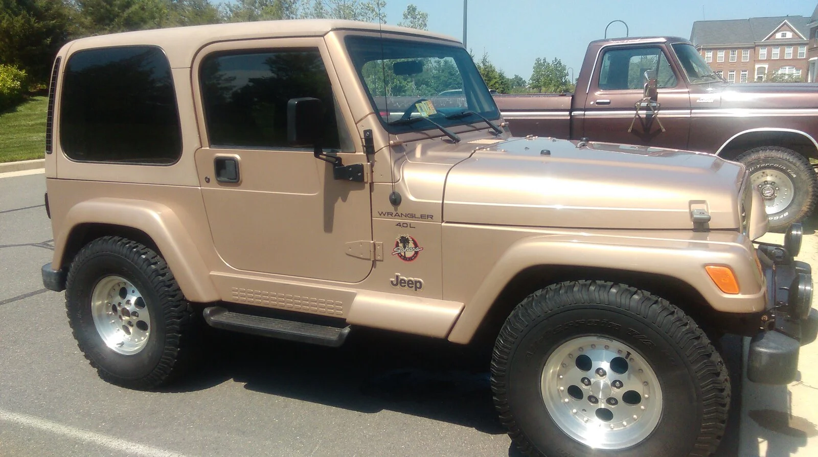

Hi everyone,
I recently acquired a 98 TJ Sport 4.0L I6 5-speed with about 143K miles. She runs and drives with no major issues other than the fact that she handles poorly when at high speeds and while braking. The jeep came with a 4” skyjacker lift and shocks + 33” bias ply MT’s. I swapped out the tires for BFG Ko2’s and also had my mechanic swap the steering damper. These 2 adjustments helped a little bit where I am now able to take the jeep up to 60-65 on the freeway but soon as I get to 70 she starts to vibrate a bit on the steering wheel and sorta the seat. I’ve read through some of the forums already regarding this topic but can’t seem to find the answer that suits my issue which is why I created a new thread. I’m thinking of going back to stock height (keeping the 33’s) using Moog springs 3224 and 3229 (suggested by moog) and Rancho RS500X shocks. I’m not sure what else would need to be changed or if anyone has any advice on improving the handling and stability and if going back to stock will help with that?

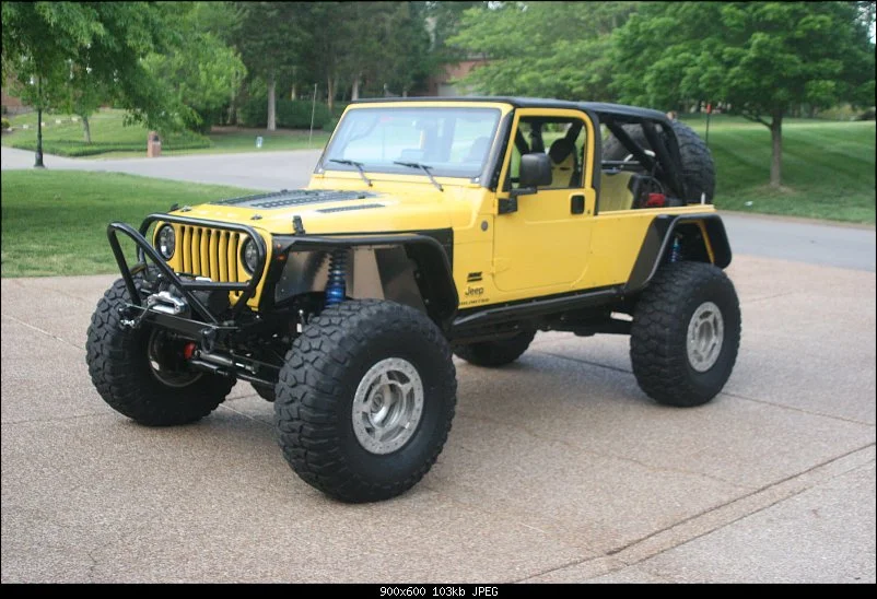

You can't go back to stock height and keep the 33s (PIC). You just need to figure out what the problem is. Lowering it might not fix the issues. You might just need to replace some worn parts like tie rod ends, ball joints, Skyjacker control arm bushings, etc.

I balanced tires when I got them ~200 miles ago and also got an alignment - this helped a little went from staying at 50-55 mph on the freeway to 60-65 mph and its not as scary anymore, however, I still get some sway at high speeds and while braking - the jeep wants to go right or left its super weird. I know the shocks and coils are pretty worn (they look it).
