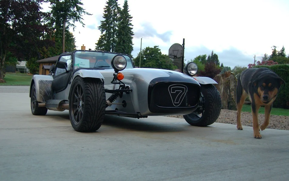

2 major things affect ride. Sprung/Unsprung Ratio. So adding weight to the Jeep, ie winches, bumpers etc while reducing unsprung weight, ie alloy rims and lighter rubber will both improve ride. And sidewall flex. That Lotus won't ride near as smooth as a Lincoln. And a Jeep with 325/65/20sLRE won't ride as nice as a Jeep with 35x12.50x15sLRC.
Was that 500kg Lotus a Seven ? Cuz this rides like a skateboard. Even when we add 500# of people.
