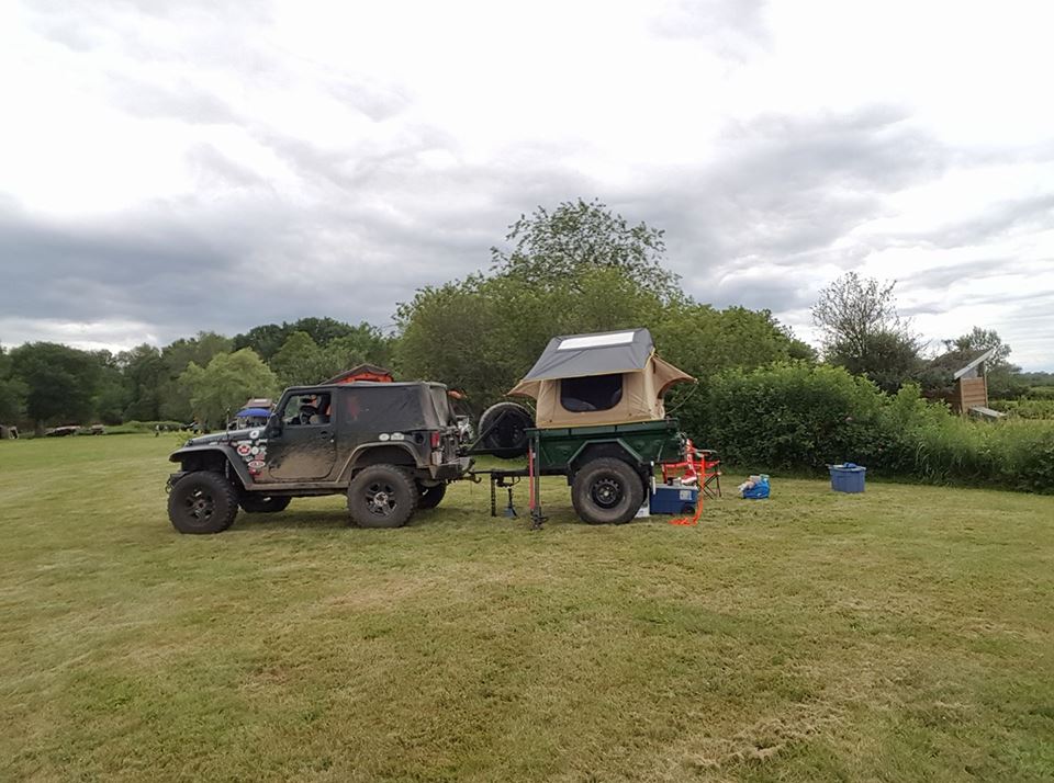

This is one of my buddies setups.
I agree. The M416 box dimensions are generally 6'Lx4'Wx1.5'H which is plenty of room for most camping trips. I had a line on one for $1,200 CDN (about $900 USD) so the prices are good. It was in great shape and the guy, a JK owner, had already swapped out the axle for a current one with brakes and Moab wheels. I was very tempted but was already too far into a build of my own - box is 1' shorter, same width and 4" taller. One thing about the M416's is that most (all?) don't have a tailgate. They're meant to keep the water out. A lot of guys build one in which, I think, makes them much more versatile.
