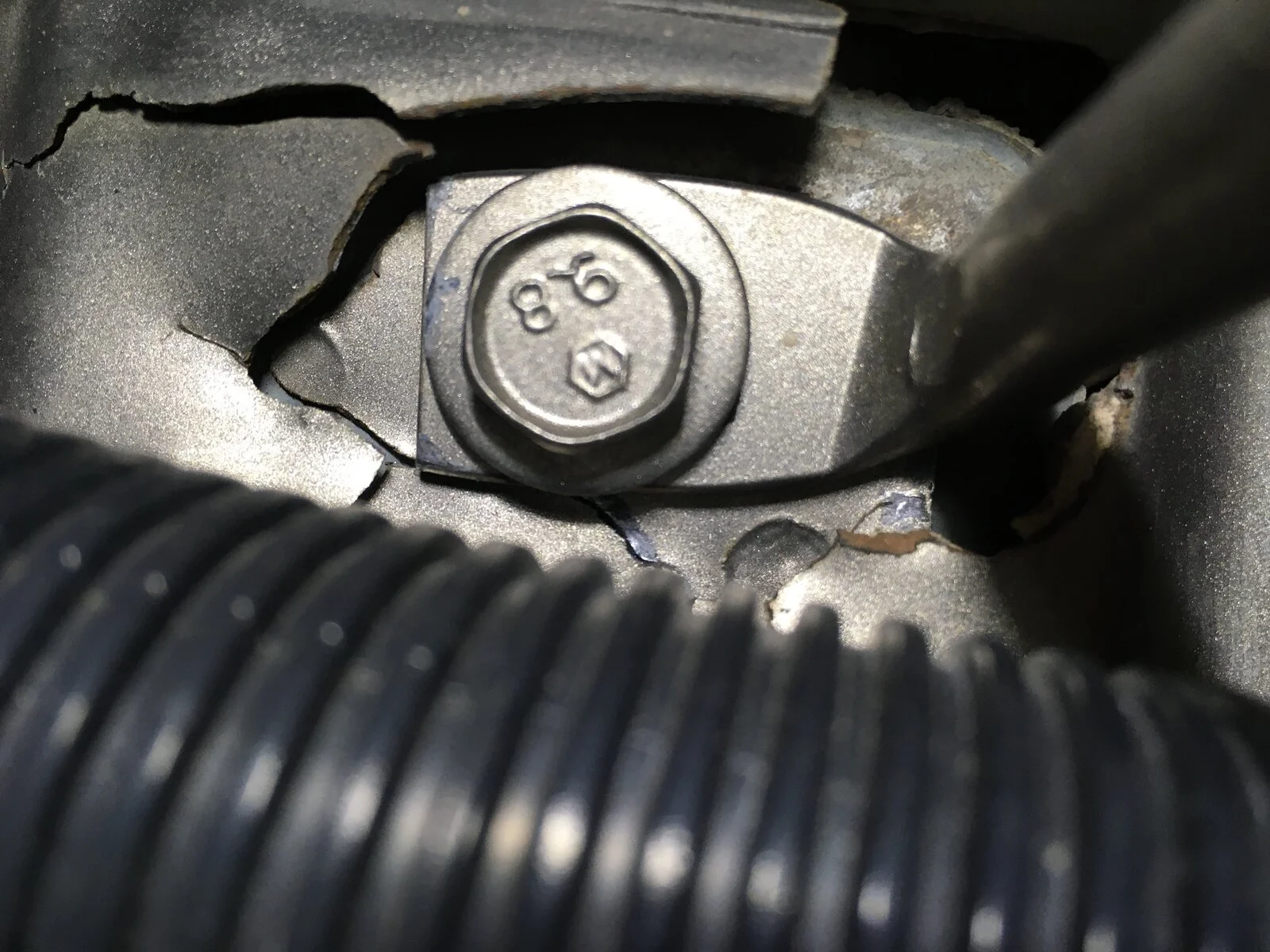

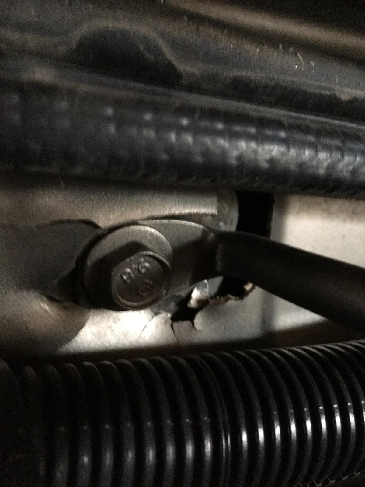

Grill Support Rod Broken at Firewall
Bonus Coyote
Apr 4, 2021
5
SD
the grill support rod on the drivers side broke through the firewall. This is the cause of a nasty rattle that seems to be coming out of the dash. Jeep is new to me, so I dont know if there was previous damage. if there was, the body work was pretty good to cover it up. I have seen some posters suggest just eliminating the support Rod. others think that is a bad idea.
Is there a process to fix the sheet metal on the firewall and re-attach?
2004 Rubicon..
Thanks in advance for ideas.

ya nutsert will put threads back so it can be bolted back on .
but how'd it bust through, is it rotten? how big is the hole? is it gonna require a patch b4 you can fix the rod?

At one point several folks on JU bolted their hi lift jacks across the support rods to keep them out of the weather. Shortly after they all removed them when the end of the rods broke the section out of the firewall where they attach.
that sounds like the problem need to deal with. (dont know it that was the cause, though). any idea how to fix firewall after that break that section?
You can fix it in a manner of ways ranging from complex and correct that will last to down and dirty that will last. Pick one.
