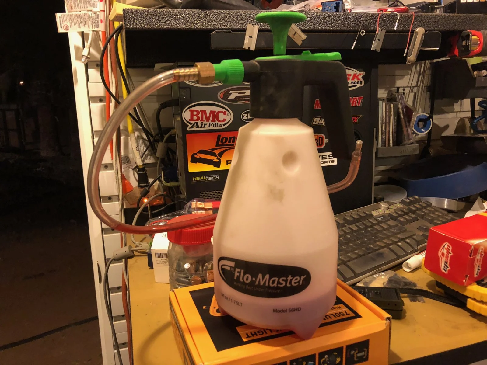

@Matt77 I made this to fill my trans fluid our of a week killer bottle

I built my own because those cheap ones leak and the bottles crush while you are pumping and they are soooooo slow. Mine you pump it about 10 times and pull the trigger. You won't fill it the first try, but you can pump without crushing the bottle and you pull the trigger to let the fluid go in.
Anyways just wanted to share in case anybody was interested. I think it cost 10 bucks to make and it hangs on my tool shelf and is re-usable.

I'd buy one of those if you made them haha. I have not found a good long-term solution for refilling differentials, t-cases, etc. which frustrates me to no end. I've bought several types of pump style fillers that screw on top of the bottle but as you say, they're slow and invariably something happens where it spills on the ground. I don't do it enough to spend big $$$ on it but often enough to be frustrating.
Haha, maybe I should start an Etsy store?

Yours look way easier to use than the old school suction gun I use. Mine is the type that looks like a grease gun. Works but messy.

Mine is clean I do put a pan under the the trans and transfer case, so when it gets full and over fills it can run over into the pan.
