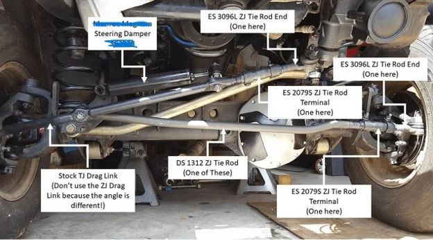

Steering
Jeep ZJ tie rod upgrade. Thicker component upgrade. Simple bolt on replacement, no modifications needed. Photo provided from another thread.
  • Moog ES3096L – upgrade left outer tie rod
  • Moog ES2079S – adjusting sleeve
  • Moog DS1312 – upgrade left inner tie rod
  • Moog DS1430 – OE TJ draglink / connecting tie rod
  • Moog ES3096L – OE TJ tie rod end at pitman arm
  • Rancho RS5000 steering damper

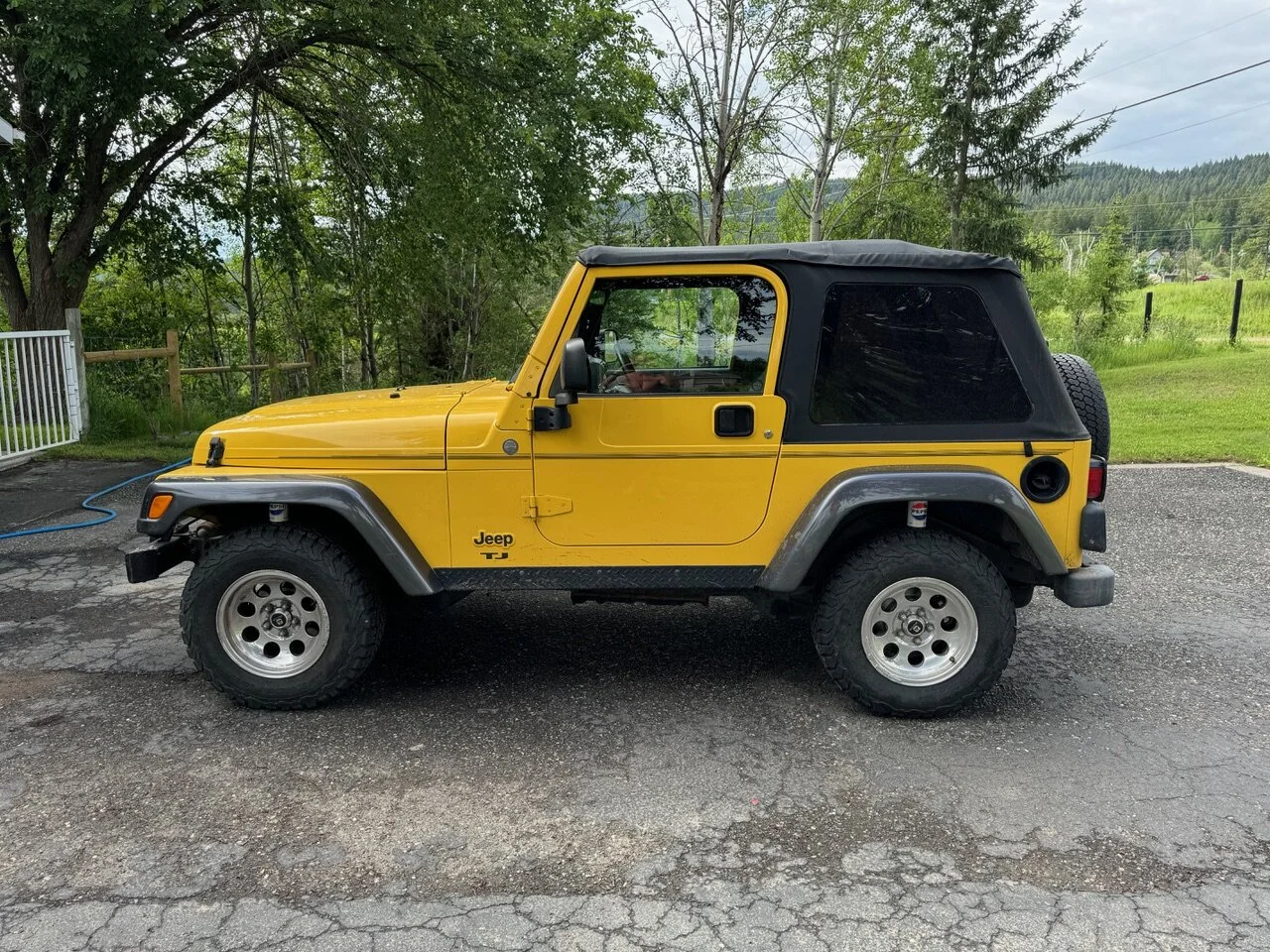

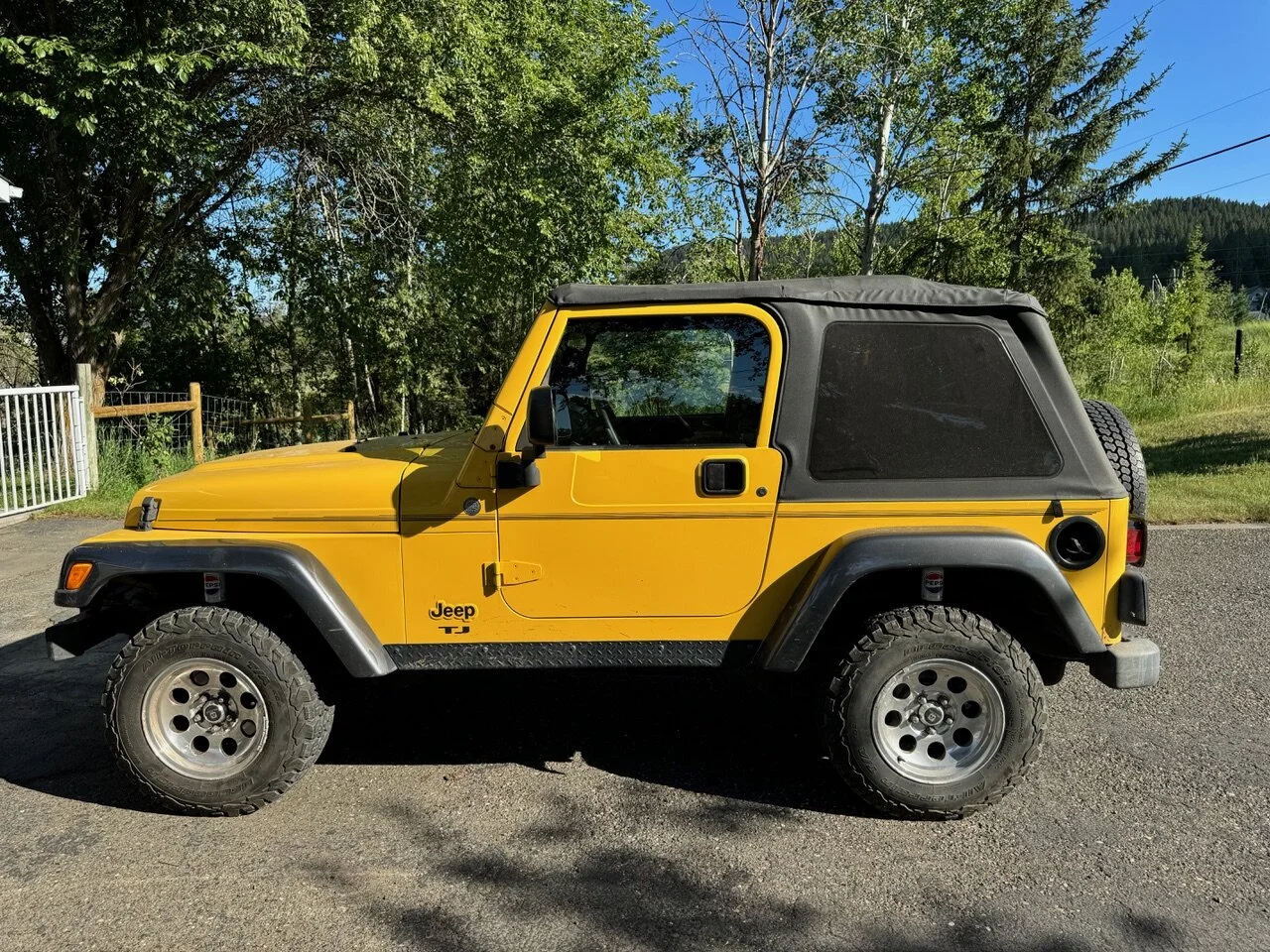

Front 1-1/4"
Rear 5/8"
Front Bumper 1-1/2"
Rear Bumper 1/2"
Before
Take notice of the Pepsi cans.
After
The Jeep nearly sits level now. Rear seat in with Bestop soft top both before and after. No additional weight.
I have only driven for roughly 15km (Canada) since the upgrade. Very minor off roading for a few km only so far, but initial impressions are a nice improvement in feel.
