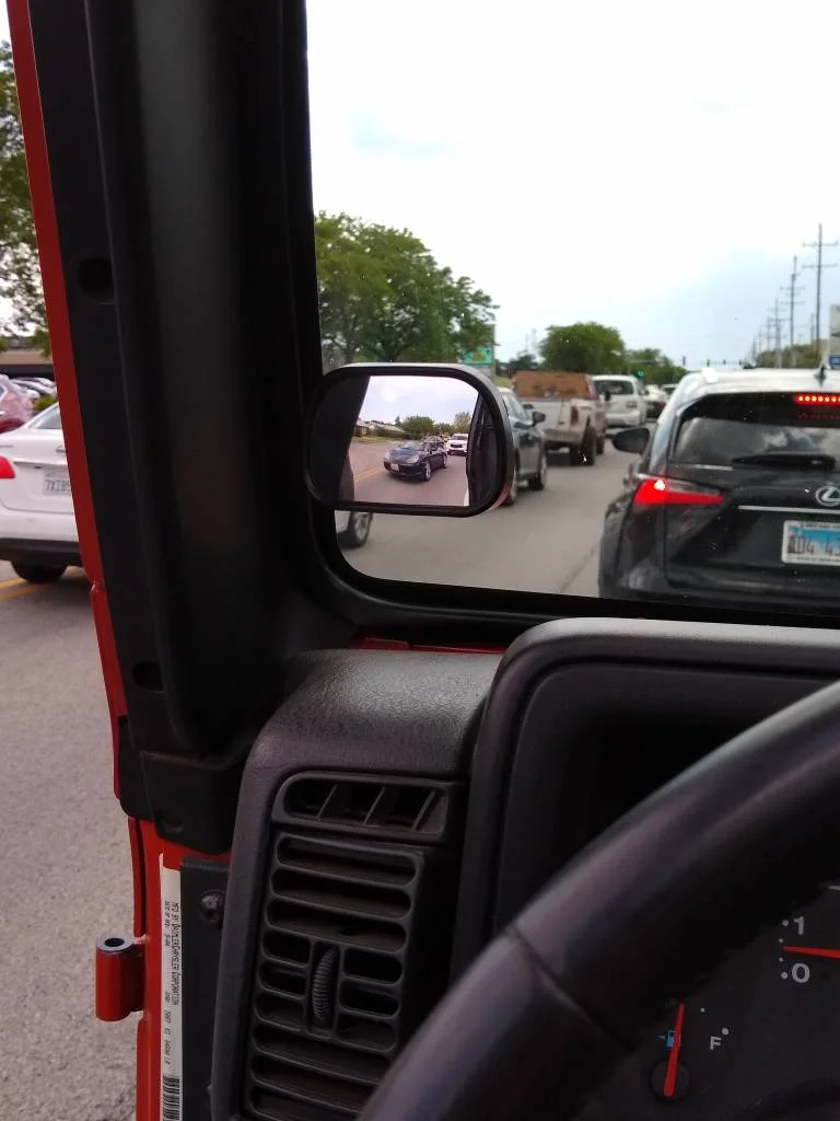

I picked up a pair of wide angle mirrors that mount via suction cup. They are supposed to be for keeping an eye on your baby in the back seat of the car. I suction them near the lower corners of the windshield on each side of the Jeep (on the inside) and they work great. They don't interfere with the doors, and they even serve as a bit of a wide angle mirror with the doors on. I can try to grab a picture today when I leave work.

These probably aren't technically legal, but they work. I've never had any trouble from the law, but I'm in Chicago, where they might not pay as much attention to such things.
We're lucky in Illinois. By law, we can remove the side mirrors as long as we can see at least 200' behind the vehicle with the rear view mirror.
Depending what part of New England you live in, @Krissie, you might save yourself a few bucks by going without — unless you prefer having them on. I will admit: it took a little time for me to get used to not having them!
Reactions: -T.
@-T.: you live in my old neck of the woods! I wonder if I’ve seen you on the streets! (y)
Just moved into the suburbs recently, but have been in Chicago in one Jeep or another for many years. I'm the guy driving around with goofy mirrors stuck on his windshield. [emoji6]
