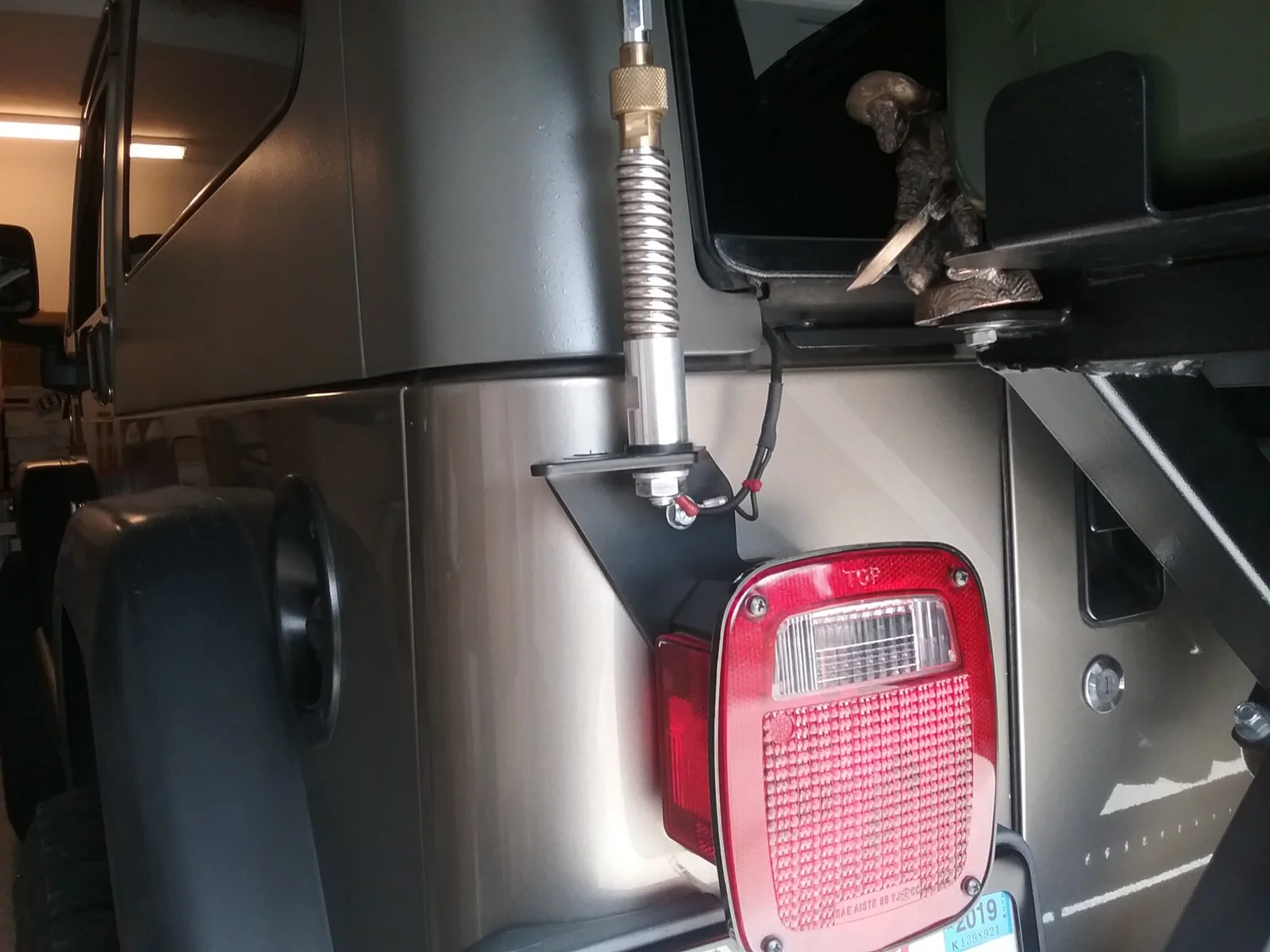

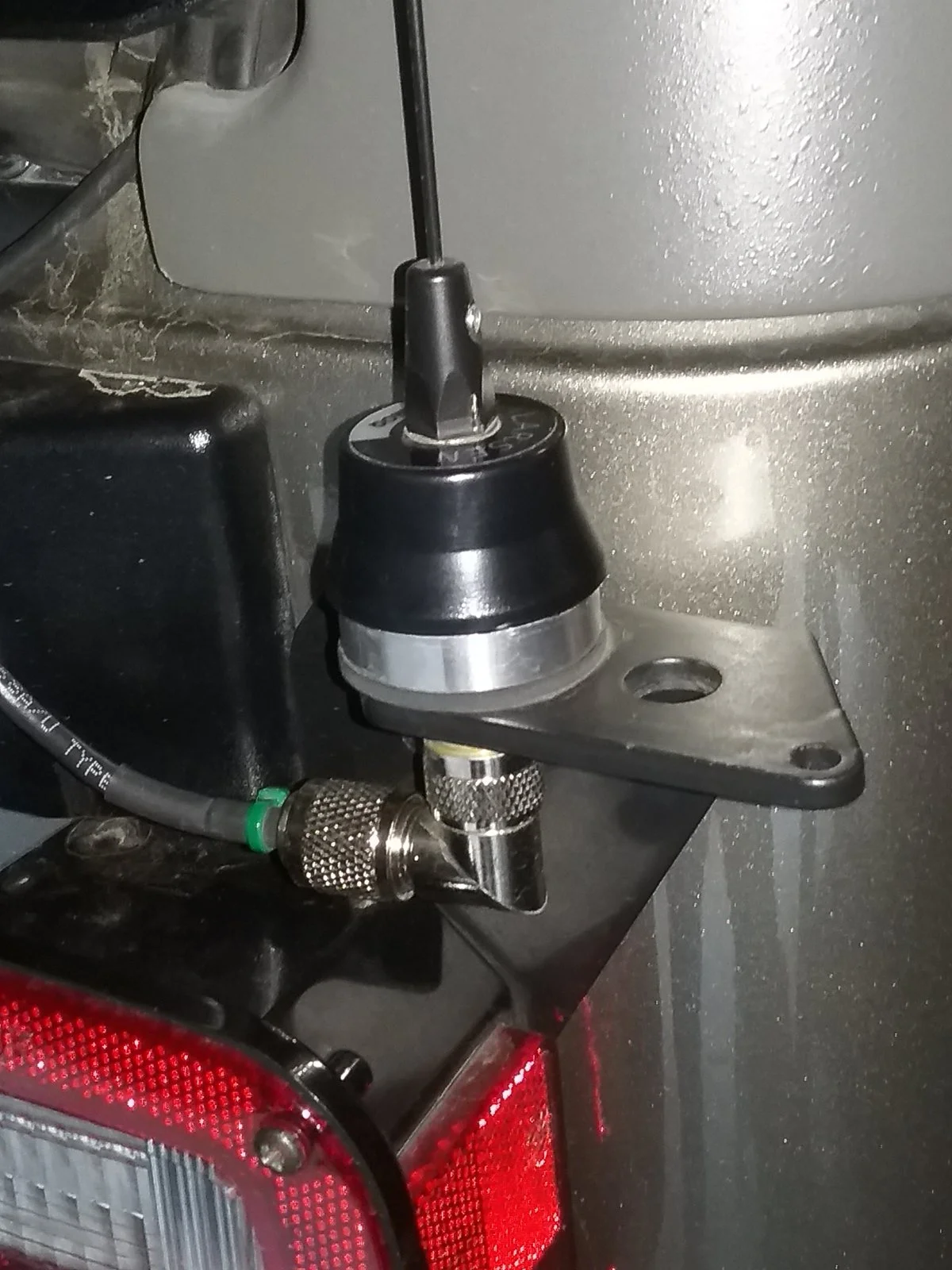

I use the Teraflex tail light antenna brackets on both driver and passenger sides, one for CB and the other for 2m. (I no longer use a spring for my CB antenna - it is unnecessary for the 2' Firestik II and 4' Firestik Firefly antennas I use.

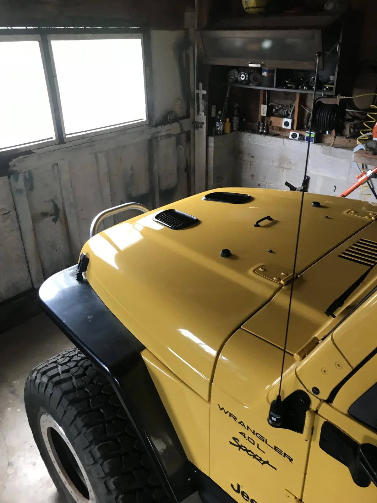

I will be doing something similar to the above pictured Rugged Radios windshield mount. (I will be welding a bracket off of my mirror relocators for the antenna.
Does this make a difference in what antenna I should use? NGP vs GP?

NGP antennae’s are designed for mounting to fiberglass tops, camper shells, thickly coated metal surfaces and vehicles with little or no metal for a ground plane, like a boat or a motorcycle.
