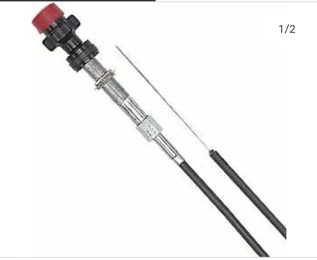

I was looking for an idea for a hand throttle , and found one by Buyers Products called a Vernier throttle ..you can pull it in and out , it locks in position and has a quick release button , and the cool part is you can turn it left it right to fine tune rpm also.
This is the same concept as a very small aircraft throttle without the cost.,like McFarlane sells.
Let me know what you think, couldn't attach a link.
This is the same concept as an aircraft throttle without the cost.

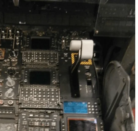

What do you mean by an aircraft throttle?
This is one I am most familiar with.

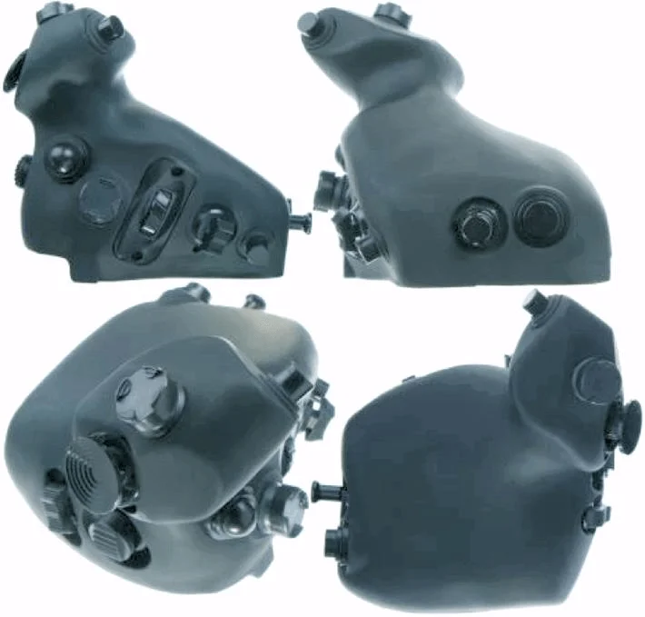

Aircraft throttles rule! Here's the one I play with sometimes, think about all the options!

My apologies for no link , these are simple , almost small engine type .
They pull out , you twist to lock , and you can dial it up or down ...that and the gear shift attachment seems to make a perfect combo.
Useful for stationary use like raising the rpms for more alternator amps etc. but it wouldn't be a good choice for use on a difficult offroad trail. A spring loaded hand lever like a bicycle shifter is what you want for better/smoother/more controlled throttle control while on the move in 4Lo on a bumpy technical trail. Which can also be used to raise and hold the rpms in stationary situations too.
Got ya . I was under the impression that these were indexed and set at certain positions, sounds like they need to be active like an ATV thumb throttle.

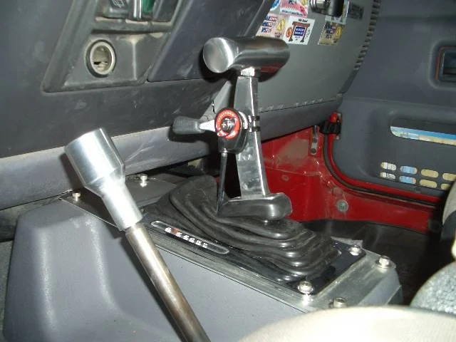

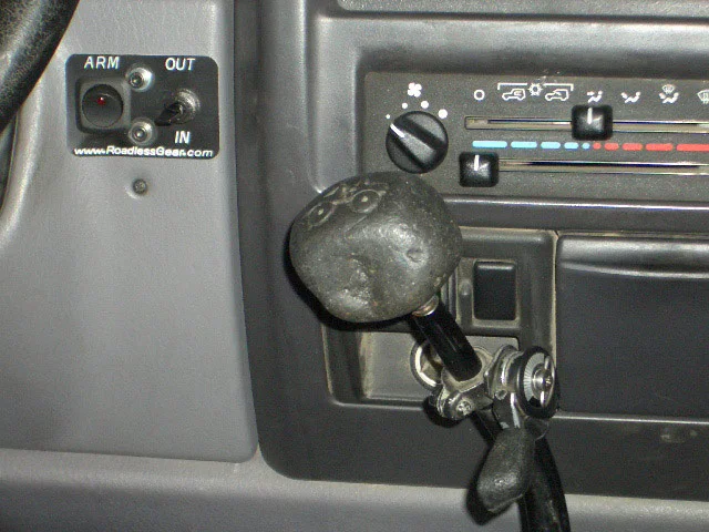

This one?
Useless for offroad use while driving.
If you want a hand throttle usable to provide you with steady throttle control for better control while on a tough/bumpy trail this what you want.
The first photo is of my first TJ's manual shifter, the other is on the same TJ's automatic shifter after the conversion. This location allows the hand to rest on the shift knob to keep it steady while controlling the throttle.
An improperly positioned foot bouncing on the gas pedal while on a bumpy trail can cause shock loading and broken drivetrain components.
If you want a hand throttle usable to provide you with a steady throttle for better control while on a tough/bumpy trail this what you want.
The first photo is of my first TJ's manual shifter, the other is on the same TJ automatic's shifter after the conversion. This location allows the hand to rest on the shift knob to keep it steady while controlling the throttle.

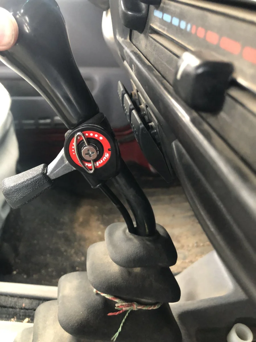

I'm using the terraflex one. It'd be cheaper to build your own but I had a little cash burning a hole in my pocket. Easy to use and very functional for reasons already listed
Reactions: reddvltj
After a recent outing I am set on a hand throttle. The only ones I have heard of are the Teraflex model that many people copy with parts from a bike store. I'd like to know if there is a better option.
I have the Teraflex cable and it has really saved my bacon a few times. I wouldn't hesitate to buy it again if I started over from scratch.
How did you secure the other end of the cable to the throttle lever bracket? My two lever kits came from Rubicon Express and their cable mounting bracket design was great. They no longer make them and I haven't seen a similarly useful mounting bracket from anyone else.
