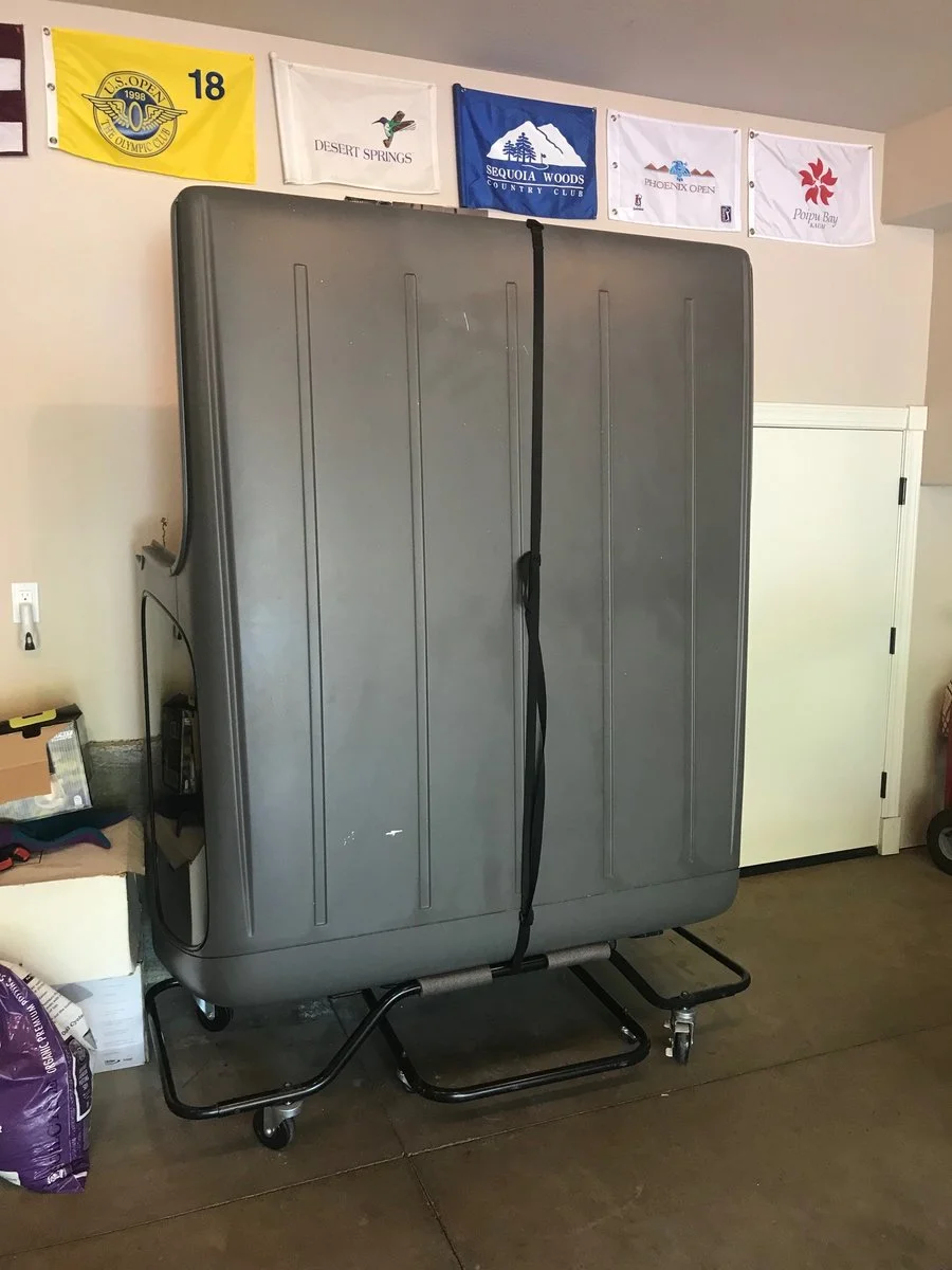

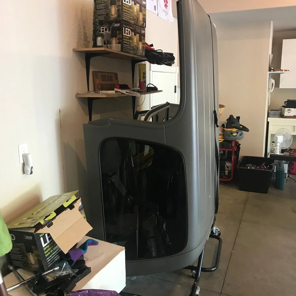

For me, a big deciding factor would be storage. As much as I would like a hardtop, I have nowhere to put it when the weather gets warm. If you’ve got a perfect spot for it, I think it makes the decision a lot easier. Factory wiring would also be a consideration for me. It’s might not be just plug and play.

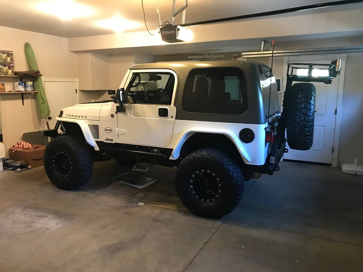

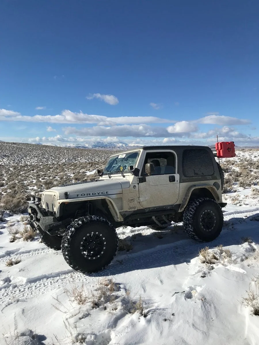

Winter and summer pictures, I was lucky enough that when I bought my TJR it came with a hard top and a brand new factory soft top still in the box. I have since bought 1/2 doors and a Safari Top. My hard top and full doors will be going on next weekend and will be on until spring. I agree if you can find a LJ hard top I would be all over it, worst case you can always sell it w/o a loss.

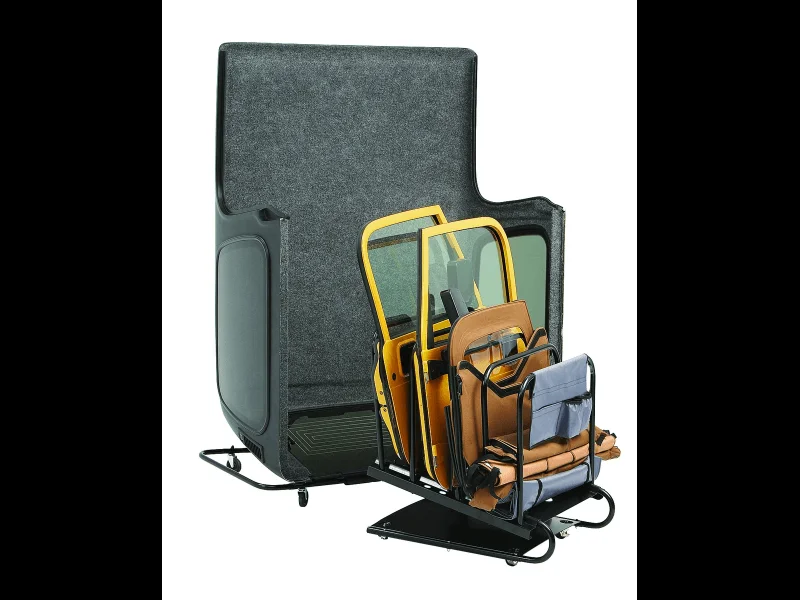

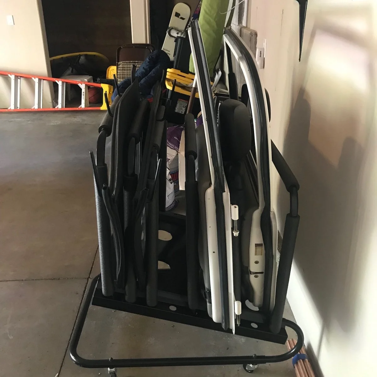

Also storage for me is not a big deal I have a deep garage and use the Hoss Rack System from Bestop. It will hold both sets of doors and windows for the half doors. The rack fits behind the the top stand
