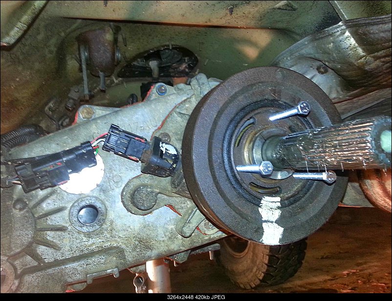

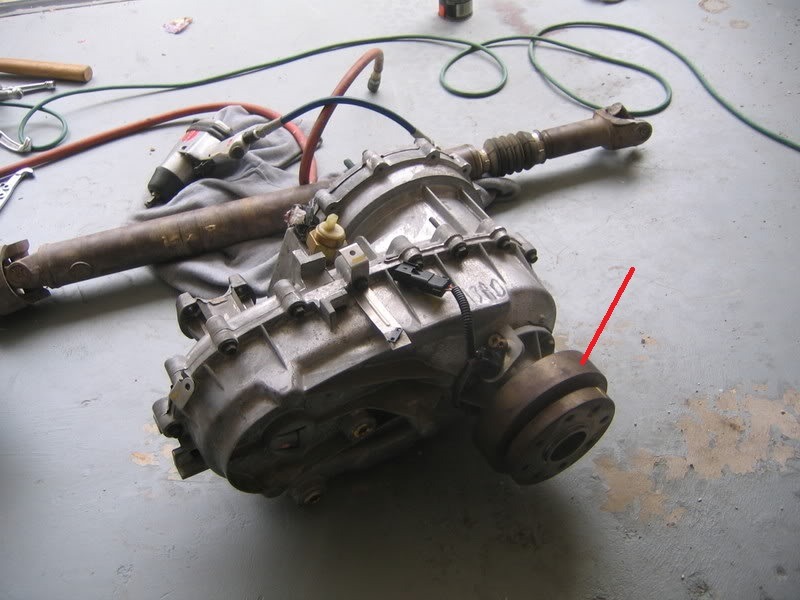

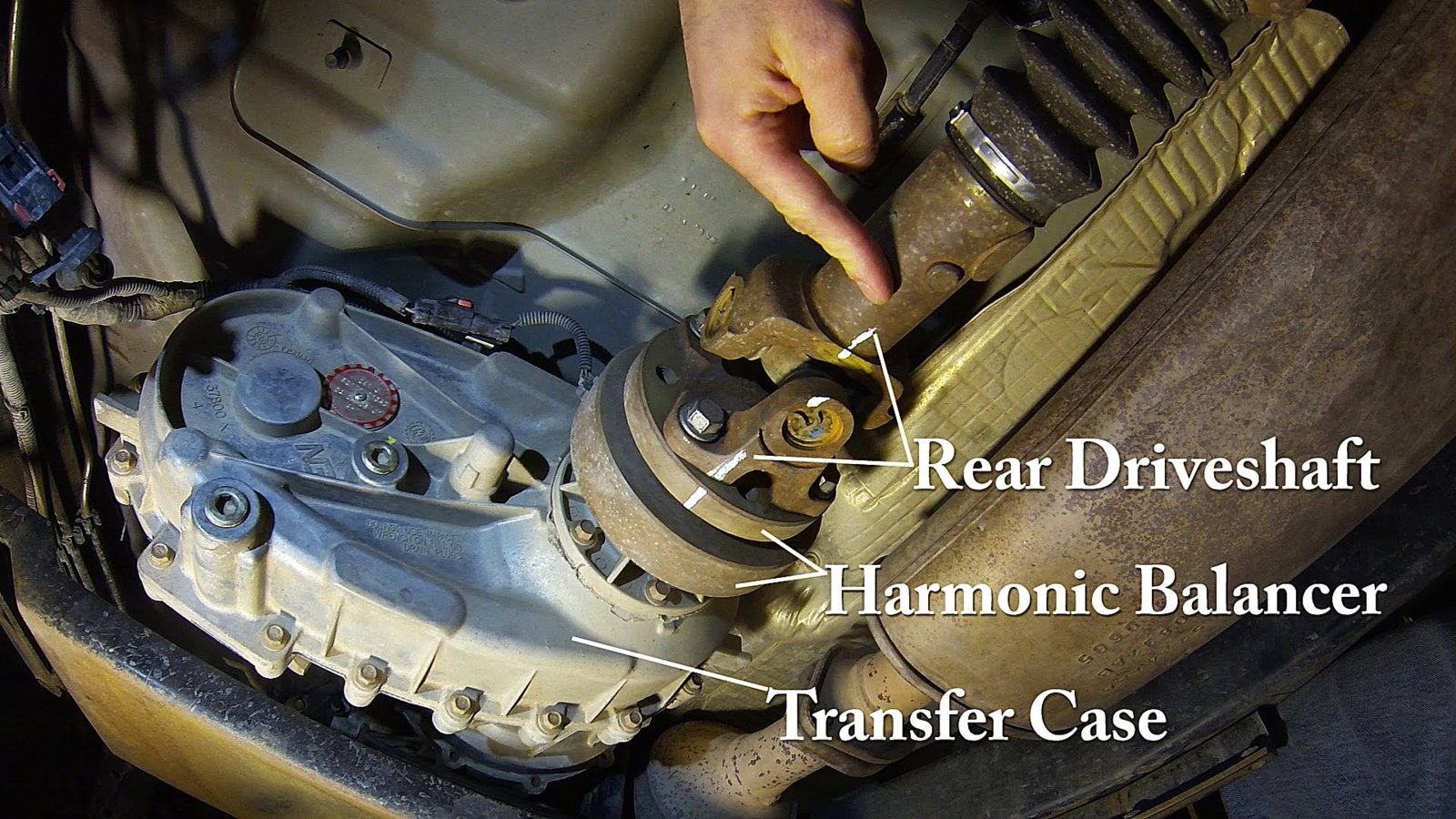

Our Jeep Transfer cases also come with such harmonic balancers. Both the 231 TC and the 241 TC have these. Below are pics to show them visually (top two are 241 , last one is 231). Removing this balancer while installing a SYE or aftermarket driveshaft could be very risky thing to do, in my opinion. The factory went to great lengths to put it there and we risk vibrations without this component. This is a really important to think about. Better driveline angles and stronger driveshafts are important, but equally important is this balancer and no one seems to think about removing it!

You might be asking me how the vibrations went away after removing the balancer in that guy's case, or that why you don't have a problem in your jeep with or without the balancer. I will try to explain how. I believe that this is not a magic, unexplainable problem but that each Jeep being different, they each have a variety of things happening at the same time making the problem difficult to communicate and comprehend.
Note that the problem is indeed nuanced. First thing, the gear ratio matters since going to deeper gears you tend to see this problem sooner. Second thing, you may have other aftermarket mods that may be actually helping you. With deeper gears, now the driveshaft is moving at a frequency that is closer to the natural resonant frequency of the system. In our jeeps (specifcally 03-06), the TC skid has a resonant frequency that is already close to the normal driveline vibrations. So, the faster the driveshaft is spinning (with deeper gears), the more prone you are, to setting this resonant vibration in the system which you hear and feel inside the tub. See the comment from Jim Frens (prev owner of Nth degree and ex-Jeep engineer, very knowledgeable guy) on the topic of vibrations in jeeps on a different forum (emphasis mine):

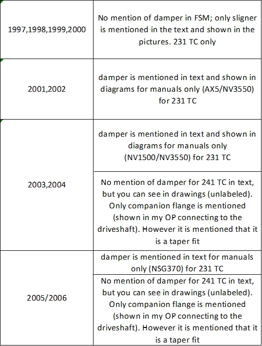

NEW FINDINGS 11/2/2018
  1. The harmonic dampener is added to help curb 55Hz frequencies (as told by the production engineer himself on another forum).
  2. From reading the FSMs for all the years, this is what I gathered:
    • 1997,1988,1999, 2000 jeeps - no balancer in autos or manual trans (they all had 231 TC)
    • 2001-2002 - damper only on AX5/NV3550 manual trans only, auto trans did not get it (they all had 231 TC).
    • 2003-2004 - damper on NV1500/NV3550 manual trans with 231 TC and 42RLE automatic trans with 241OR TC. No damper on 42RLE automatic trans with 231 TC.
    • 2005-2006 - damper on NSG370 manual trans with 231 TC and 42RLE automatic trans with 241OR TC. No damper on 42RLE automatic trans with 231 TC.
  3. All 2003-2006 jeeps have the same TC skid (Rubicon and non-Rubicon models)
  4. Forum members have confirmed that 32RH jeeps in 2000/2001/2002 do NOT have the balancer.
  5. FSM only mentions 4.0L models in any of the years they put the balancer on. 2.5Ls are not mentioned in any of the years.
Given this info, I postulate that there are 4 variables to be used in figuring out if your jeep has a balancer (and is therefore prone to resonant harmonic vibration). The combo of Year+engine+TC+trans+axle gearing tells you the information. I will post a good table inside the thread later. @Chris is helping me with it.
