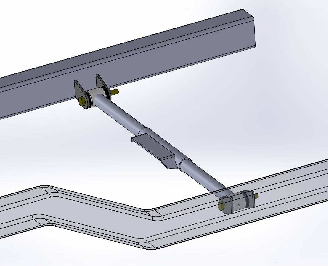

I see it's already been pointed out that the 2.5 in 2001 didn't come with the damper. Here's some more info;
Last week, i drove up the 97C Connector just west of Peachland. Were talking a 4000' drop @ 6.5% grade over 17 miles from the Pennask summit down. It allowed me to coast at 62-65mph in neutral for extended distances. I also was able to put the transfer case in neutral and coast from 0 to 55mph. I had the wife drive and I jumped in the back seat on the RH side armed with my mechanics stethoscope for the trip down.
So guess what? Zero detectable vibrations. Seems my 175lb ass was enough rearward ballast to make the difference. So in my case, it's possible a driveshaft angle thing but I'm not going to rule out the rear springs and isolators. I've put a digital angle meter before on the rear pinion and Xfer case O/P and they were under a degree. I may try to take apart the rear springs and inspect everything.
Edit: What I didn't mention, was that the harmonic vibrations didn't change when I clutched or put it in neutral. The TJ drops speed so fast, the hill allowed me to prolong the evaluation. I'm not going to rule out body mounts. As I said in another post, they can look 100% but have diminished clamping force. Remember - they are hollow like a pumpkin and the insert inside will not allow them to compress unless you grind them down. Better to replace the set (Crown or whatever). On my the list.
