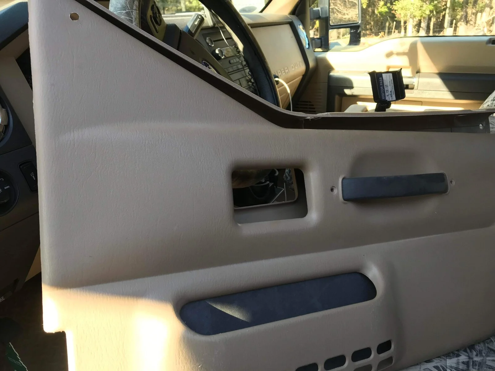

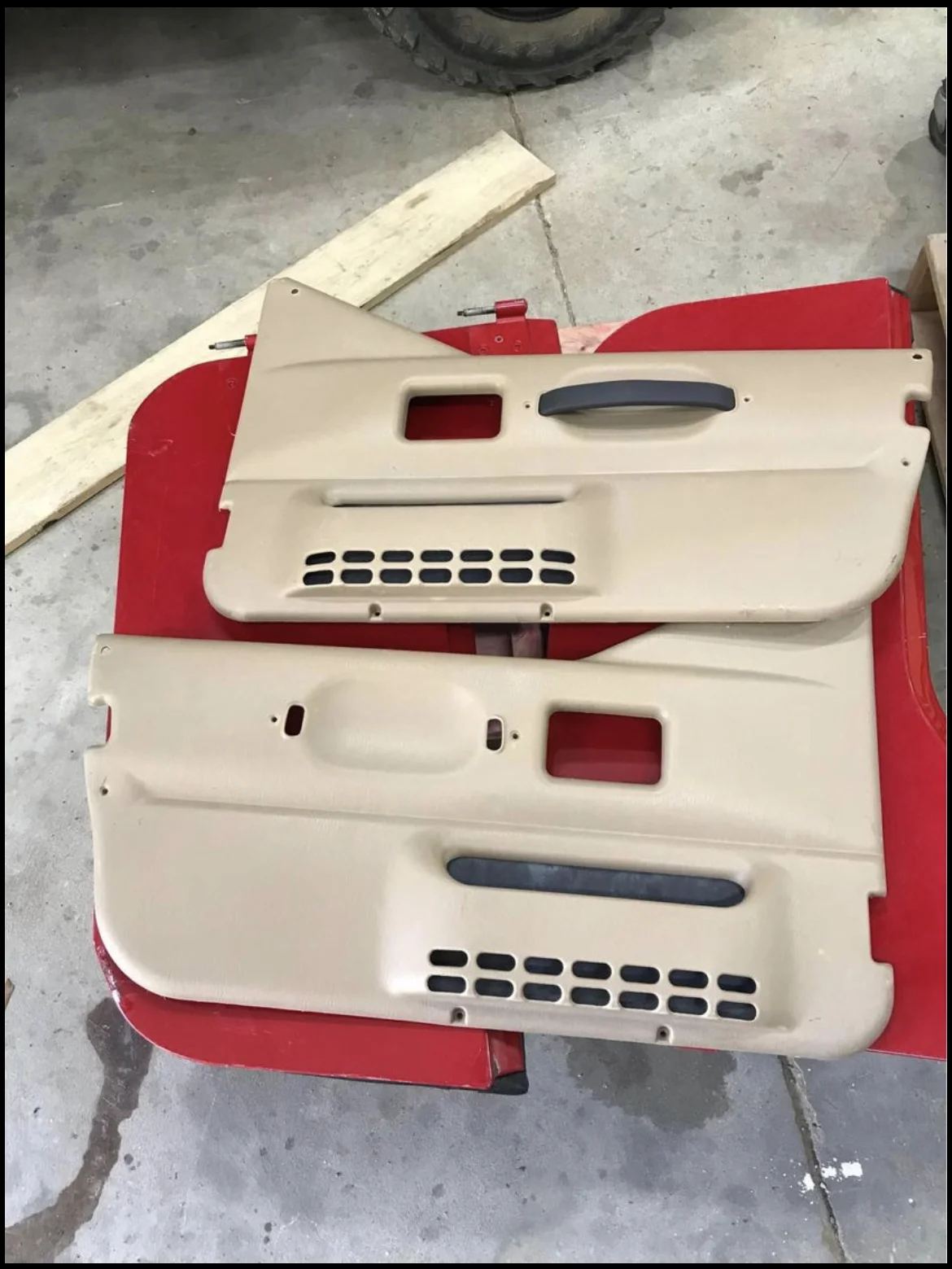

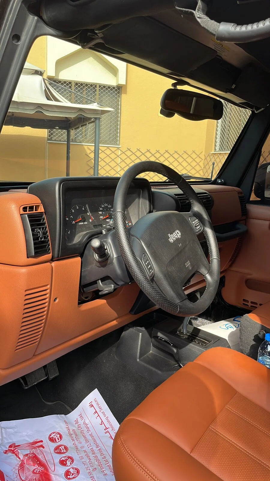

I’m working on my Black -> Tan conversion and found these super cheap. How close will they match to the Sem 15173 once I paint the dash parts?
I don't think it's possible to say unless you know the "Trim code" of the Jeep they came out of. Do you know that? It's a four-digit code on the sticker placed on the door jamb.
All I was able to gather was it came from a 2000 sport with red doors. Trying to get time to send me the vin.
Reactions: SSTJ

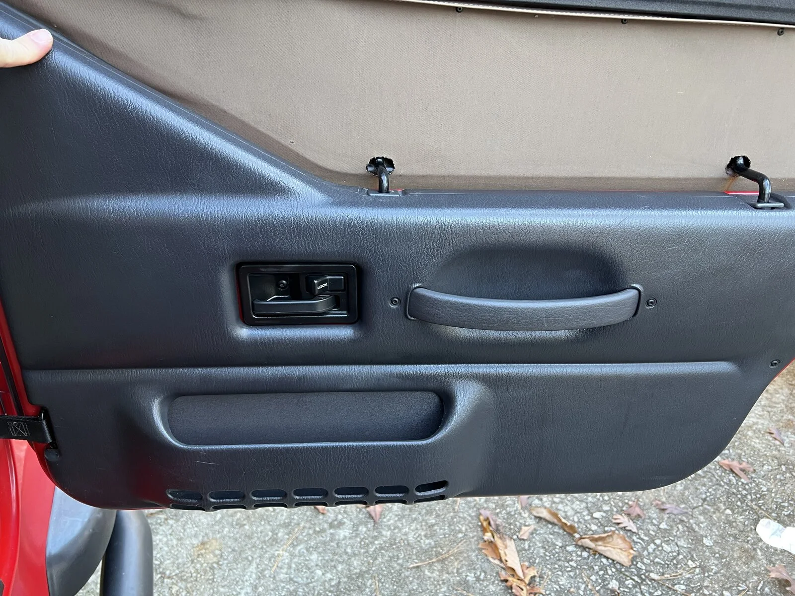

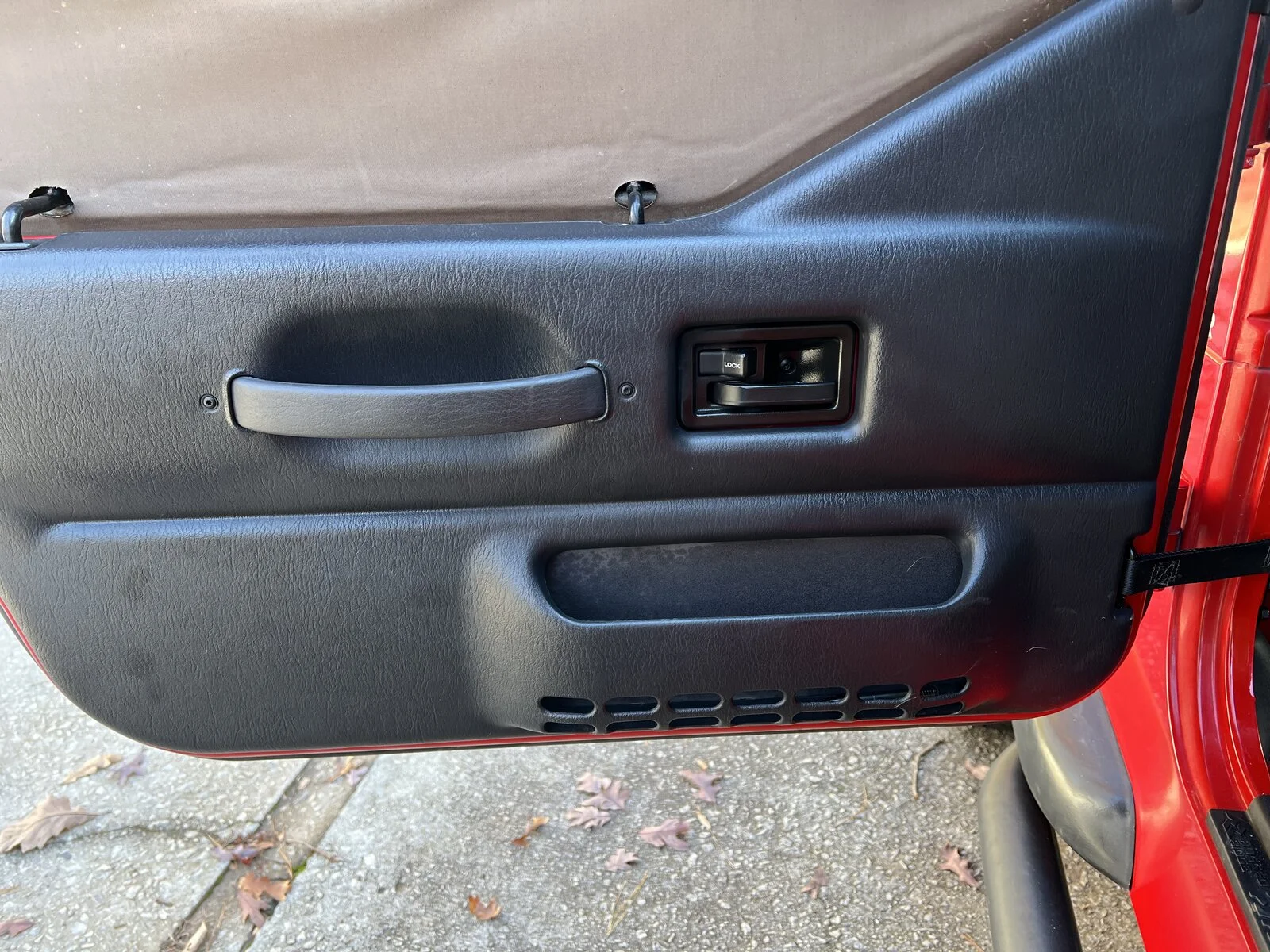

More thinking outloud, these are my current panels, am I better off getting the ones I posted above, selling these and then painting the dash or keep my current ones and painting everything at once.
If the rest of your panel is the same color black, then I think you might be happier if you just paint everything the same way. That way you can be sure it'll all match.

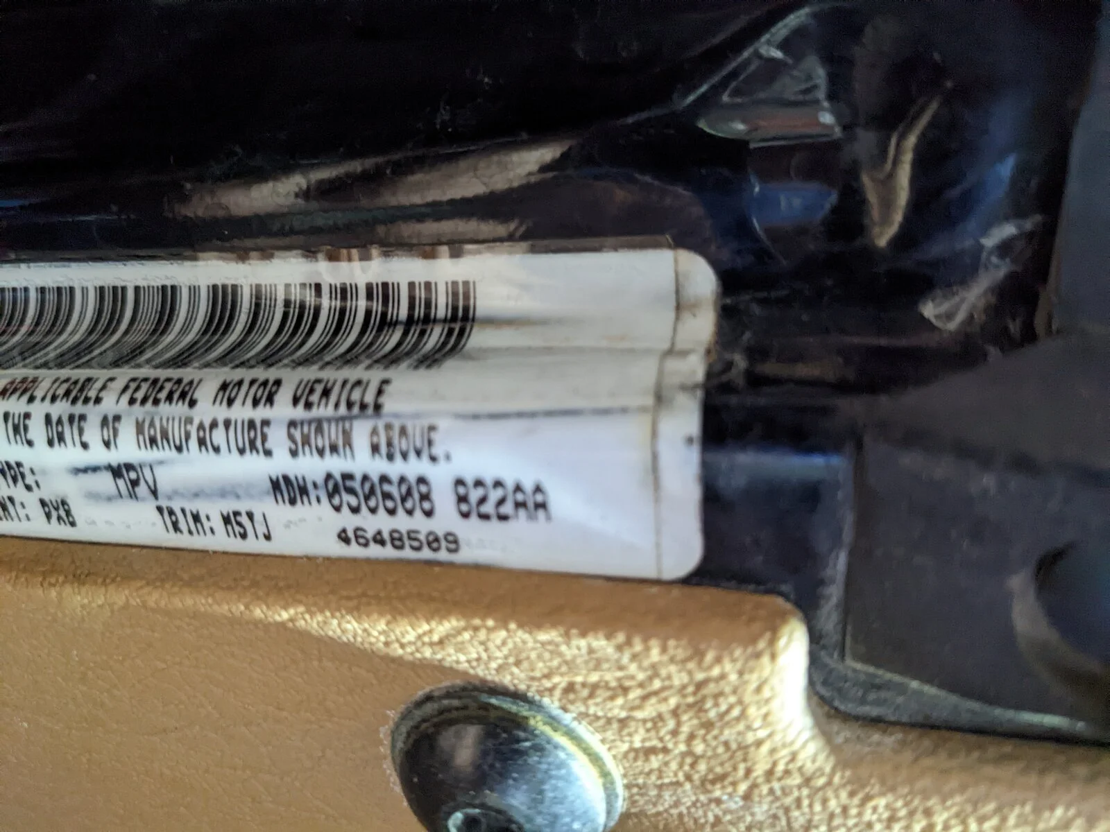

I've read every thread I can find on the subject of painting the dash (in my case, the passenger airbag cover), so, I'm trying to put all this info together.
Like on the VIN sticker pictured above, my '97 Sahara has a trim code of M5TJ. From what I understand the M5 refers to the style of seat. So concentrating on the TJ part of the code I called SEM, mentioned the TJ as the trim code and Saddle as the name and I was told the TJ actually refers to Saddle and Moss green interior colors (which my Jeep has). The nice guy at SEM told me the Saddle color of my plastic hard surfaces (dash/door cards) was actually Chrysler "Saddle code T6" which equals SEM code #4976. Does this make sense? Do I have this correct?
