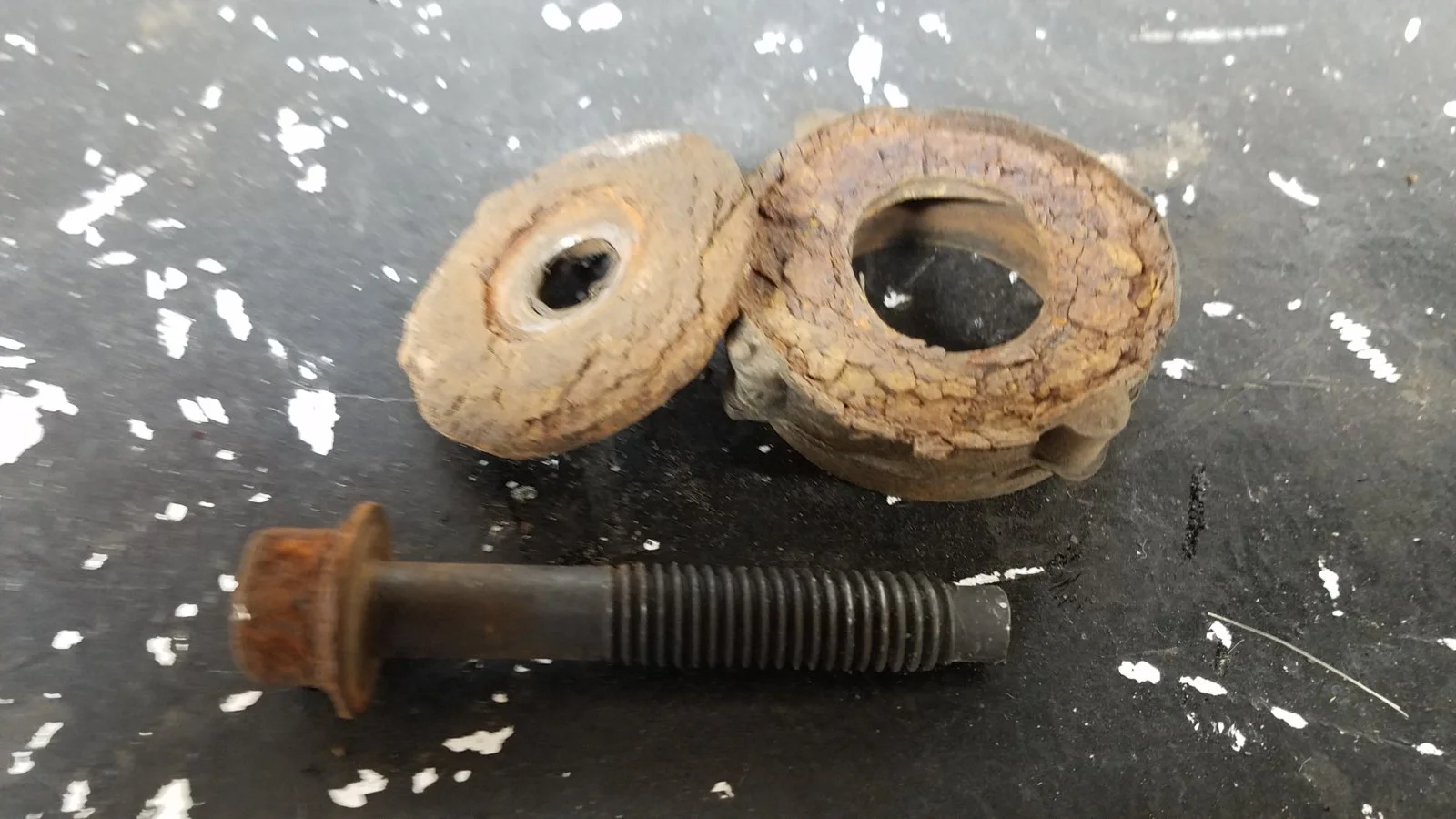

I'm installing a JKS 1.25" body lift on my Rubicon, along with my lift. Since my Rubi is a salty Girl, I broke all four rear shock mount bolts, and a couple of the body mount bolt snapped. Reading through my body lift instructions, they say to install one side at a time, so that the body doesn't move in relation to the frame. Ok, makes sense.
HOWEVER...It sure would be easier to take them all out and lift my body up about 4 inches in my case, in order to deal with the broken studs. Has anyone done this? I know @mrblaine has pulled a tub off, and put it back on (the pictures show it in his Bad Ass LJ build). What is the best way to do it, considering I don't have a lift?
One other thing...My body mounts are kinda nasty. The salt has really taken its toll on the steel parts that the rubber is overmolded too. Anyone know if I can get them individually, or do I have to buy a whole set?

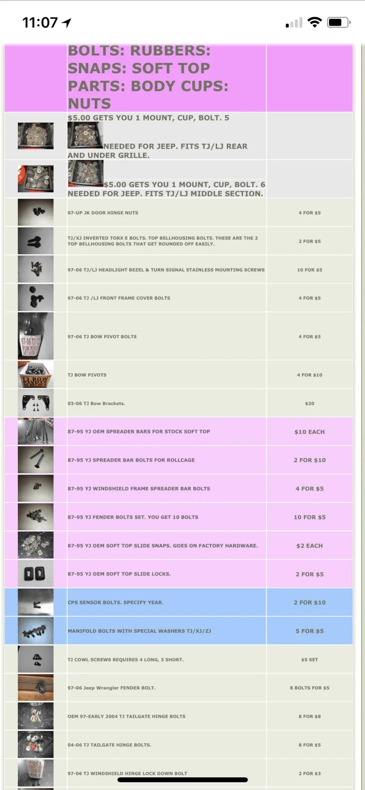

Yes, you can get the body mounts individually. I can’t seem to find them on Amazon right now, but I got two in December, about $4 each
I found them ranging from 24 to 34 each!
$5 each from daveys.. :)

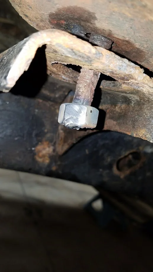

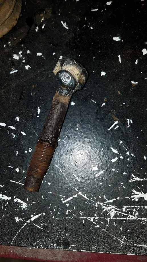

So just to bring closure here...I was able to remove half of my body mounting bolts at a time, get my work done, and not lose the position of the body. I started on the Driver's side. My fenders are off, and heeding Mr. Blaine's warning about the grill mount, I removed that as well. I loosened all the mounts on the passenger side, until there were only a few threads engaged. I removed ALL the mounts on the drivers side (5 of them) I jacked that side up until it bound (got about 4 inches of lift) and blocked it. The broken bolts were both on the drivers side, so that part was nice...This is the front one. It was REALLY stuck. Had to weld the nut on a couple times, but finally got it.

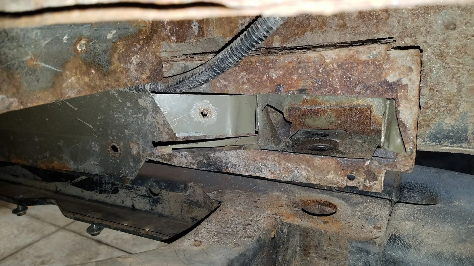

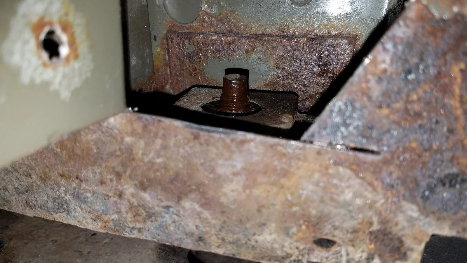

The rear most mount was a real headscratcher. The nut is fully boxed in a cross member...Its also a cage nut, so it moves around. Drilling it would have been tough, since the bolt broke inside the nut...Anyway, I ended up cutting the crossmember and cage open to remove the nut and bolt stud combo.

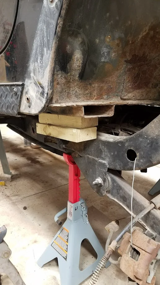

After those two bolts were removed, I lowered the body back down, installed the front drivers side mount and removed all the passenger side mounts, save for the first one. Now I have the jeep raised off the rear crossmembers, and sitting on 2 x 4's on the rear most mount point along the rocker...
