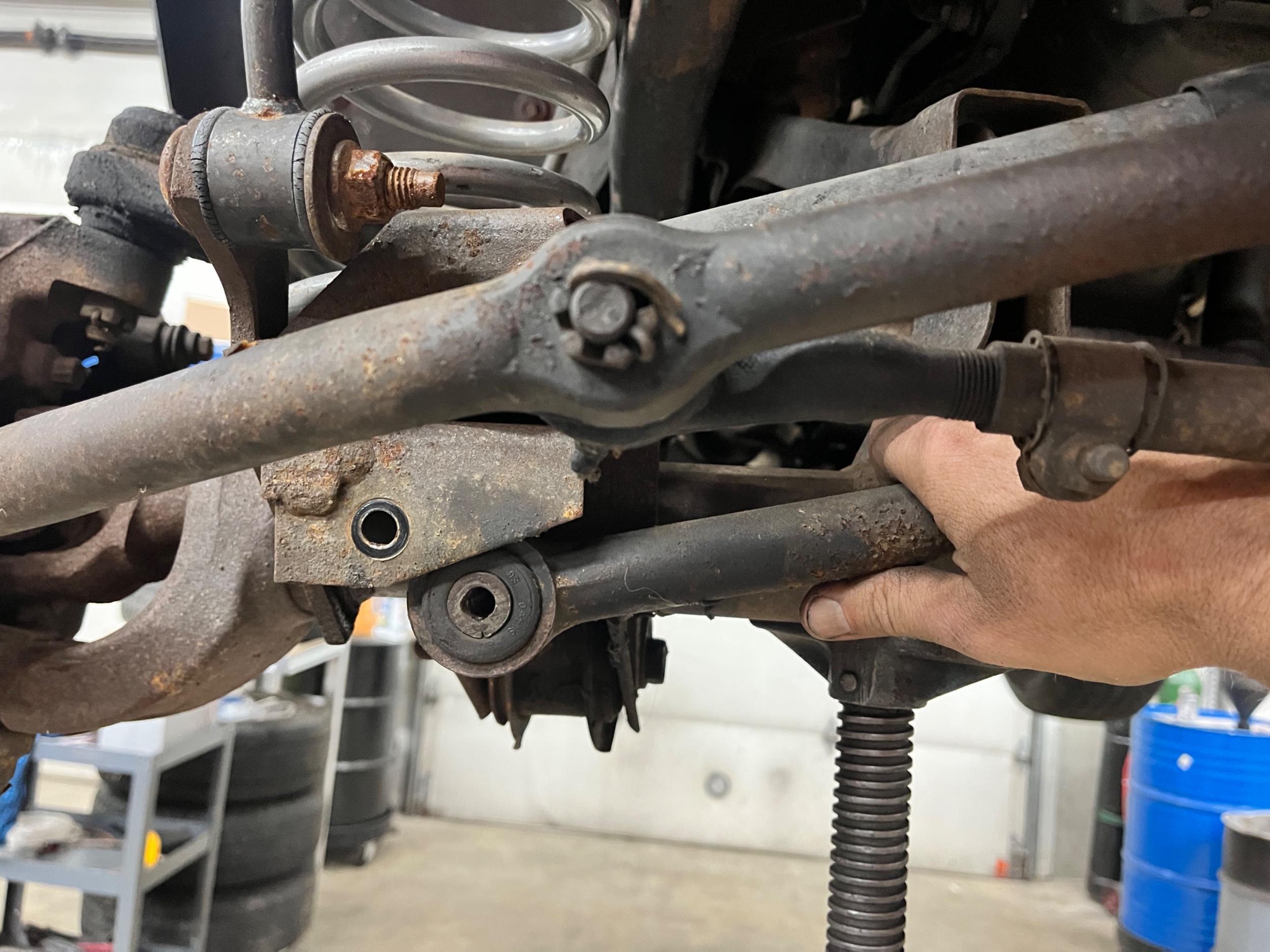

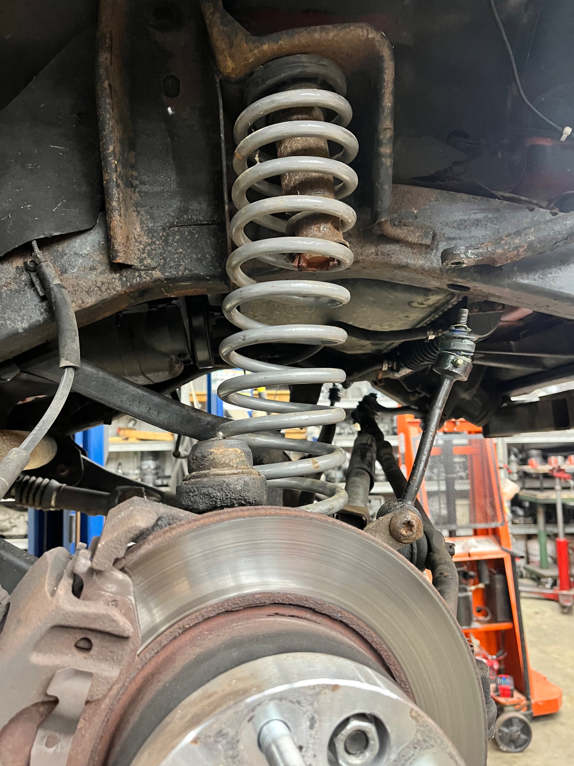

The YouTube video never mentioned relocating the track bar on the rear or the front at all. So I move to the front, after disconnecting the sway bar links band getting the old springs out, I proceeded to install the front spring. Once I got that first spring in I went to the drivers side and noticed again the front axle has shifted. I did not have a bracket for the front to relocate the track bar. I’m not having luck finding one either. So I am wondering what others have done for the front track bar? I disconnected the track bar at the axle and the axle centered itself immediately. Now I’m about an inch away from the original bracket . I have not installed the second spring yet.
