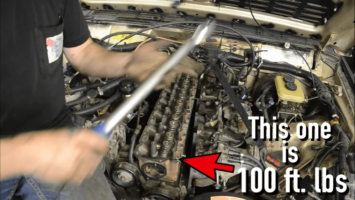

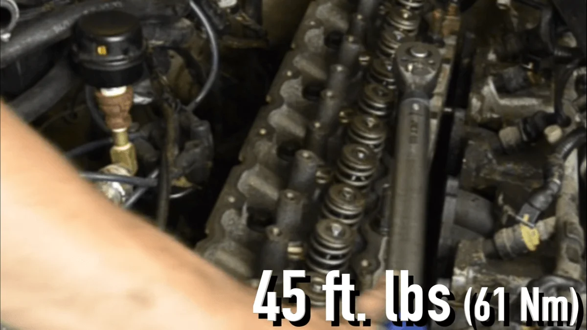

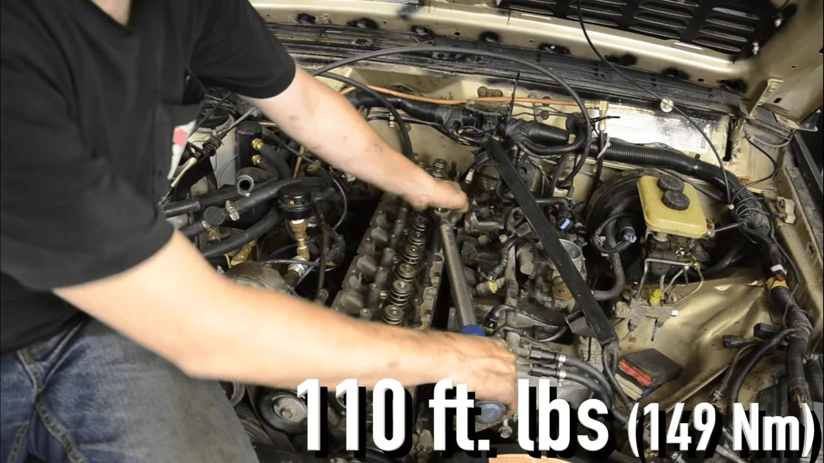

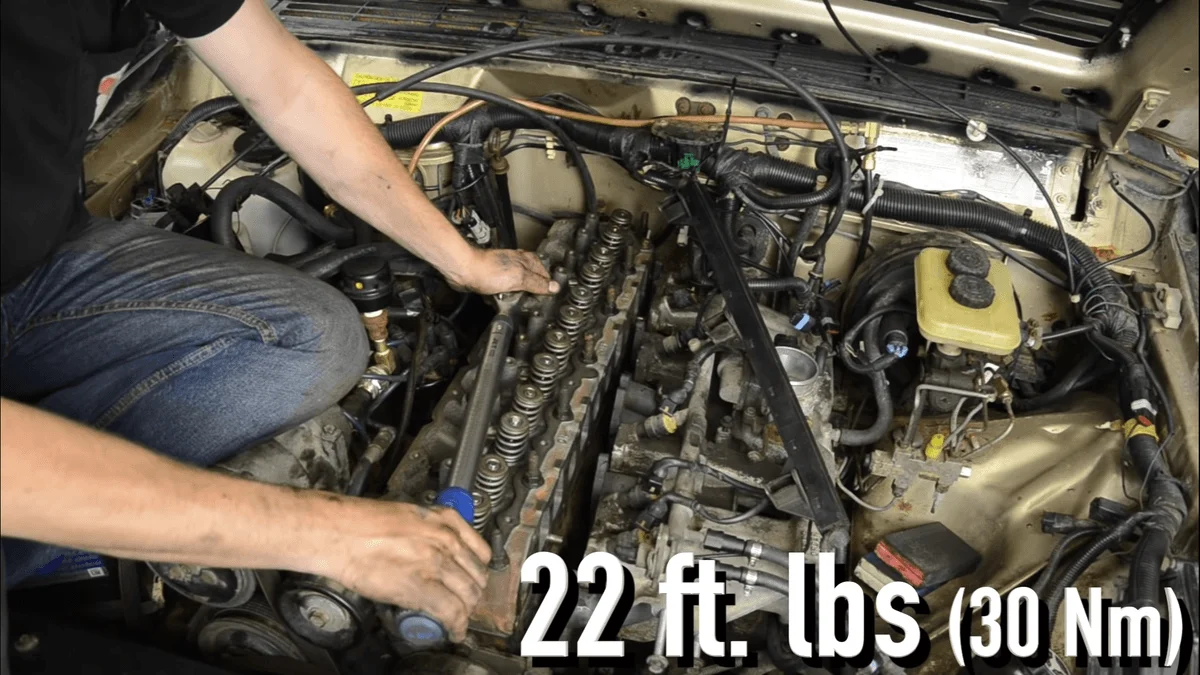

1st is 22 FT. LB
2nd is 45 FT. LB
3rd is 110 FT. LB except bolt #11 is 100 FT. LB
This is according to my 2005 Jeep service manual. Why 100 on bolt 11? I have no idea. Just got done rebuilding the 4.0 in mine.
