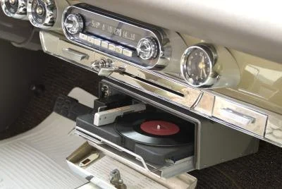

Plumber1

Before 8 tracks there were these guys, not sure how you kept them from skipping on bumps.
If the car in that photo rides anything like my '76 Mercury, there are barely any bumps. I can hit a speed bump at 30mph & barely feel it. BTW my recommended tire pressure according to the doorjamb sticker is something like 26 psi. Don't want to compromise any ride quality!
