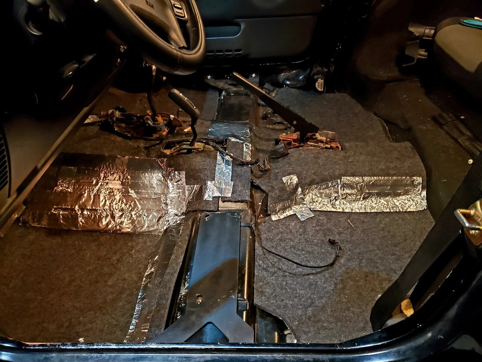

I just ordered the 80 and some of the 150mil foam that I plan to put up the firewall and trans tunnel. The plan is to lay down the butyl in all areas and the foam in specific areas where heat is an issue. As well as new weatherstripping to replace my torn and leaking ones.

I'm gunna try the Lizard Skin product on mine. I've read and heard good things about it. They coated a Blazer on Trucks I think it was. There are YouTube videos showing people doing both the heat & sound coatings. I'm more worried about the heat so that is the coating I am doing.
https://lizardskin.com/
I got mine from JEGS
This looks expensive on the surface. However, once you add up the cost of tape, mat material, and time, it's not that bad!
Reactions: Wildman
Yep and there are arguments both ways. Just want to kill the sound just do that coating. Want to cut down on the heat do that coating. What BOTH? Then lay down both. And they were very helpful when I called. I got one of the kits with the spray gun & mixing wand.

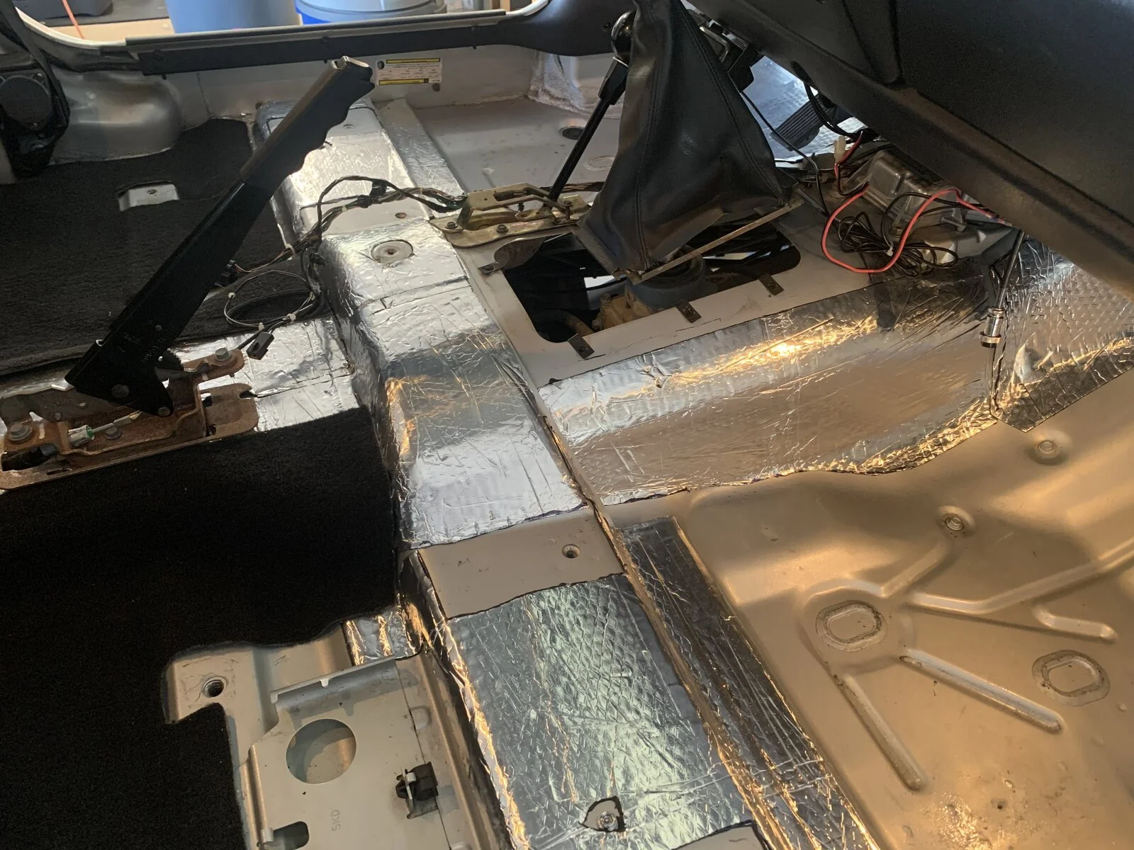

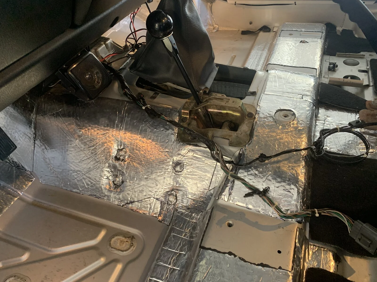

Look into www.carinsulation.com the stuff blocks 97% of heat and also some sound deadening. Its used by the hot rod community. Its very economical. And very light weight. I used 3m spray adhesive. Just a bit to hold it in place.
Under it i used second skin sound deadener. But it sounds like you dont want that much weight.
This appears to be a viable and economical solution. I'm going to look closer at this one...thanks!
