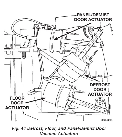

Maybe this will help.. looks like maybe a vacuum actuator or Blend motor/door.. good luck!

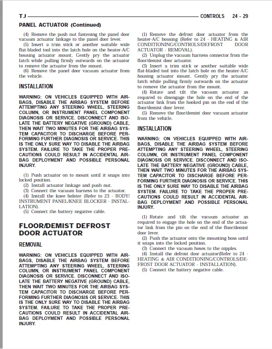

link doesnt work....but def could be the actuatorView attachment 46168
The actuator? hmm is this what controls the mix of hot and cold air? I wasn't able to find much in the my FSM.
