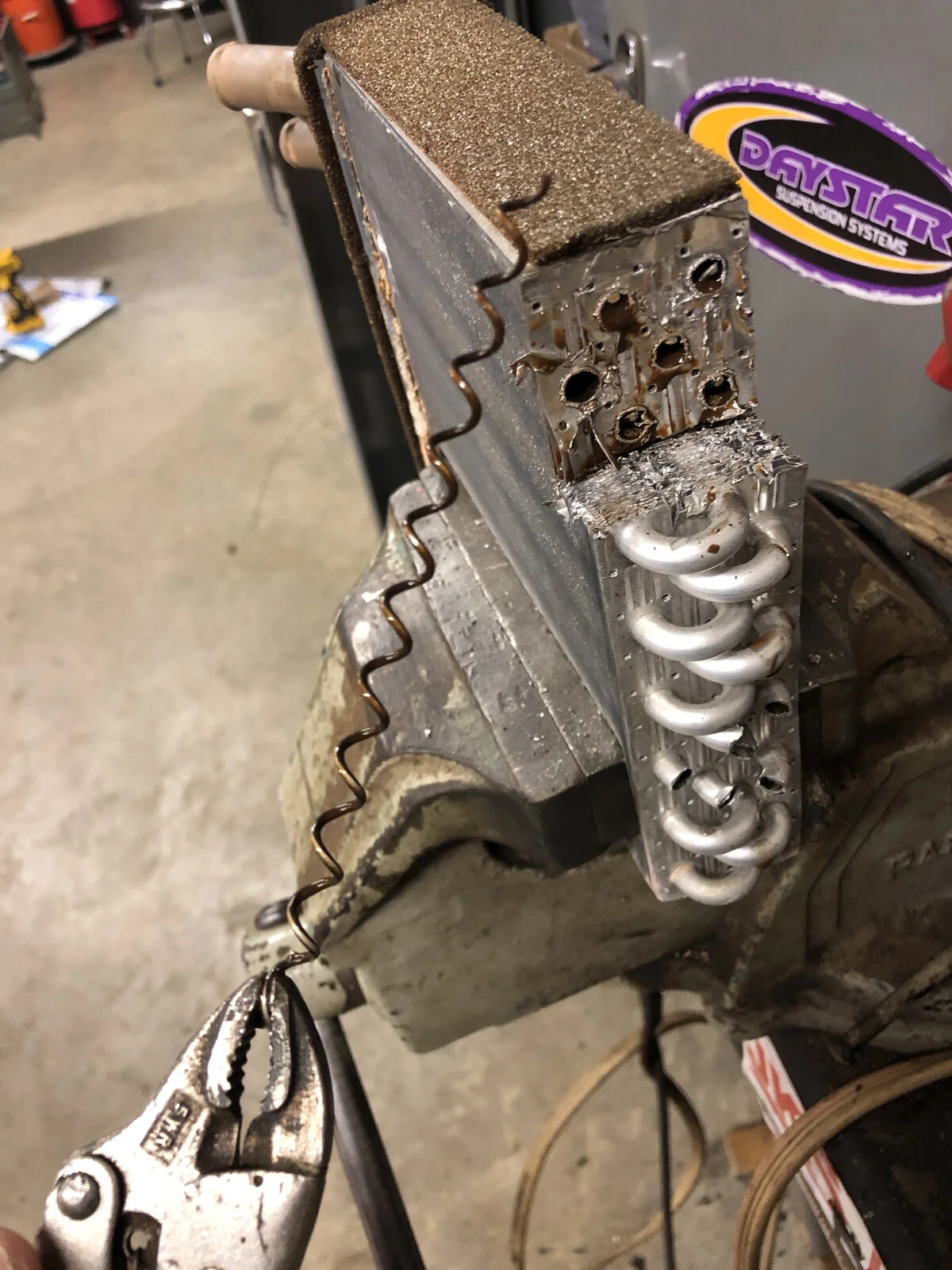

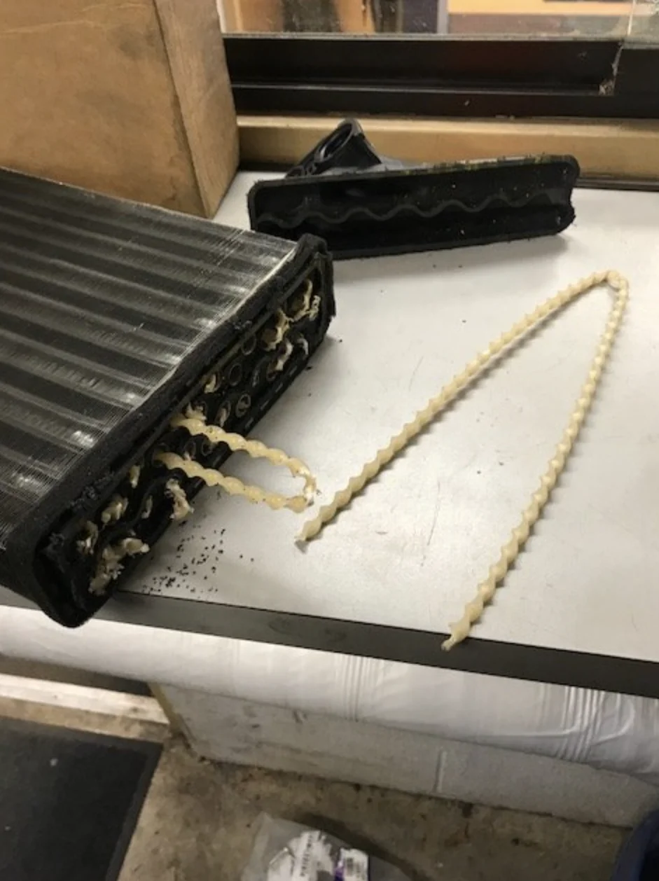

Huge shoutout to @MountaineerTom for linking that thread with someone who had a similar issue. After reading through that thread I found this one where I came across the picture below. This shows the plastic "turbulators" used in the aftermarket heater core vs the metal ones in the stock. Notice how the OEM metal ones are long, thin, and have less spirals while the aftermarket plastic ones are thicker with more spirals. Based on my research, @BigWidd 's post, and @Jeffrey Hamre 's picture, I have come to the conclusion that my aftermarket core uses these plastic "turbulators" that restrict the coolant flow too much resulting in cool air at idle.
Tomorrow I will check to see if I still have my stock and cut it open to confirm it has metal "turbulators", if it does I will then start the dissasembly process again and cut open the new core to see if they are plastic. Best part about this though is that after calling the Jeep dealership today I found out they discontinued my core 4 days ago, and there are none available anywhere in the US. I found one on mopar parts website that is $350. So I will have to resort to the OMIX one on Extreme Terrain which seems to have the best reviews of any I have found.
I dont know when I will have the time to get the new new heater core installed but I will at least be able to confirm if the OEM one has metal spirals tomorrow, and confirm if the aftermarket one is palstic by the end of the weekend. I will then upload a new thread detailing the entire process once I get a new new core isntalled and working. I want to make sure NO ONE ever runs into this issue in the future becasue it is a huge pain.
I dont know when I will have the time to get the new new heater core installed but I will at least be able to confirm if the OEM one has metal spirals tomorrow, and confirm if the aftermarket one is palstic by the end of the weekend. I will then upload a new thread detailing the entire process once I get a new new core isntalled and working. I want to make sure NO ONE ever runs into this issue in the future becasue it is a huge pain. View attachment 219167View attachment 219168

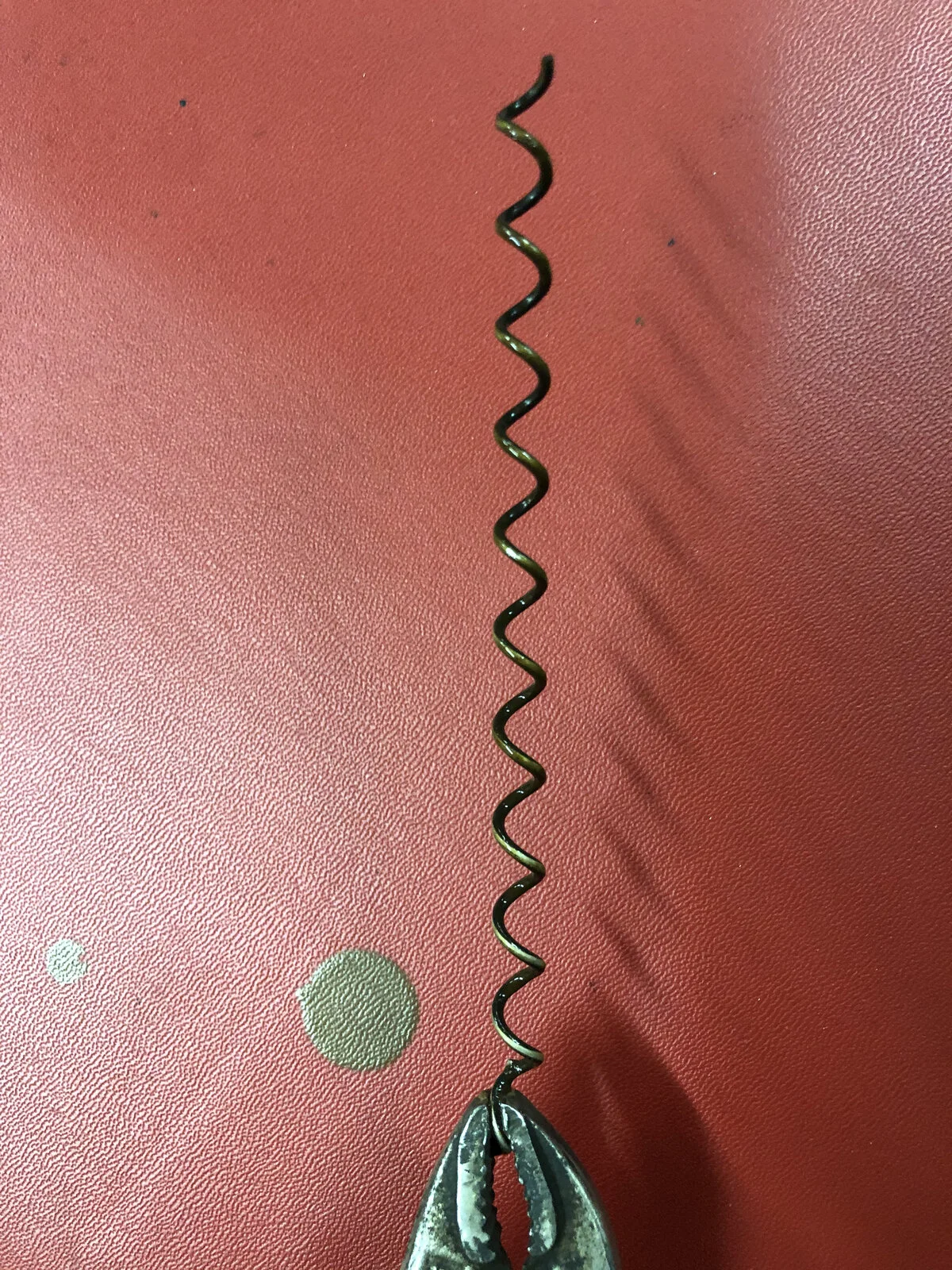

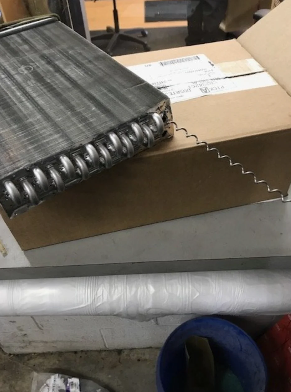

So I cut open the stock heater core tody and can confirm the use of long, thin, metal turbulators. Next step will be to take apart the new core and see if they use plastic thicker ones like I suspect. Dont know when I will get around to it but I will update this thread when I do. Below you can see the turbulators I pulled from the stock core. They are long and thin making it so coolant can flow easily and freely. My guess is that the aftermarket one uses plastic thicker ones that restrict flow like in the case of @BigWidd 's.
