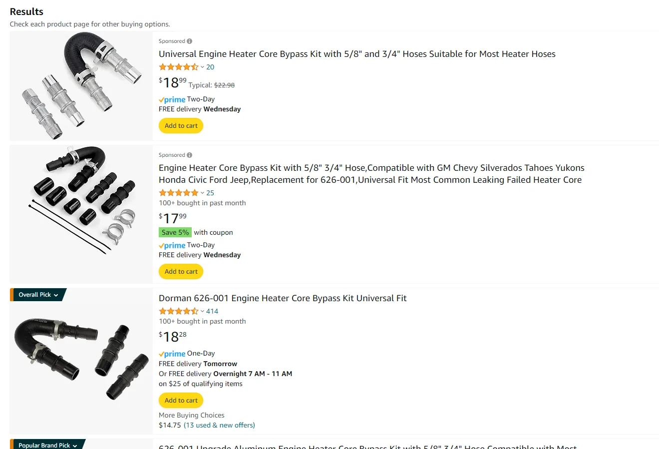

Coadster32 Member Original poster Supporting Member Joined Mar 18, 2024 Messages 37 Location Connecticut Apr 8, 2024 #1 Looking to temporarily bypass the heater core. I know the hoses are 5/8" and 11/16". All of the bypass systems I see are for 5/8" and 3/4". Is this what everyone is using, and just making it fit? Reactions: Rickyd

cpwolf Texan Supporting Member Joined Jun 15, 2020 Messages 2,033 Location TEXAS - Cedar Park Apr 10, 2024 #2 Coadster32 said: Looking to temporarily bypass the heater core. I know the hoses are 5/8" and 11/16". All of the bypass systems I see are for 5/8" and 3/4". Is this what everyone is using, and just making it fit? View attachment 516692 Click to expand... I used that Dorman, and in Texas, just been able to wear a jacket. Need to get this HC replaced The Dorman fit perfectly Reactions: Coadster32

joelachr TJ Enthusiast Supporting Member Joined Dec 13, 2018 Messages 347 Location Michigan Apr 10, 2024 #3 I used 5/8” and 3/4” sizes and didn’t have any trouble fitting it. It’s been fine for about a year so far. Reactions: Coadster32 and Rickyd

Coadster32 Member Original poster Supporting Member Joined Mar 18, 2024 Messages 37 Location Connecticut Jul 26, 2024 #4 Just to follow up for others...this did work without leaking. Reactions: macleanflood
