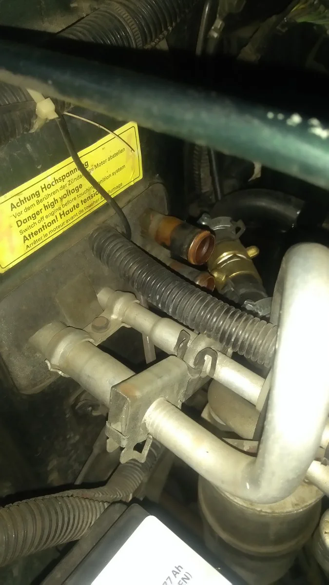

Hello @billiebob, I am writing from Hungary. I have a TJ 4.0 (probably there are only 10 jeeps in the country) and have the same problem. Currently with bypass. I think your idea is extremely good and I have a question. What are your experiences so far? Is this a practicable and safe way to reactivate the heating? What do I have to consider? Are there any problems with the cooling of the engine? I am grateful for any information. Best regards from Hungary, Edgar

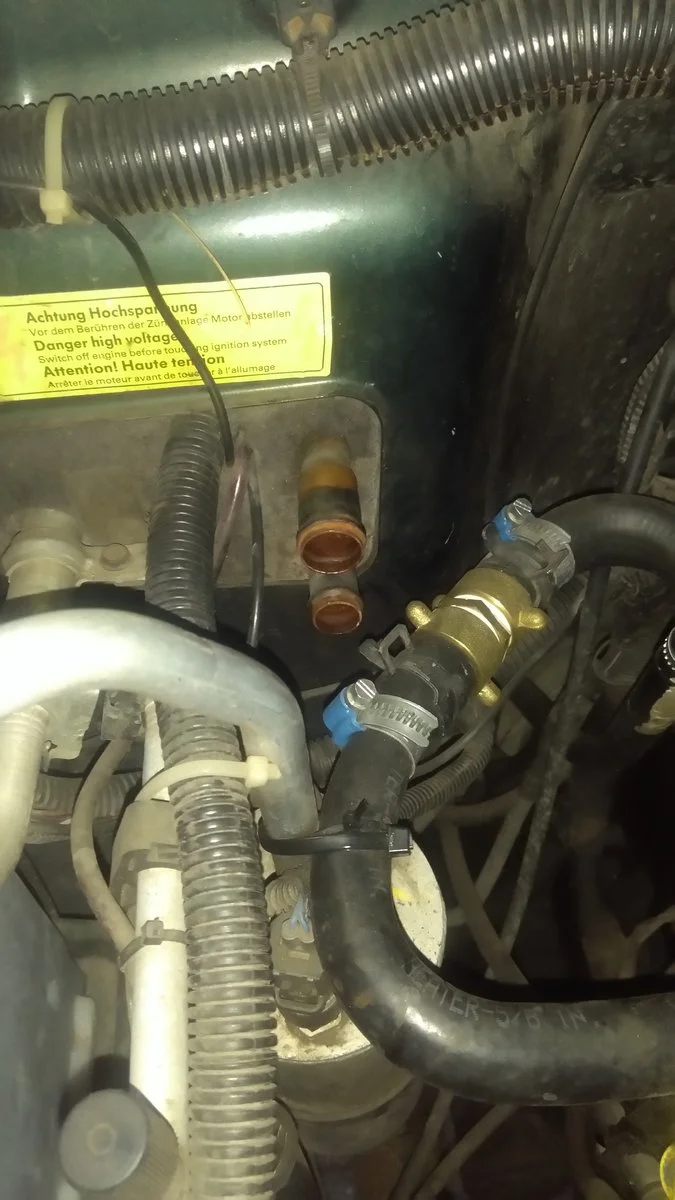

Hello mots, Still working. No rust. No leak - all good. I'll leave it that way now - the winters are getting warmer and warmer in Europe - that's enough for heating. I have expanded the bypass in the meantime. Bypass Heater Core - new heating

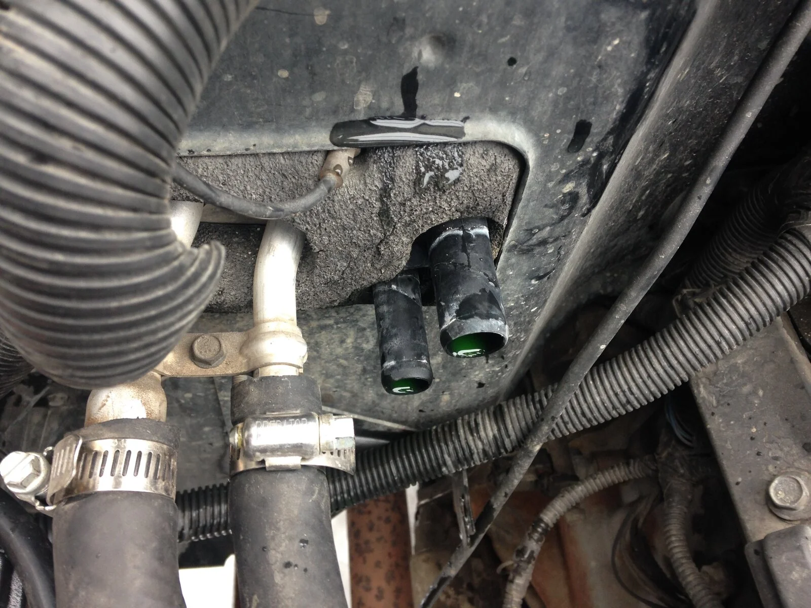

I did mine as a stop gap for a few months before committing to the pull the dash thing. It worked better than the heater heater. The AC condensor?? is bigger than the heater core so it puts out wayy more heat. Off the AC coil I got 130F, after putting in the new heater coil I only got 100F. 130F is not enought to burn you.
Definitely no issues with the factory rad, engine cooling, no different than upgrading to a bigger rad.
PS, ya have to give up the AC
