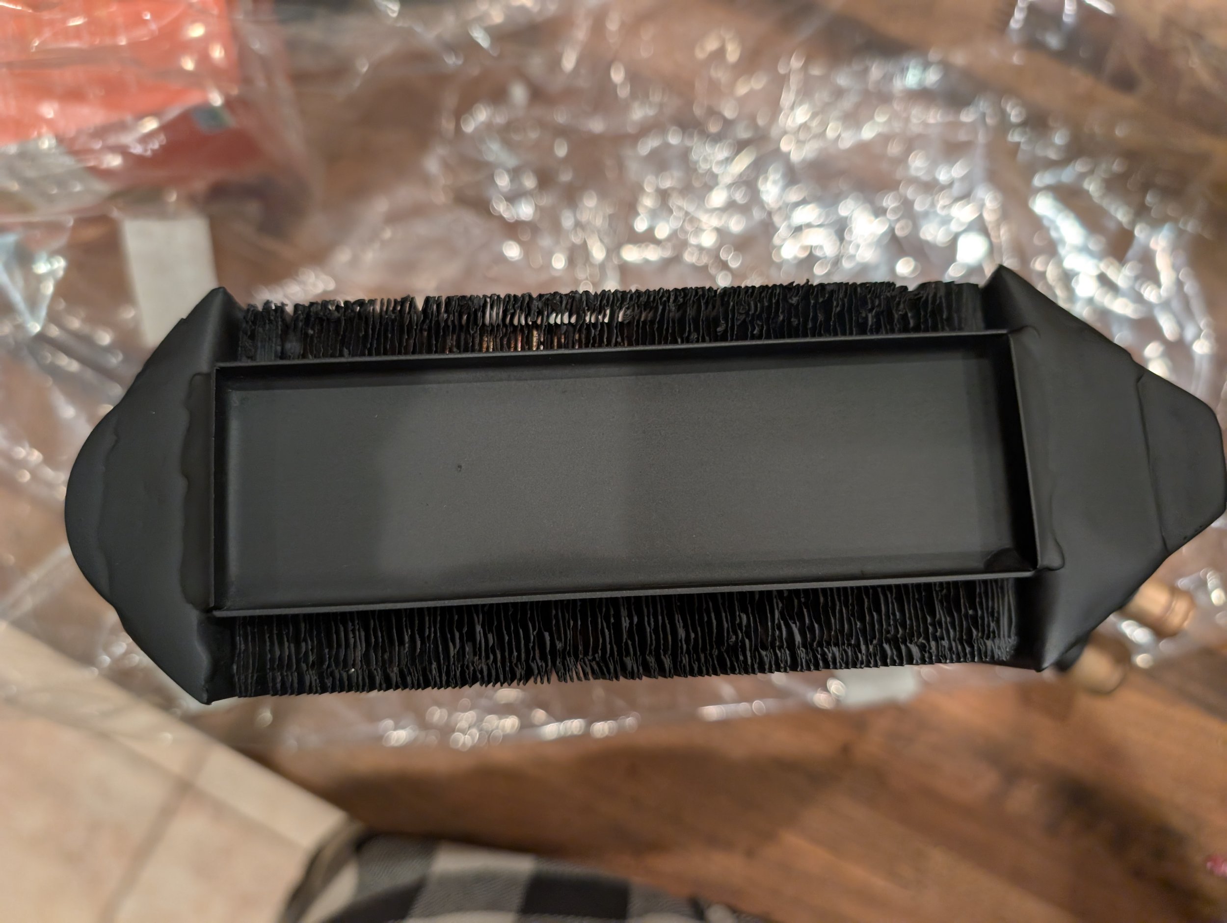

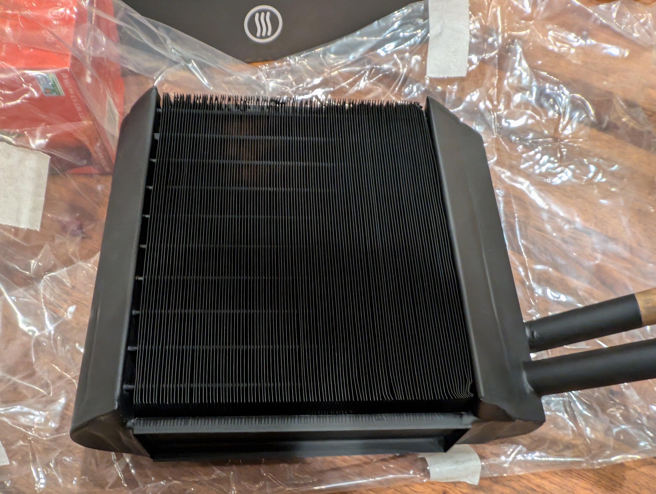

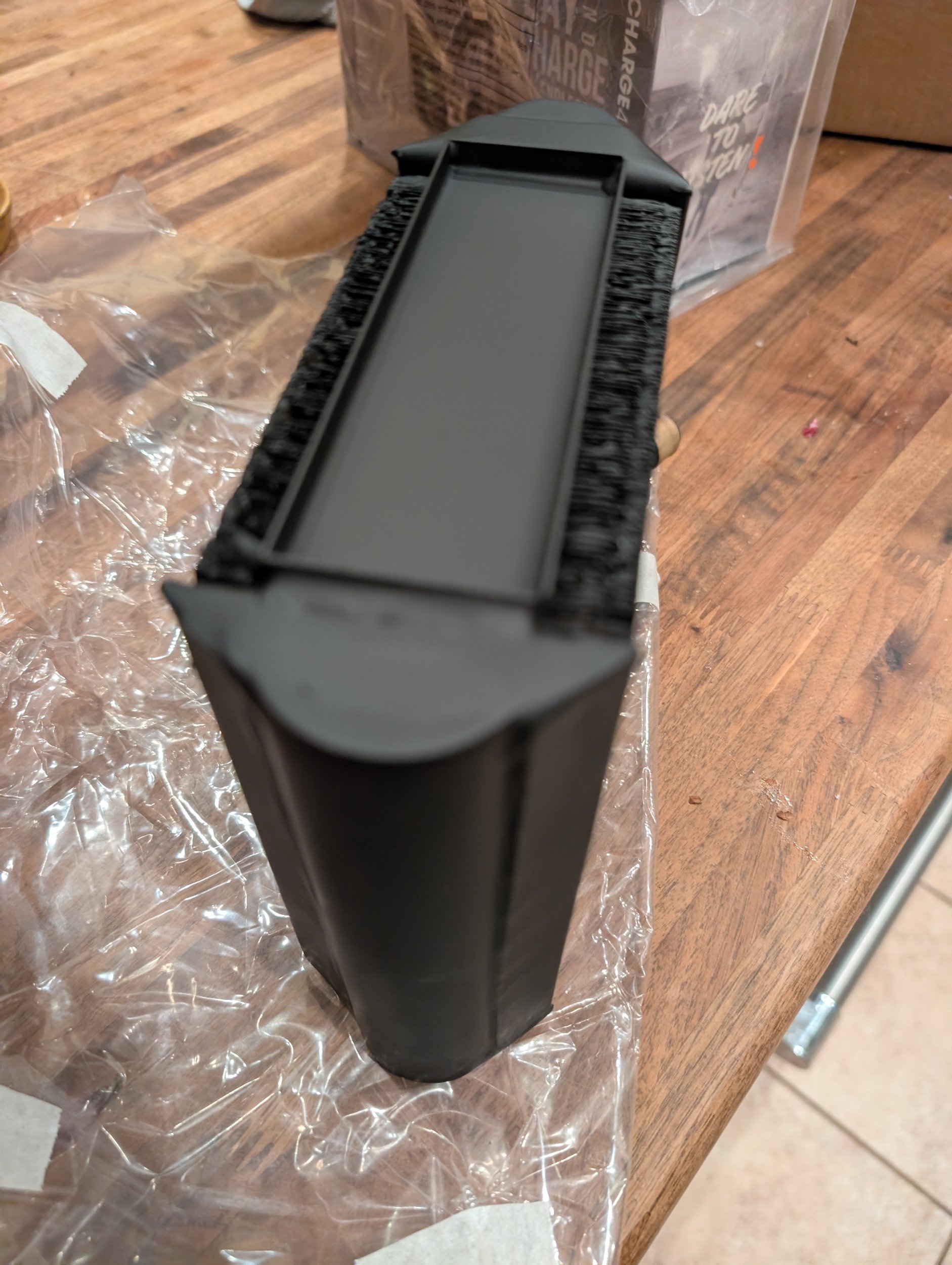

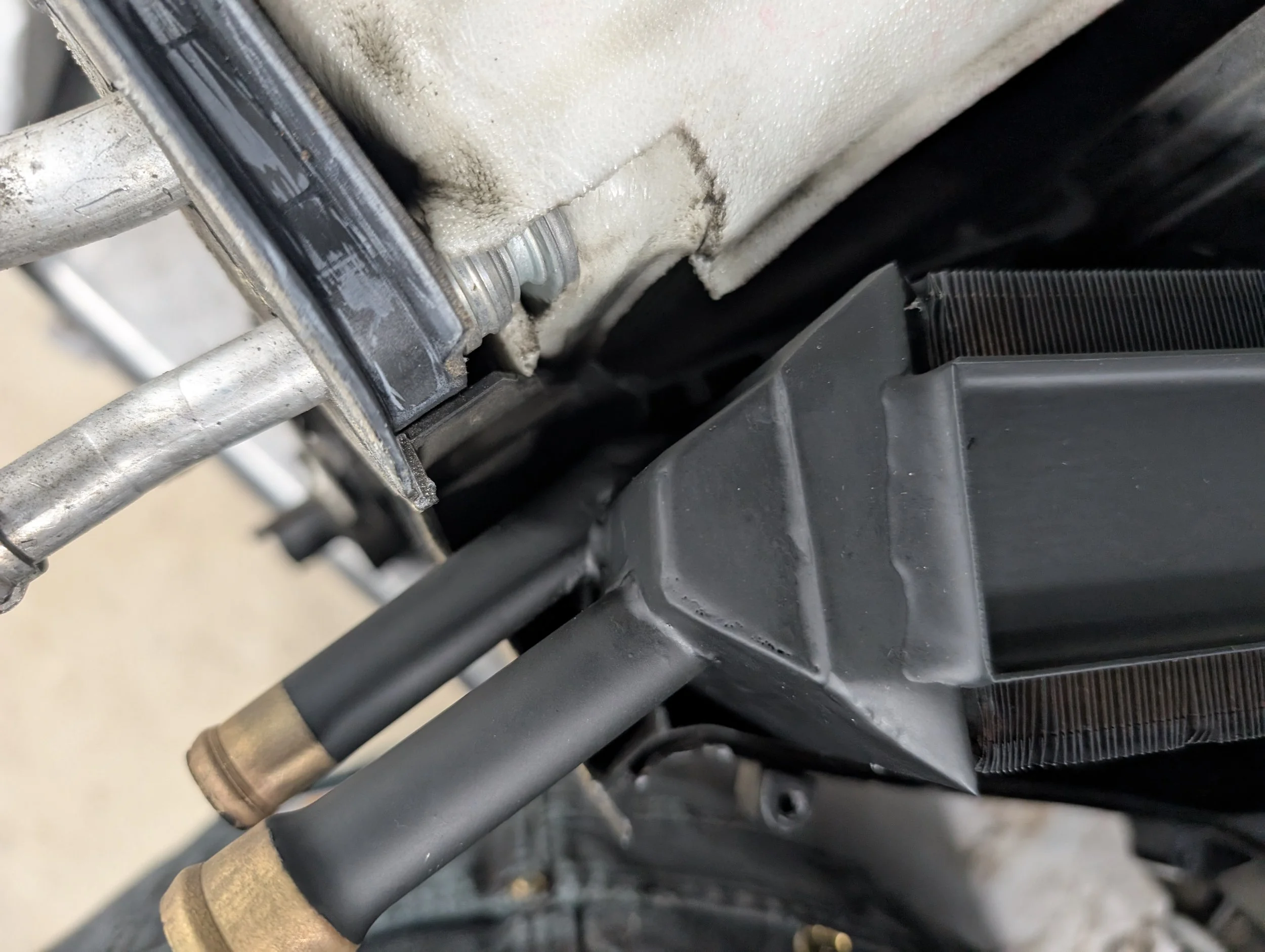

We mentioned on this forum we would see if we could place an even larger heater core in the 2002-2006 Jeep wrangler heater core space. link to brassworks
  • 2-5/8" thick
  • 3 rows of staggered tubes
  • 20 copper fins per inch
  • baffled internally, restricted accordingly
  • metal channel slides in the plastic channel
  • fins overhang but do not interfere with wall or blend door
  • no plastic turbulators to clog the system

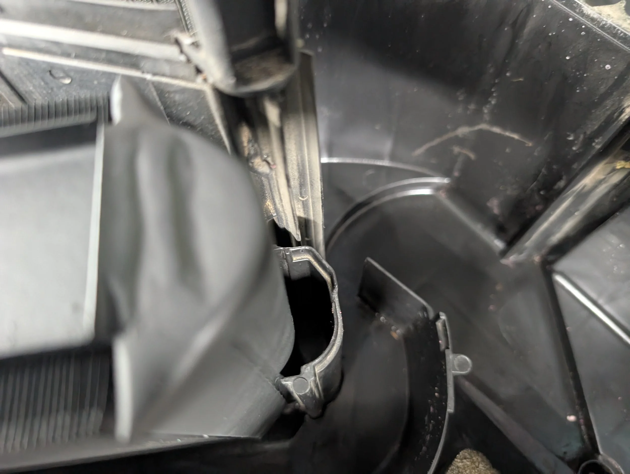

There was a question about the fitment but I can't reply to the question. ...The heater cores are tested in the heater core box before they are tested in the tank.

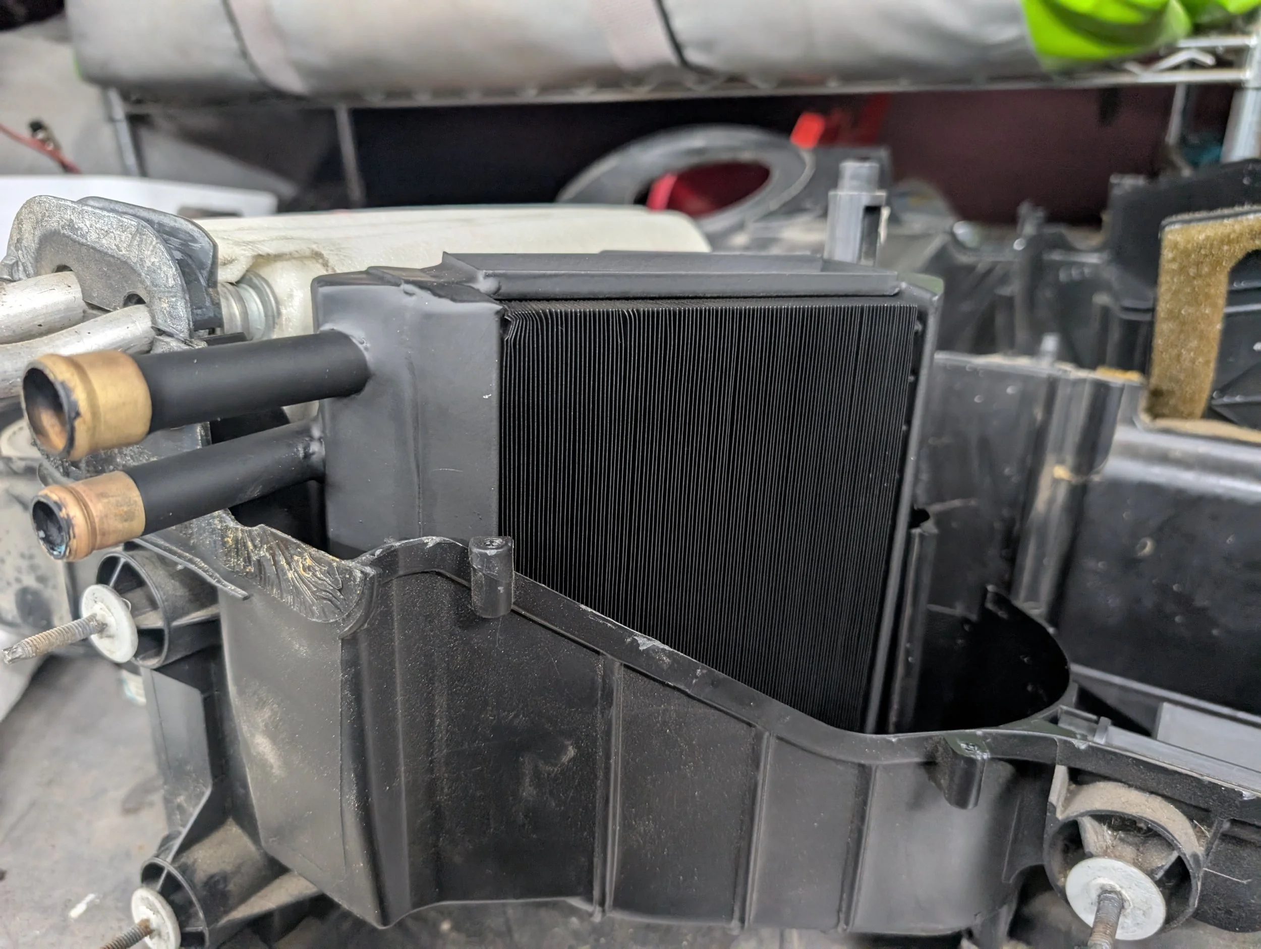

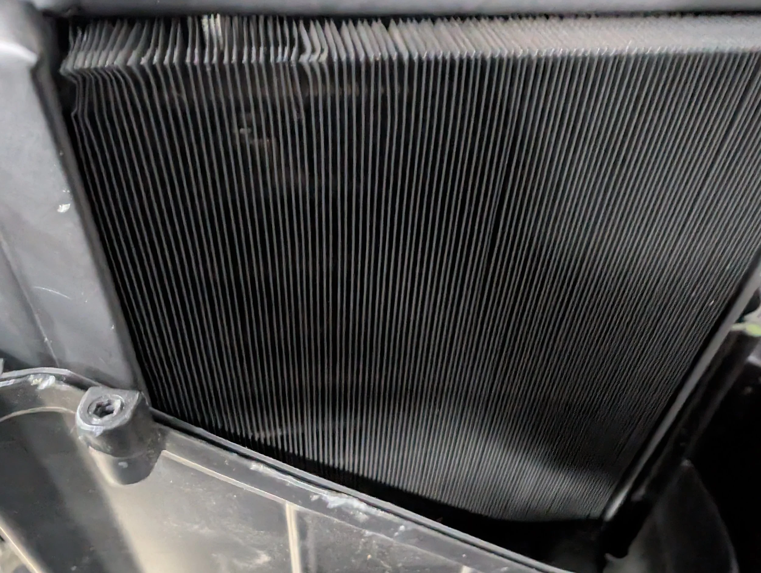

Finally got it done yesterday - it may need to burn in a bit and/or I have a little air in the system (burping recommendations invited). It gets warm enough for me, but others may think its not warm enough. I don't think this is the final answer...it is nice that the coolant smell is gone...
Reactions: tr21triton
To burp, all you need is the rad cap off, front end slightly elevated and let it run till it's up to temp.
Or, you can just drive it and keep an eye on the overflow bottle, it will eventually burp itself.
Do you have a thermometer you can check the temp with?
I have never been impressed with the heat output of my TJ but it's plenty to keep the interior warm in the coldest temps I had it in so far (mid teens). Maybe it wouldn't be enough for very cold temps but so far, it's enough.
Went for a ride in my wife's lj last night....its much warmer. I suspect that I put in a bigger core, more transfer capacity and same water flow. Net result...less heat output. On Fan setting 3, its plenty warm for me. If I had sub zero temps...maybe not.
The core is super solid construction and I have confidence that I will not be doing this replacement job again (it sucked) that was my goal.
