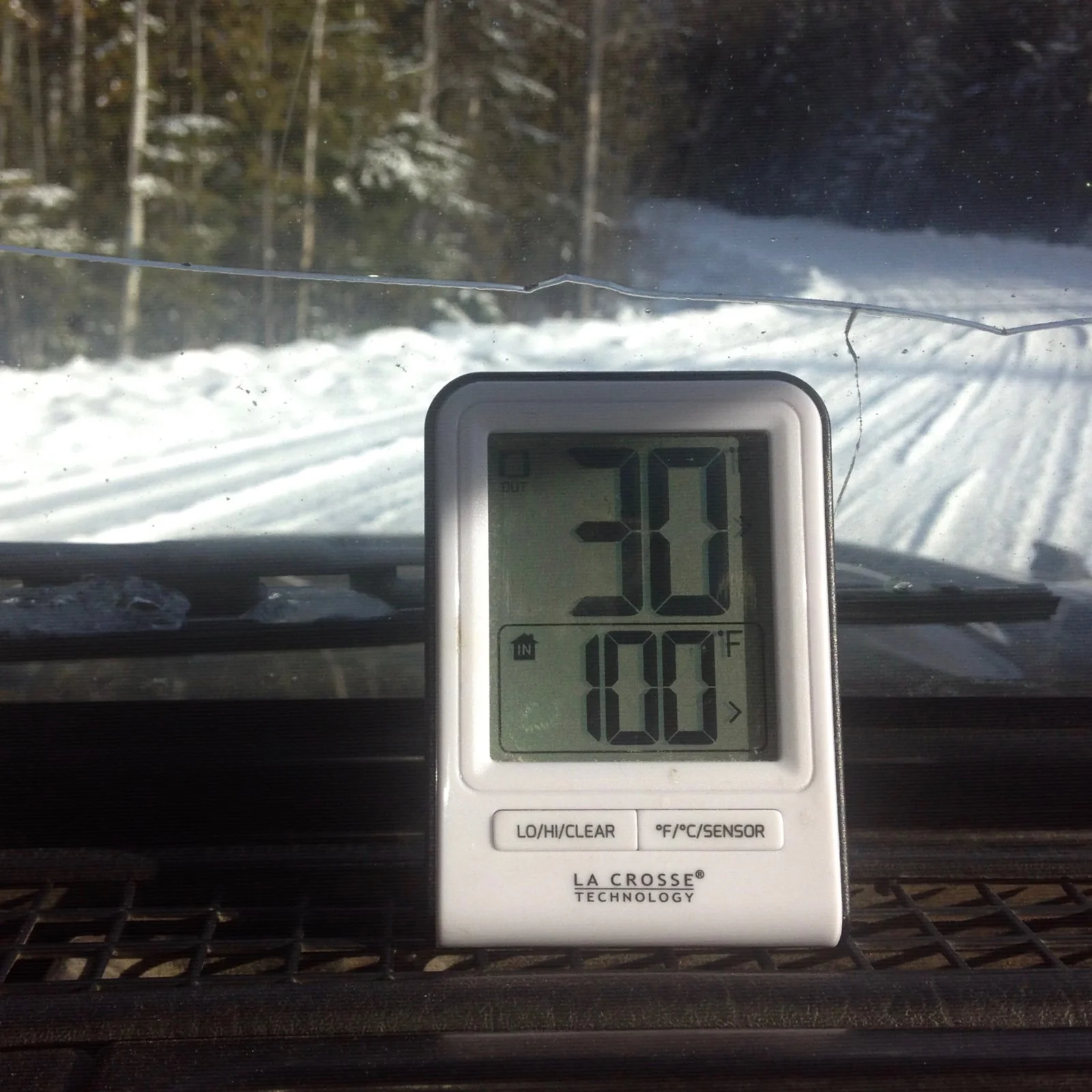

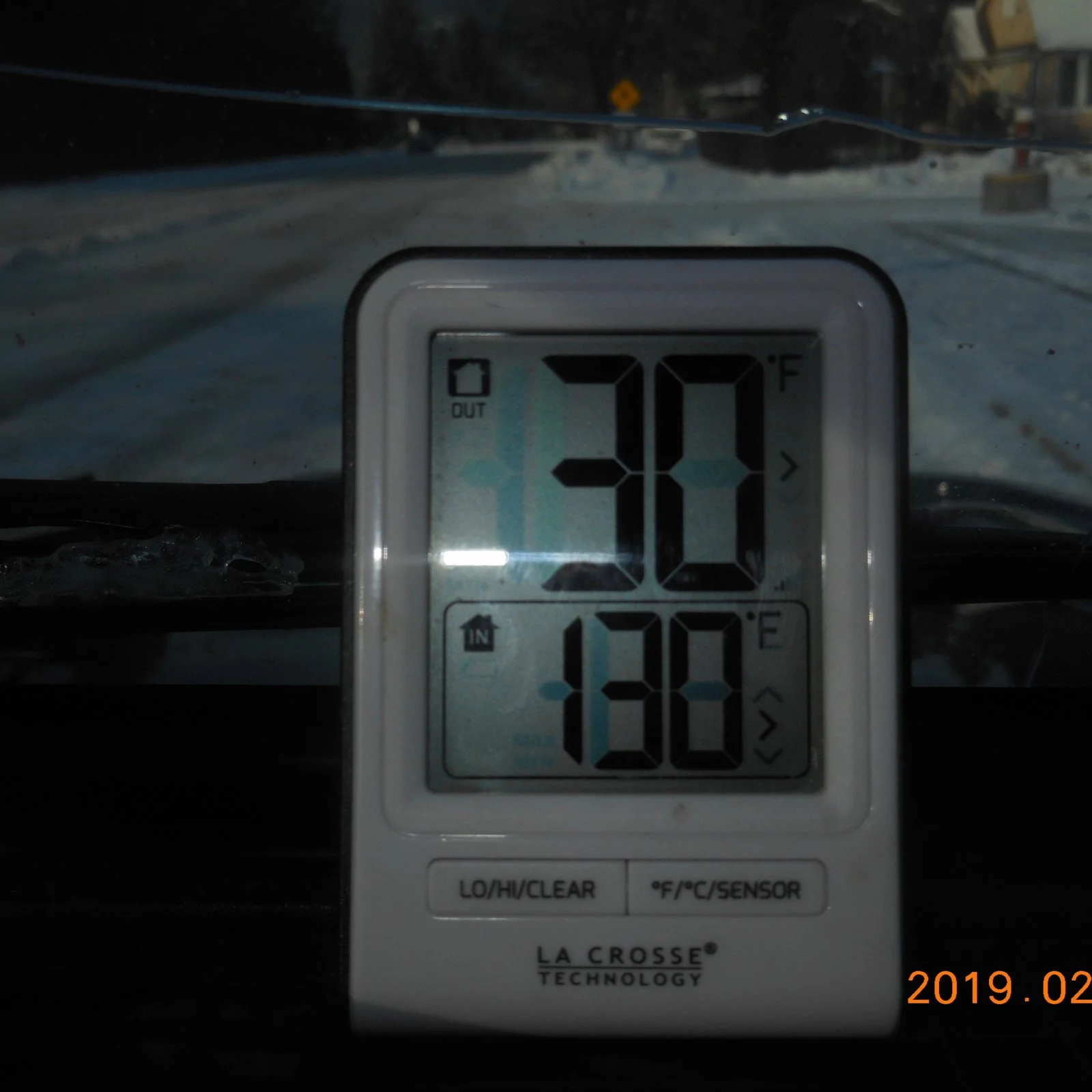

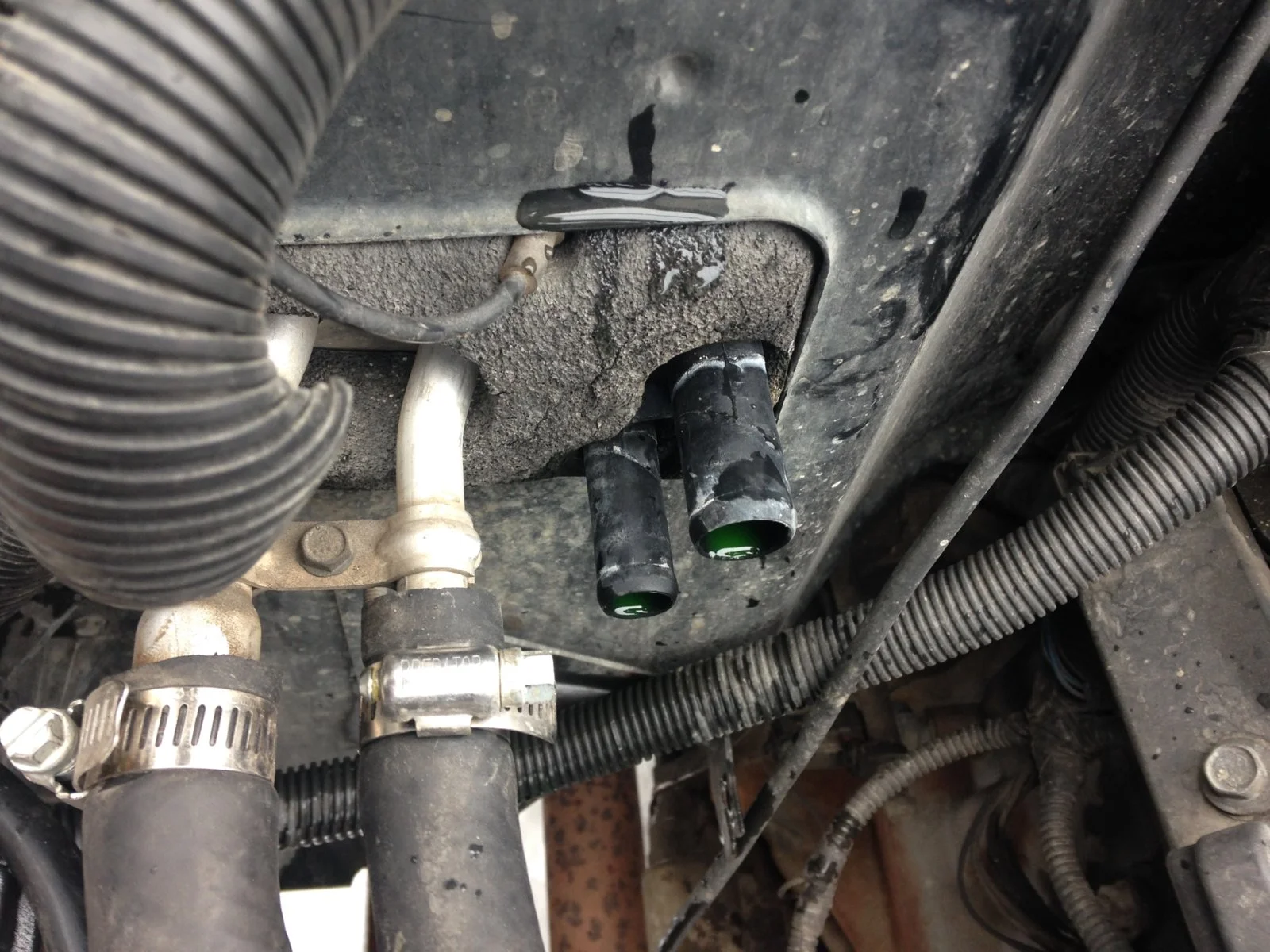

So last month I installed a new heater core. To keep driving, I switched the hose from the Heater Core to the AC Evaporator. There was a definite increase in the heater output, and after connecting the new heater core, the heat output definitely dropped so today I measured the air temperature colling thru the defroster.

30F degree difference !!
It is so hot off the AC you have to open a window.
And max output thru the AC is with the temperature dial set to cold.
But what a difference. Think I'll leave it this way till spring
76560

That's pretty funny. I guess if you don't need AC, then that's a solution. You will have to replace the evap if you want an efficient ac again as it's now contaminated.
Sent from my SAMSUNG-SM-G930A using Tapatalk
I remember you saying it was hotter through the AC, but I would never have guessed it would be 30 degrees hotter!
Are you going to use ball valves so you can turn the coolant flow down or off?
