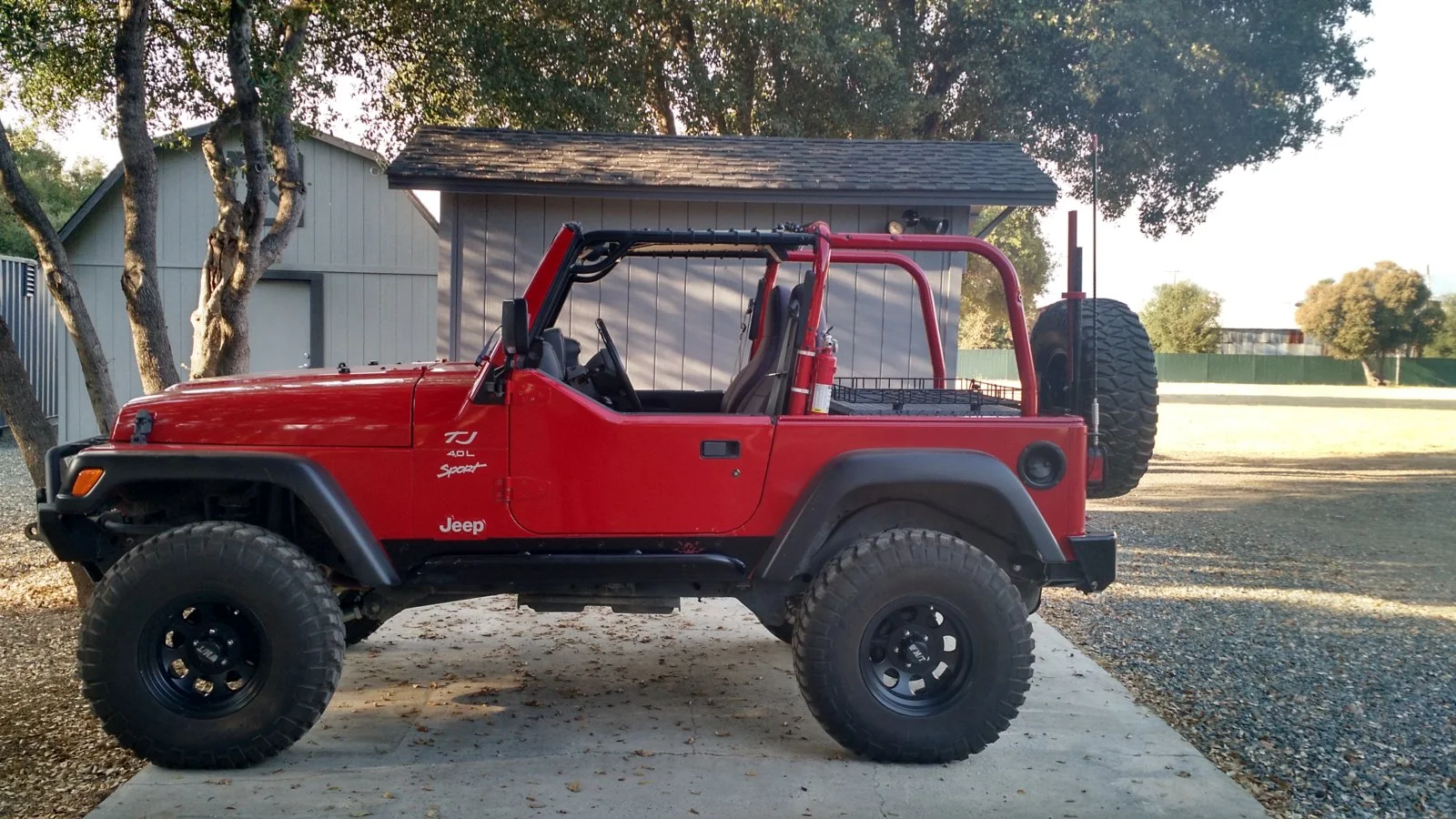

Here is a 3.5" lift on 33s. Just for comparison.
