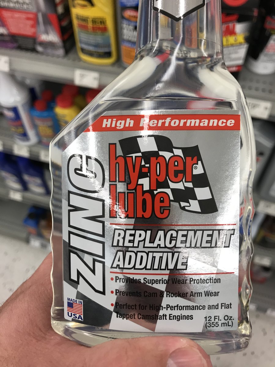

I’ve seen some people talking about adding zinc to the oil and how great that is for these flat tappet lifter engines, and how it really coats the engine surfaces well. What do you guys think about that? I know it may be bad for the cats, but it may be a worthwhile trade off to save an engine.
Or I found this other stuff that claims to be better than zinc and won’t harm the cats (even though it says zinc in the name, the back claims there is no zinc or other metals at all):
Millions of Jeep 4.0's run regular old oil with no issues. That being said, I have a big cam with high pressure springs, so I run high zddp oil (Valvoline vr1). It's inexpensive insurance anyways. I recommend high zddp oil instead of additive. If you are getting noise from that though, it's too late.

Hey thanks for the input on the ZDDP. I think I'm going to start using that as well from now on, just in case. As you said, seems like cheap insurance.

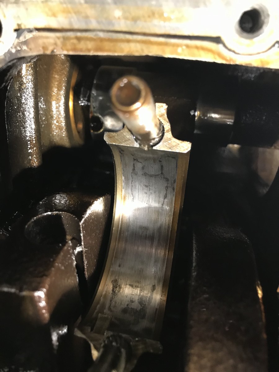

so here are a few photos of the top and bottom journals of cylinder 6 (5 looks exactly the same). They look pretty good to me with only slight discoloration. They were all super smooth and the crank journals were as smooth as could be. The weird part is that the bearings actually stuck to the journal when I removed the cap, instead of coming off with the cap itself. They definitely did not fit tight, per se, into the cap or the connecting rod. They just sort sat in them, instead of clicking into them like I expected them too. Also, lots of oil on both sides of the bearings. Aren’t the backs of the bearings supposed to be dry? And only the sides that touch the crank supposed to be oily? Or is that only during installation?
Top bearing, some streaking in the middle (very smooth) some discoloration at the end with the little notch in it:
Connecting rod inside:
bottom bearing:
I’m thinking things look ok. Thoughts?

I dunno about that first pic. Doesn't look great but hard to tell not in person. Streaks mean physical contact and there isn't supposed to be any. Not horrible though? That's certainly not where all the metal came from. How about the rod journal? The journal is the part of the crank the rod bearings and main bearings ride in. They would be the opposing surface to the bearings on the crank.

Hmm. Good point, streaks definitely would mean contact. Everything was super smooth with no gouges or ridges, though. Almost looked more like the varnish on the surface had worn away a little. Both of the upper journals looks this way.
I’m very happy to say that the rod journals looked great. They were super smooth with no apparent streaking or anything. I couldn’t find any scoring at all (thank goodness).
